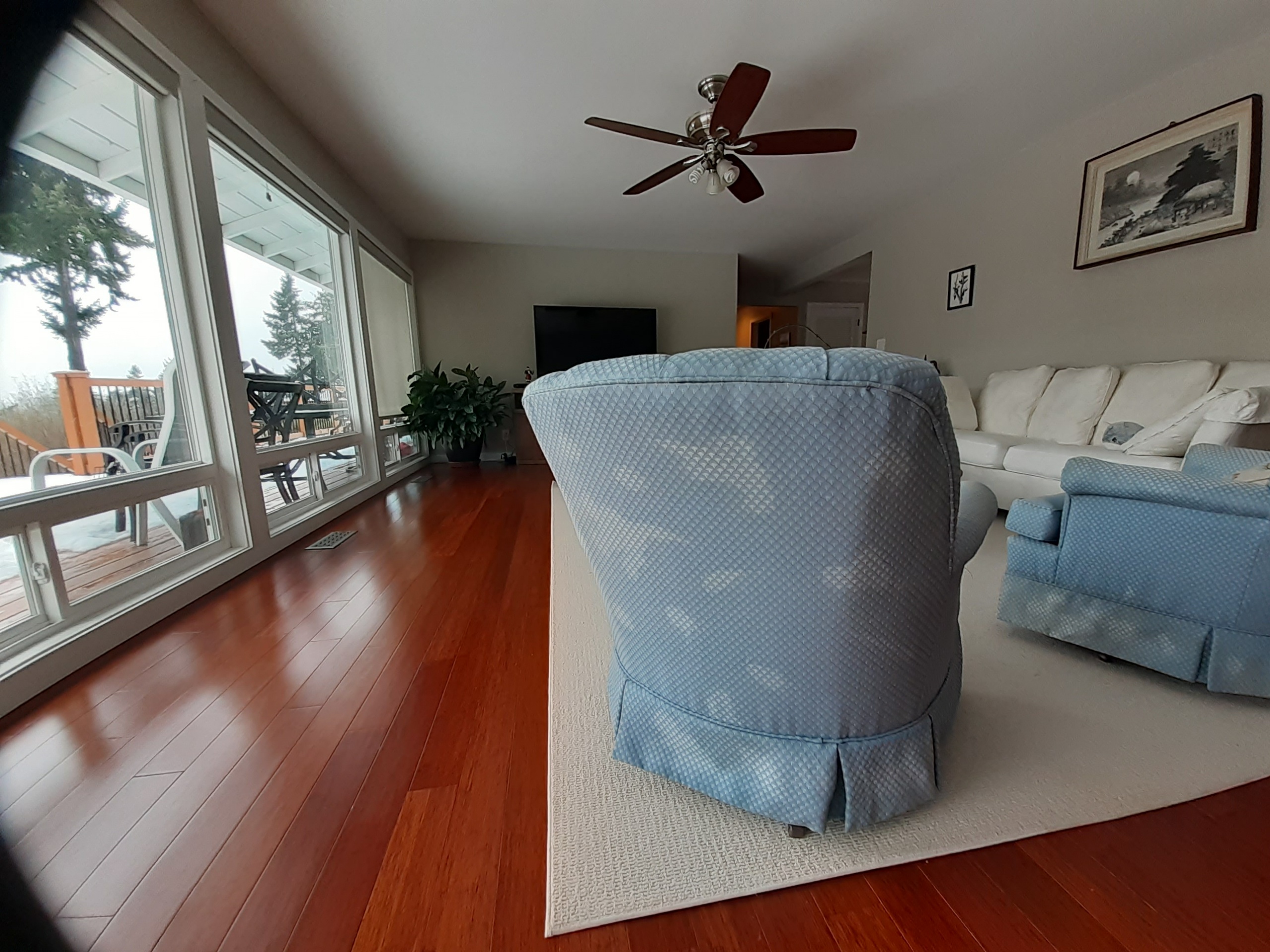

Strange chair discoloration

If it was me I would say I can fix but would need to take it back to the shop to fix it properly and then you will have the chance to try different things to fix it. Otherwise it will be a half dozen trips back and forth hoping you fixed it each time.
Reactions: Brian H
LCCFL
Jan 3, 2019
415
Apopka, FL
Eli Rodriguez
The other piece of upholstery to the right appears to have the same issue.
The spots seem random; was there any pre-existing issue that might contribute to this?
Was there something specific about the job that made you choose to apply the deodorizer (not looking to fault the deodorizer, but wondering what might have gone on before you got there....and what they might have applied to remedy the problem)
How old are the pieces?
How soiled was the upholstery?
Did you apply the prespray everywhere, or just on heavily soiled arms and cushions?
Did you apply the deodorizer with a trigger sprayer over the entire piece, or was it in the extraction solution?
Can you identify the fiber family? (natural vs. synthetic is good enough)
