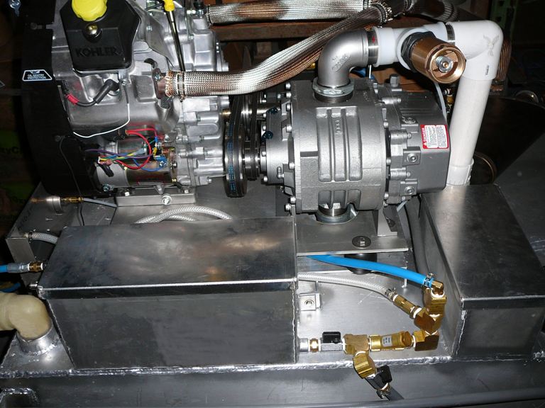

Here is a pic of the set up. We do not use the water box . We pull from the water tank (see gray hose that angels down) on bottom of pic) and comes into brass fitting

It looks like one of your shut off valve is closed.!? maybe you closed if before you began working on the TM?-- I've made this mistake many times.
Dan noticed that earlier....I assume he checked and flipped the waterbox off and the tank line back on
I thought this was aleady fixed based on the post a few weeks ago

That was a stock photo of the machine from Cobb I posted to show the lay out
If that was all that was wrong is the shut off valve was turned and they didn't catch it when I drove 6 hours to Nashville to get it looked at I would have been a little upset that they didn't figure it that out.!
