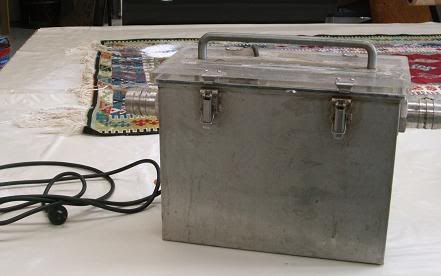

Try an in-line autodump - you won't regret it.

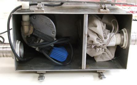

You don't have to move your HWE machine and enjoy longer vac hose runs. Here is what we make up
Here is the internals

We used stainless steel as much as possible - body,handle,pump,fasteners,and inlet-outlet. On later ones I did change to a plastic cuff that I could get off the shelf as the stainless ones had to be machined. The lid is a poly-carbonate so Mrs P can see all that dirty ceerap coming out of her carpet. The cloth bag goes over a larger meshed filter.
Because we can put the unit as close to the wand as we want it enables us to do very long hose runs as the HWE is only pulling air back. Other benefit is the vac motors run drier - and hence last longer.
roro
This is towards the end of a regular job at one of our largest sites - well over 200 feet of vac hose but as all the experts know - you can't do that with a porty. Yeah right. :wink:
