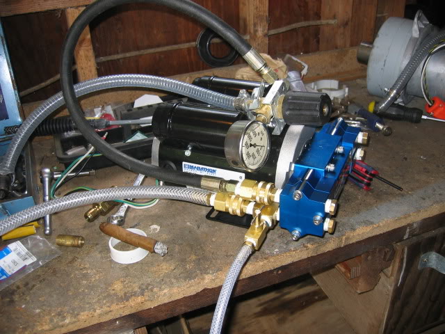

don't get me wrong here i have put together quite a few pumpteks for my customers
the big problem with them is you have to take the head off and grease the Bearing every now and then
what will also happen is a seal will start to leak and dry the Bering out. When that Bearing wants to take
a shit it does it at light speed and takes the whole motor and sometimes the pump head with it.
If you start to blow breakers when your machine has not had any problems in the past it could be a sign
that Bearing is starting to go bad.

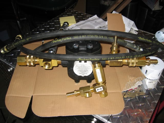

this here is a 205 I put together for a customer notice all the quick connects for easy pump head removal

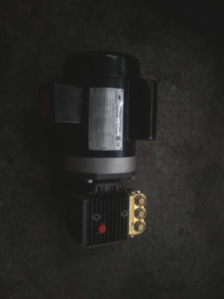

I've got this shiny new General sitting around. The idea was to build a component machine around it. It will have 2 sets of two stage vacs, but 3 cords. I don't know the viking vacuum magic yet. :wink:
