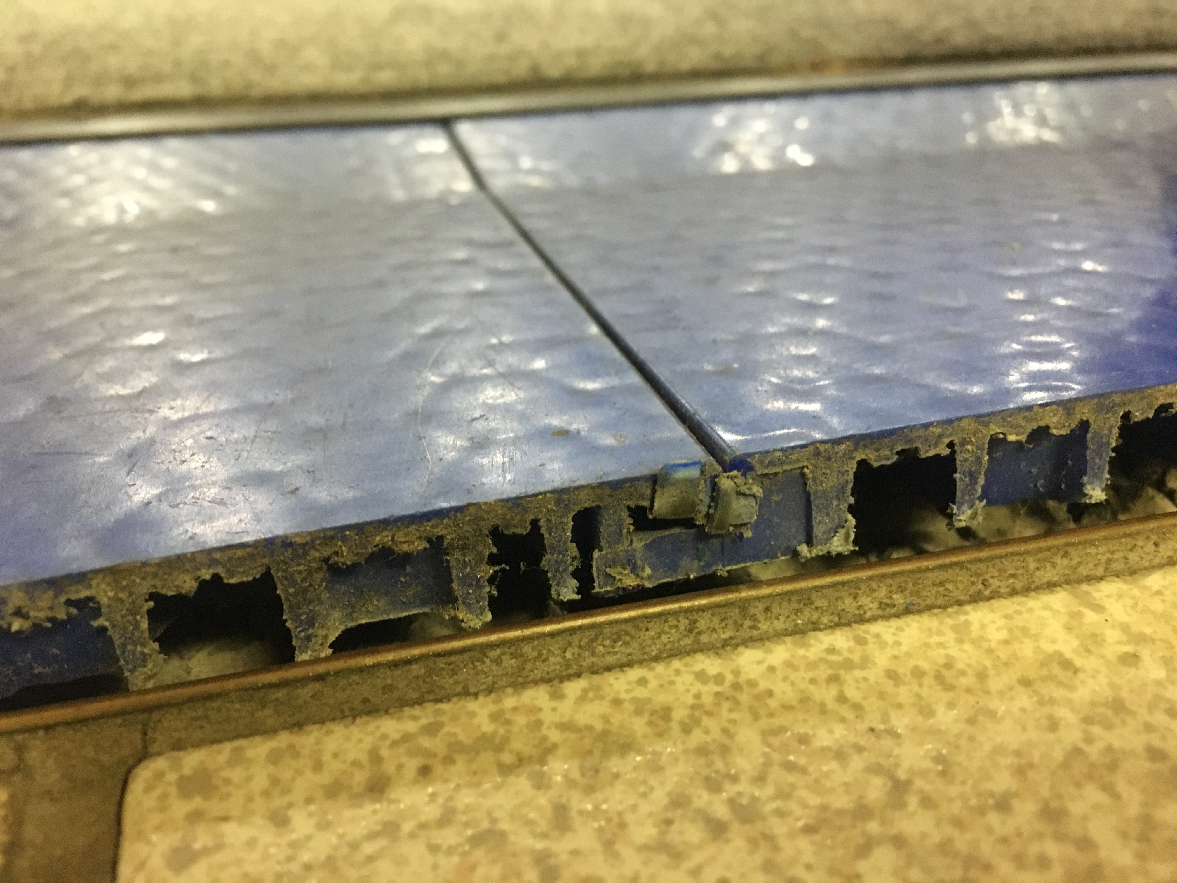

Should squirt and suck or spray and buff?

I wasn't sure if any of you guys ran into this kind of gym floor before

175 with a tank if you have that. If not, sling it around like stripping vct. The 175 would be the ticket. Damon’s right, start light such as red pad. Might do it, if if not move to blue or green.

If you’re gonna keep getting these, you might need to invest in a used auto-scrubber. A 20” Nobels or Tenant can be had for 15-2k. Throw it in your trailer.🤷🏼‍♂️
