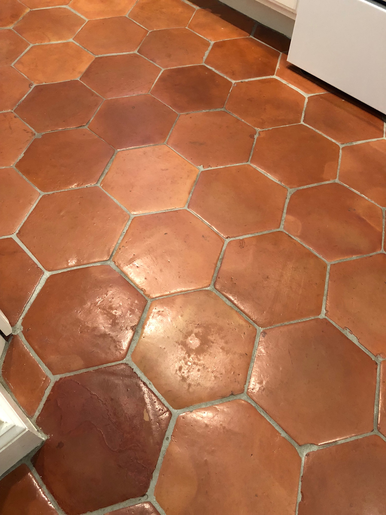

Clean with a nuetral, crb, 500 psi, warm fresh rinse.
Re coat if needed.
Do not attempt to strip

Saltillo is extremely time consuming to strip. I charge $10 a foot to do so.
Heat, high pressure and high alkalinity will effect the "factory finish" on it very easily.
Dont try and be a hero on this one.
Oh I never had any intention of trying to strip this. I plan on telling the customer I can clean and coat with some Betco hard as nails and that's it. If they insist on it being stripped, I'll walk and let someone else deal with that nightmare.

do you pre-qualify the custy that any dinge/crud in/on the grout UNDER the old finish(that stuff happens) will still look like rotting worm guts..only a little shinier?
Yes. I explained to the customer that I would only be able to clean the dirt off of the surface, that anything under previous coatings would still be there. He just wants the floor shiny? Said he had someone look at it before he was referred to me and they told him that they could clean it but that you couldn't put any kind of sealer on that tile.

The REAL PROBLEM IS even at 10 dollars a foot you won’t make any money if the Job is too small.
Then if it a real nightmare ( like some or most I see really are) then it is just take a mental and physical toll trying to get evenly down to the tile.
It does look nice when completely stripped and recoated with 8 coats but most look back and wonder why they started the job in the first place.
It only took me 1 job to know not to do it again and I have family the have it in their home and I tell them good luck finding someone who will do it right.

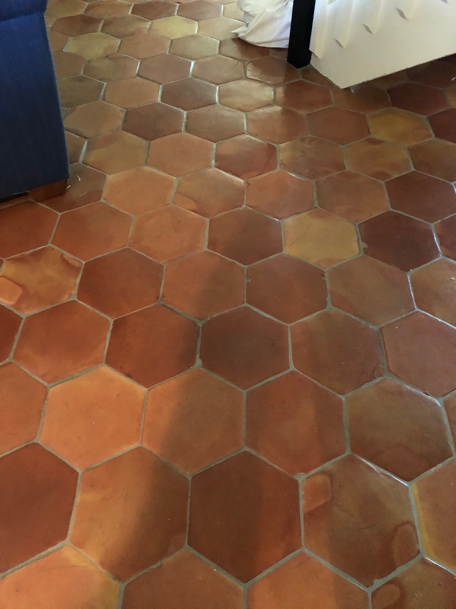

The floor in these pics doesn’t look bad at all.
As I don’t see any buildup, cracking or staffing of the existing finish or too much discoloration overall.
