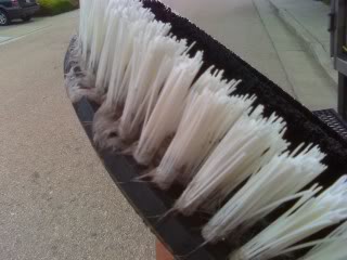

Brushes sure dig it out don't they?
Fiddy may not no squat about customer retention or profit margins but he was right about a brush digging deep.
Is there an easy way to get that hair out with out ruining the bristles?

Get a wire brush with the long handle at any hardware store.

Run some nails through a 1x4 piece of wood. Flip machine on back, have helper or Paula turn machine on. Put board with nail on brush and watch the crap fly off.

Mikey;
We have the red ones referenced above.
But to get down to the lint you pictured...,
the wood device with the nails will do a better job.

One of these:
http://www.adcoprocleaning.com/product. ... t=0&page=1
We use them for carding brushes, horse hair, brushes like you have there too.
Mikey P said:
I don't deal with them, anyone else sell those?
I have one but like, most of the audience here, it's missing lots of teeth.
That is just a combination paint brush comb and roller scraper. The are available at most paint supply houses or hardware stores. Just google Paintbrush Comb
