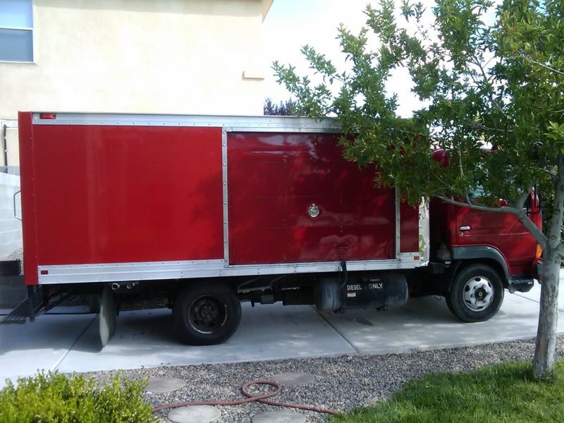

Flew to denver last week on 12 hour notice for a smoking deal on this 1999 Vortex 777. It has 105k miles and 5k hours. Everything works including A/C. The seller was asking 11k but dropped his price to 8k cash. So, i hopped the first jet to denver and drove her home with title in hand.
The trip back to albuquerque took much longer than expected because the two passanger rear tires were completely bald. Got about 200 miles out of Denver before the inside rear finaly blew. Had to nurse her all the way back to Pueblo at 30 mph hazards flashing. To make a long story short i was up for two days before finally got home.
I figure a deal like this is worth losing a couple nights sleep over so no biggie.

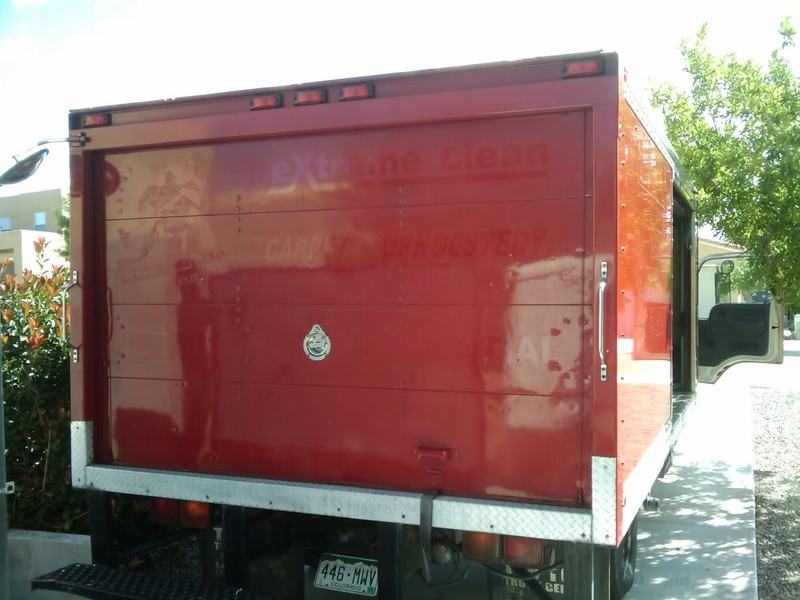

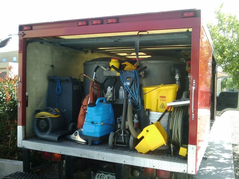

Should be easy to buff out the "Extreme Clean" lettering, or are you going to paint it?

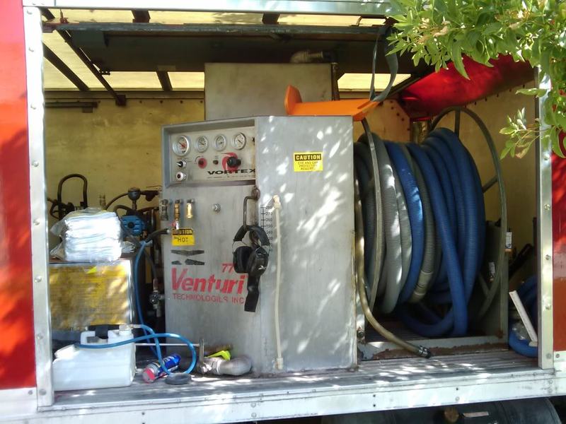

Royal Commercial vacs are the best. What's the mop ringer for?
G
unbolt your vac hose reel and slide it bacl as far as possible and you can utilize an extra 4 x 4 space .

my only bitch would be that there's really no dedicated chem storage on the 777. Especially with the roll up doors.

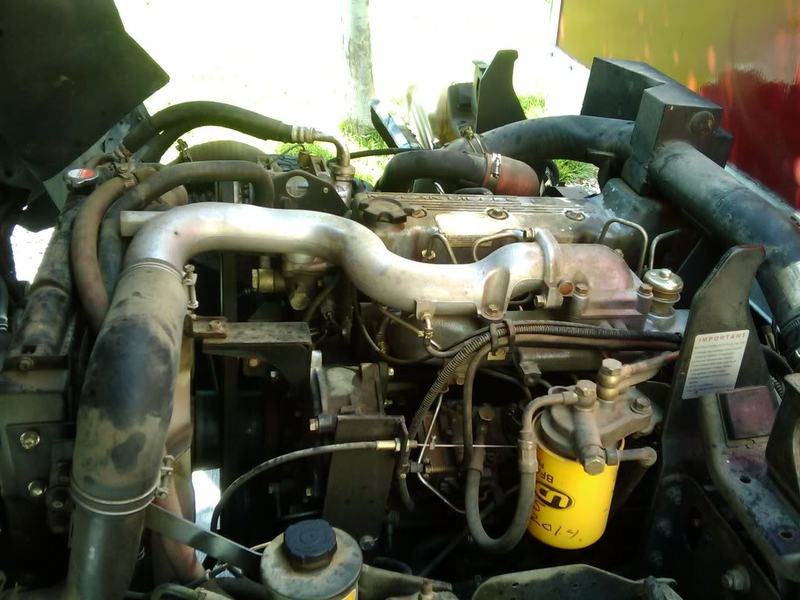

One problem that materialized the first day was the RPM fluctuated about 1000 rpm. It kept bouncing between 1500 and 1600 rpm. My mobile truckmount mechanic followed me to the first job site with this truck, it was raining cats and dogs. he said the belts were wet from splashing through puddles (makes sense). he held the vac relief open until the belts dried and everything worked perfect again. The mechanic noticed that half the teeth are missing off one of the 3 main belts so he ordered all new.
Everything works properly but Saturday on my 3rd job the rpm's started fluctuating again and it was dry as a bone outside. The only way i could get the rpm's to stablize was to power off/on the system and everything worked great the rest of the day. The belt with the missing teeth looks a little sloppy and flapping around a bit.
Keeping my fingers crossed its just belts. (probably the reason why the guy sold it so cheap). It sounds terrible when the RPMs drop. Almost like it goes into a stall then rev's back up again every couple seconds.
Anyone seen this problem before? (Thought there was a thread "Vortex RPM's up and down" but can't find it now using search).
Thanks for the suggestions. Storage is a hassle cuz you have to walk aroung the machine to get to the wastes space behind the hose reel. Moving the reels back is a great idea!
the mop ringer was for a laminant floor job i did last night. Forgot to pull them out this morning before snapping pics.

If your belts are loose and you can't adjust the tension any further then they are either the wrong belts or they have stretched out and need replaced.......how bad are they vibrating....
Power surge could be because belts are slipping....the screen at the solenoid for the PTO is plugging up....relief valve spring may be getting weak... Or it could be in the UD itself...gas filter needs changing...may be time for a good service...air filter on these things gets to dirty and it is having trouble breathing...could have a dirty injector.....just a few things off the top of my head....you can listen to it and determine if it is the truck or the machine....

Once your belts have slipped (most likely, because you'll notice that the grease from the blower falls right on the lower pulley when it purges) you're fooked. The glaze that gets created while slipping never goes away.
Thread some hoses into your oil purge valves and have them drip into a cup or zip lock bag and replace those belts.
DO NOT over tighten the adjustment pulley unless you want to put new bearing in the 6008
