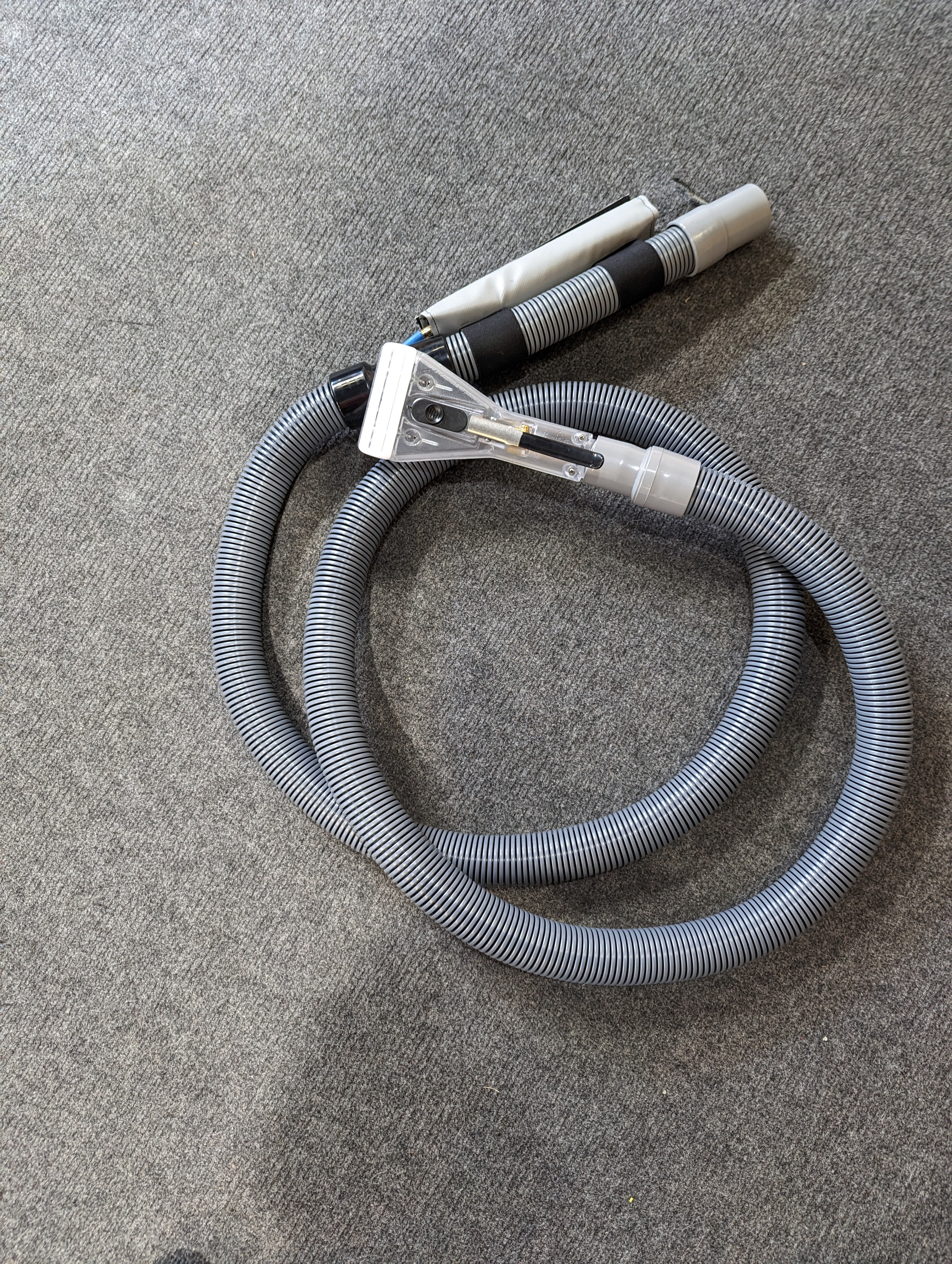

Just received my new Sapphire Upholstery Pro today. So easy to use compared to the Rotovac Shear-dry. Liking the clear head. Actually looking forward to my next upholstery job. Always fun to play with new tools.

The hose length sucks. I changed mine out to 18’. The hide-A-hose solution line sucks aswell… changed mine out to a stainless steel braided…
I also added shrink tubing to any and all connections inside it. The needle valve has a mind of it’s own… don’t expect to set and forget.
The vinyl wrap on the needle valve is useless…
I had a new one made up….
Other than that, I love the tool now, and it’s a money maker for me!
115,887
