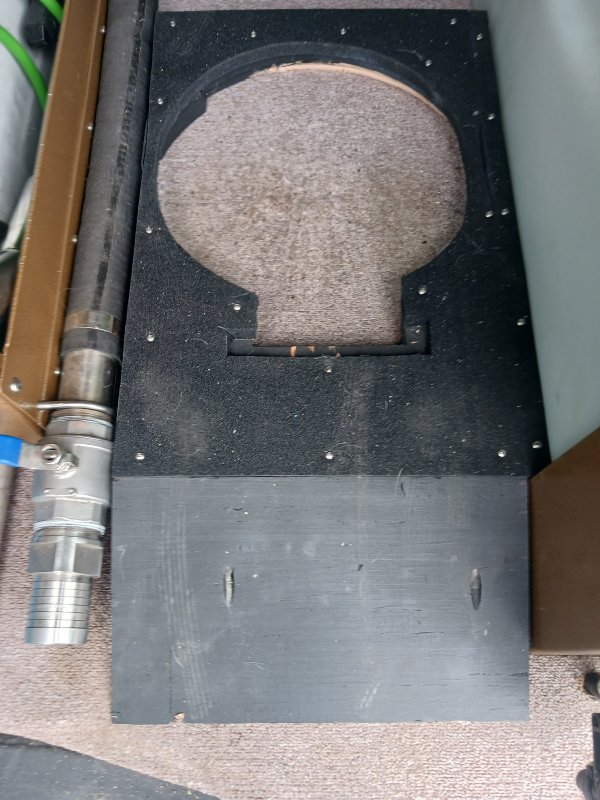

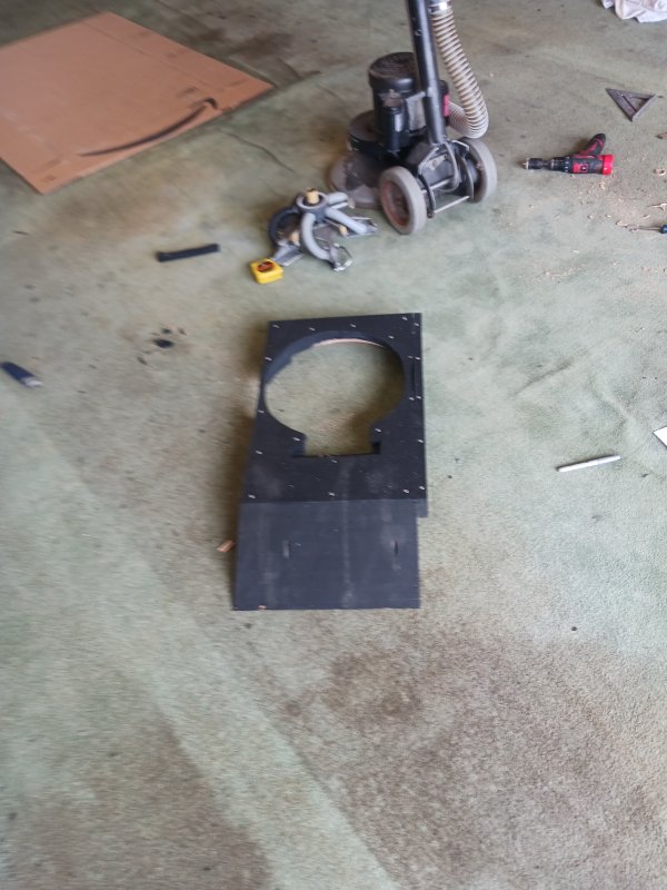

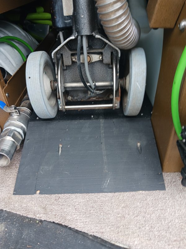

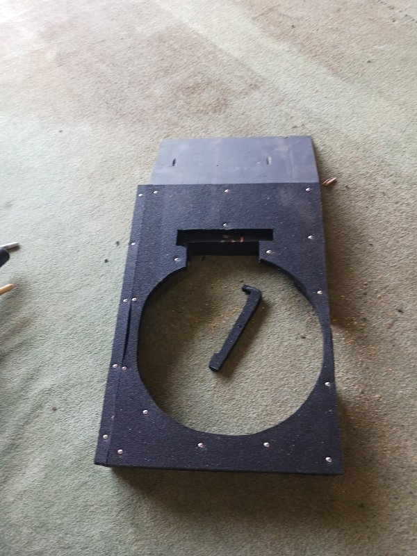

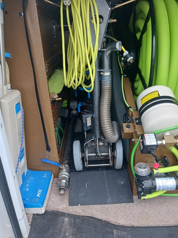

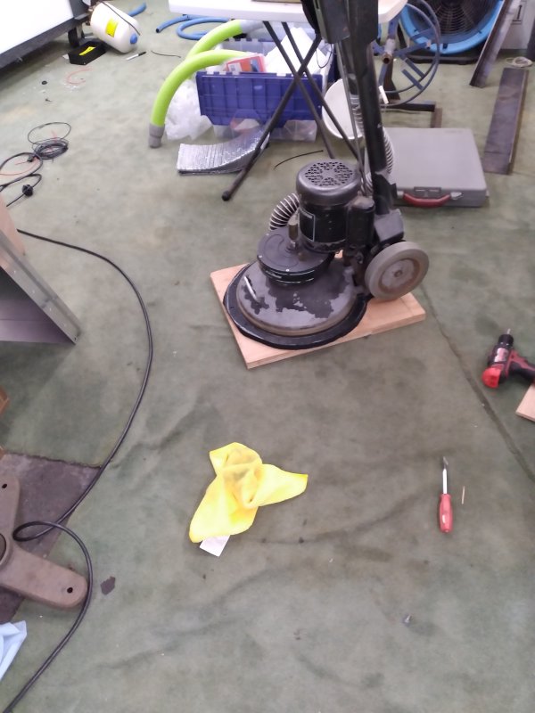

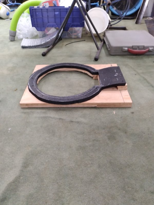

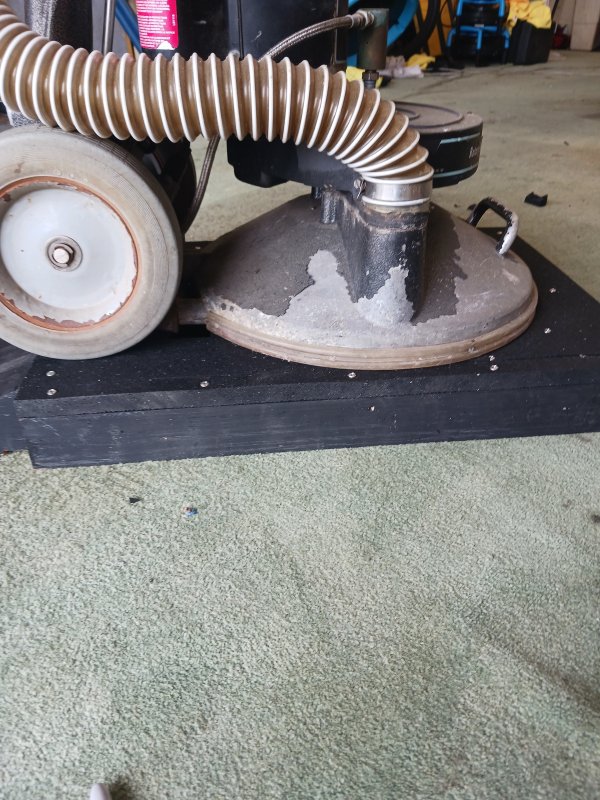

A few years ago i posted about a storage system i came up with for storing my rx20 in the van easily without removing the star. I took my proof of concept to a friend/ customer who's hobby is making furniture in his well equipped garage. And for 2 livingroom carpet cleanings this is what i got back . It sets in the back of my van, locks its self in but can be simply lifted out when necessary only changes since the pictures below is i used monel staples to install a piece of office no slip chair mat to the bottom so as th keep the vans carpet under it clean and dry. It even has a built in ramp to roll it up/in and out . On straps or bungees just roll it up drop the star in the hole and drive away. Been in use fot over a year now on mountain roads and occasional emergency braking for idiots and deer
