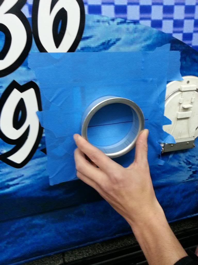

I'm installing my new pro-1200 in a van with a sliding door and have some concern.
I always run with locked doors. In my previous van, always a CDS and I put a trap door in floor which worked great. Due to the way the Pro-1200 is designed it will be harder to do.
  1. Therefore if I put a whole in sliding door, it will be only about 1 to 2 feet from connection, will that create a problem with opening or closing door (which we'll have to do) while hose is hooked up? Seems to me like it will put some stress on connection.
  2. Will area of hole eventually rust?
  3. Any other potential issues?
Any other Pro-1200 owners here?

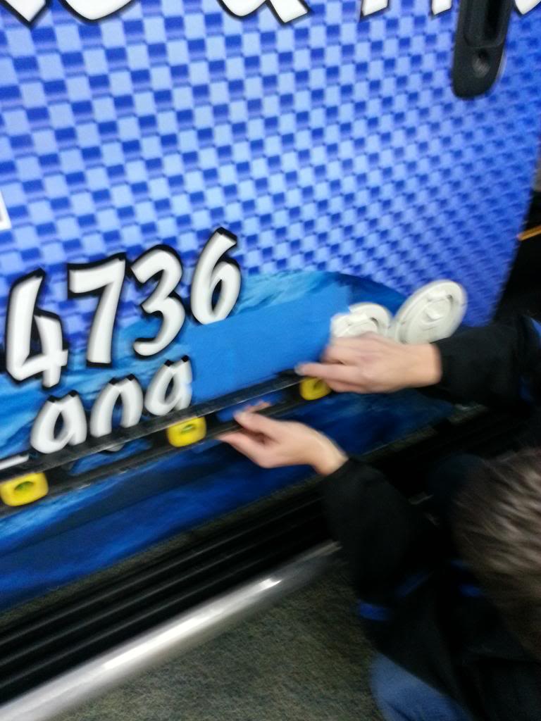

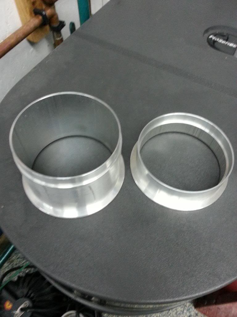

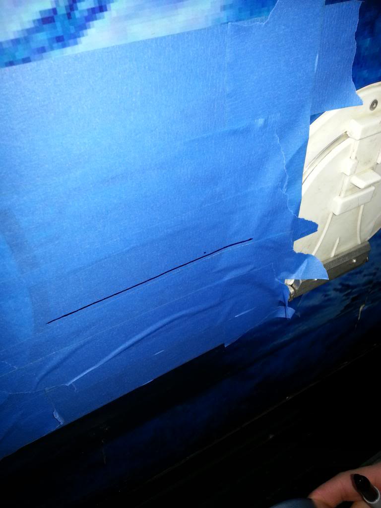

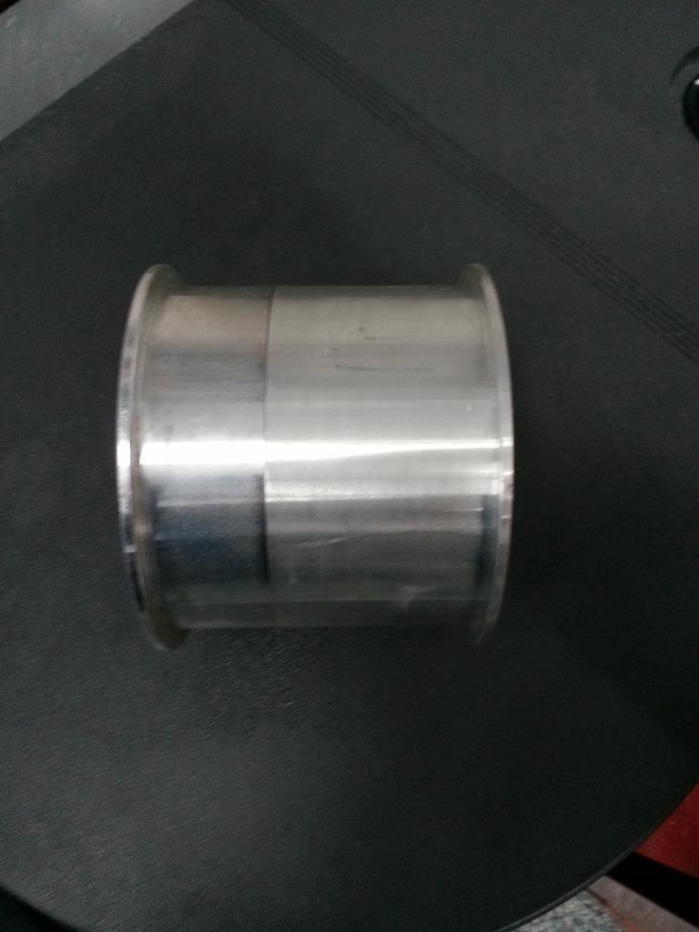

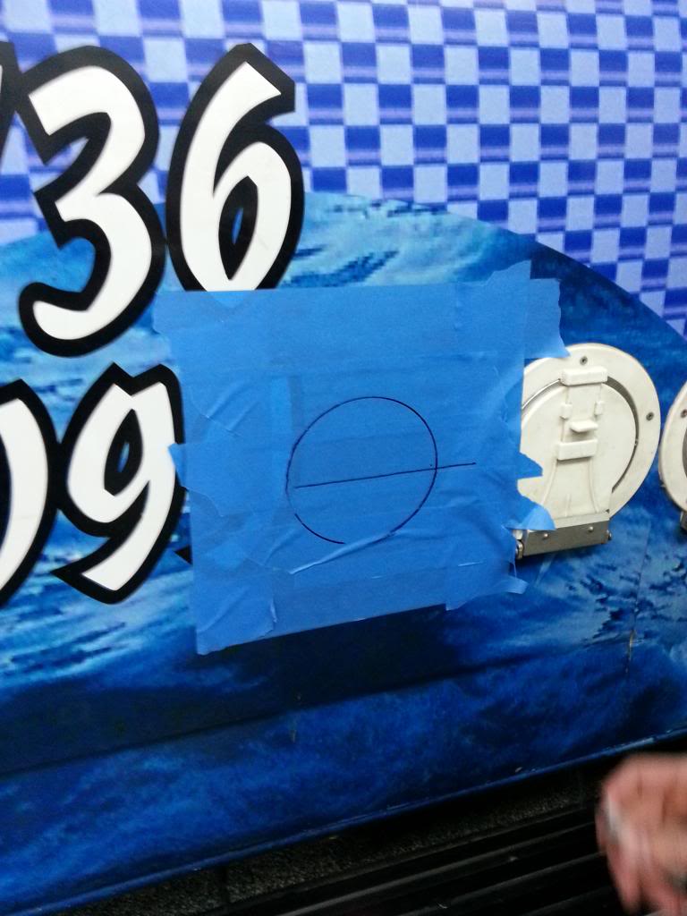

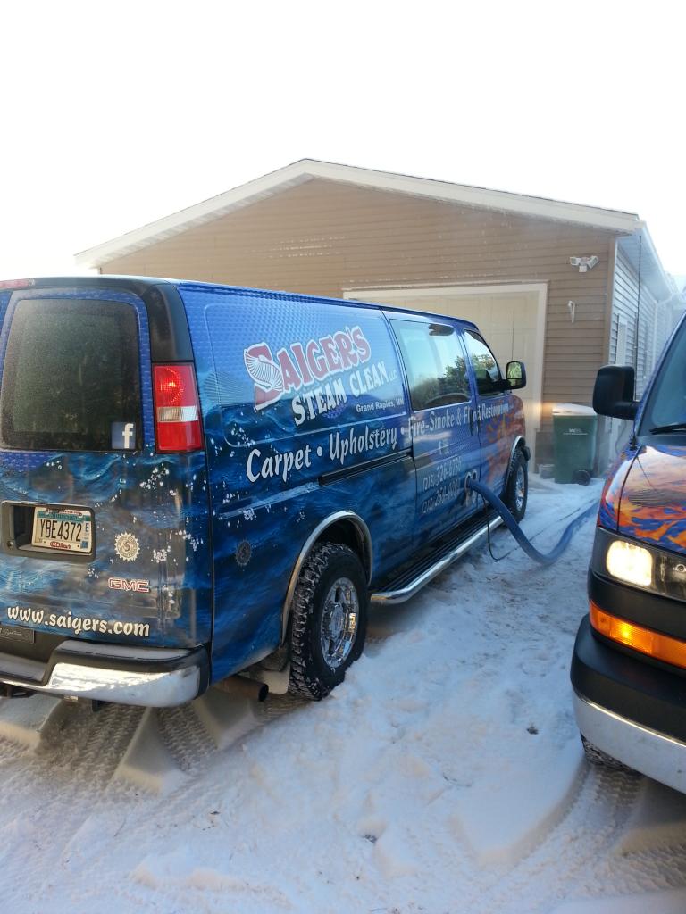

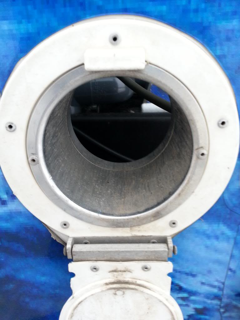

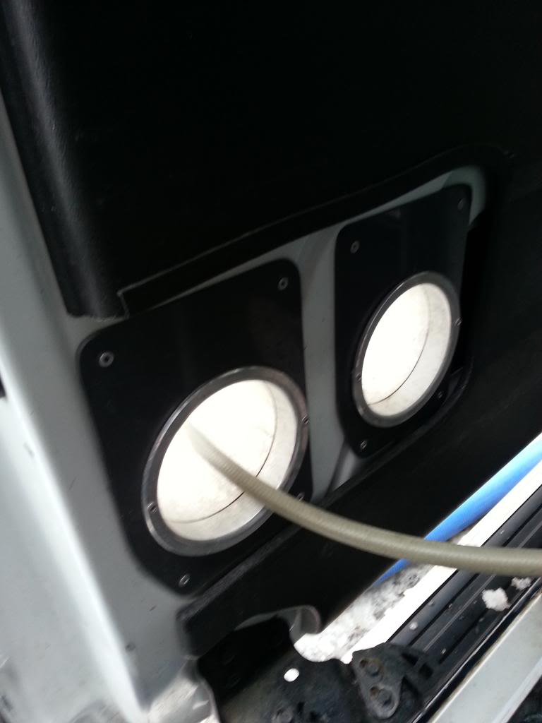

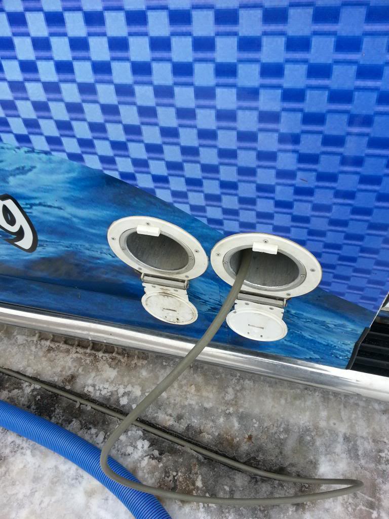

I thought my response was targeting the heart of your question. If you put the pork hole immediately opposite to the hose reel, you can't open the door. If you put it at the other end of the door, the slack created allows you to open the door and not create stress on it.

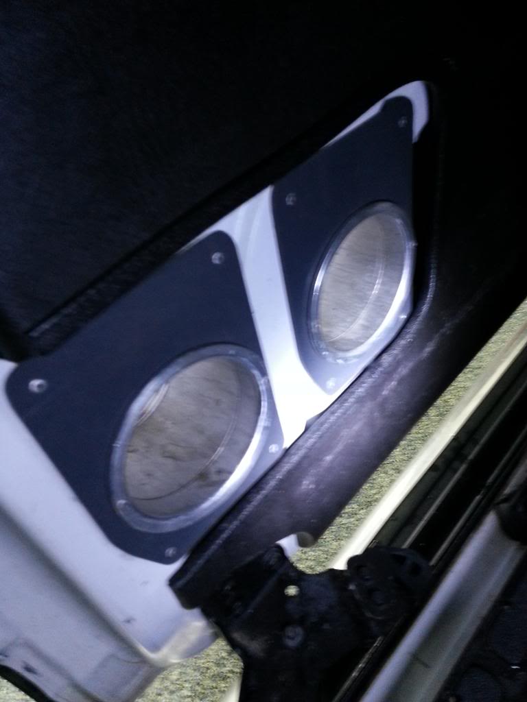

  • Mark, that is very neat and thanks for the pictures. Is opening or closing while hose in create any issue? What's the distance from door to where hookup is?

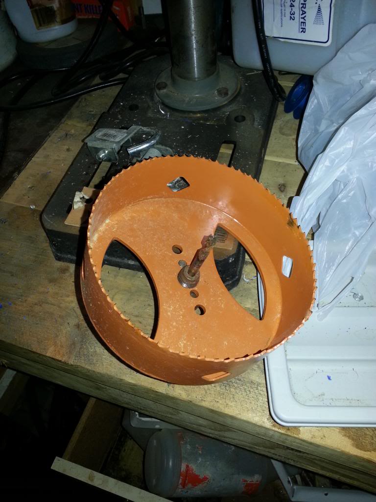

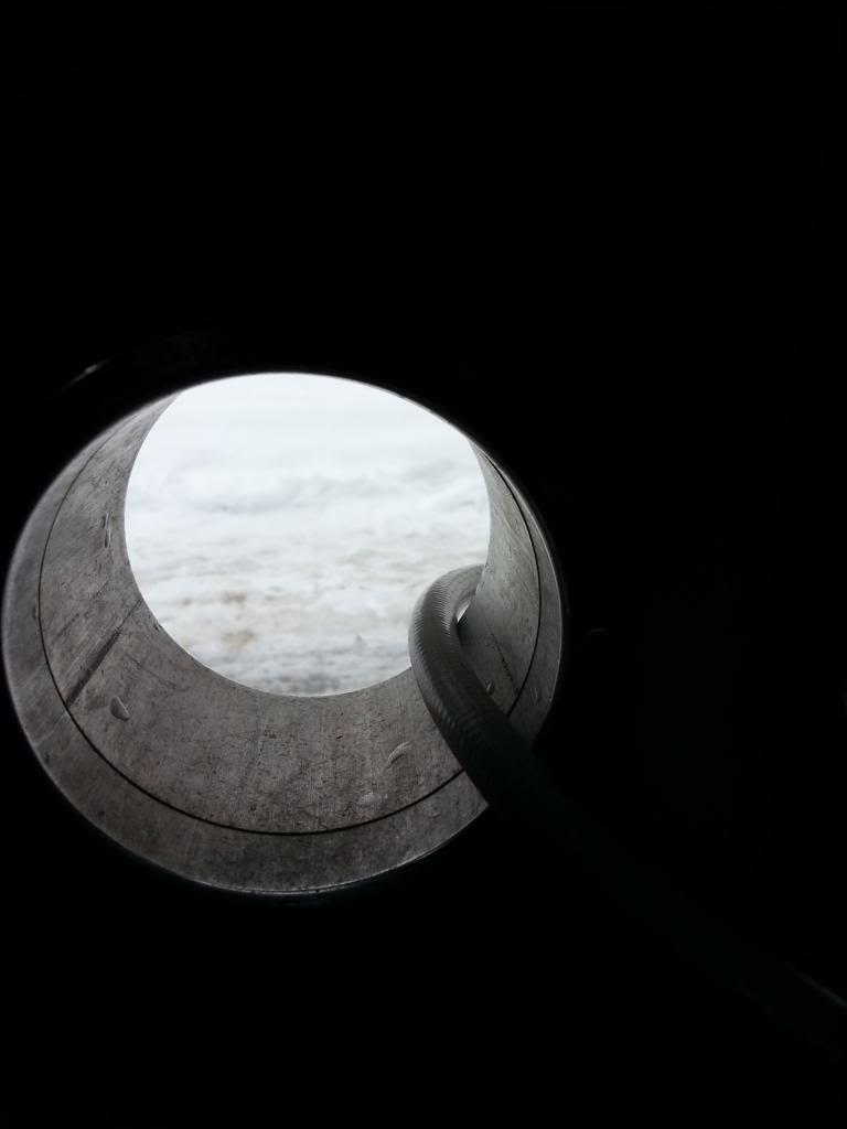

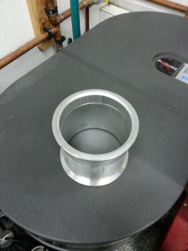

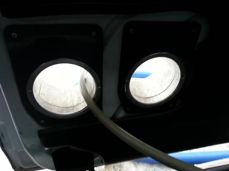

Hopefully you just got a chance to see the videos posted (while you were both posting your threads)
The videos will maybe help with all the ideas mentioned.

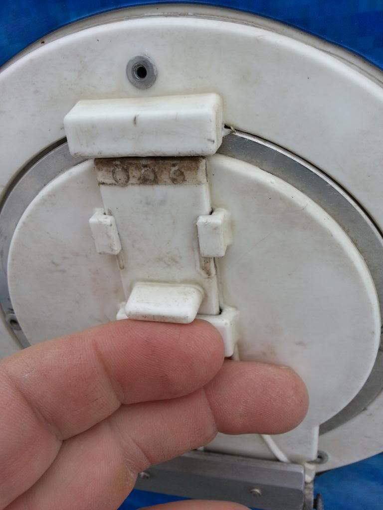

Go to the Auto parts store and getcha one of those custom chrome gas lids.

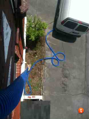

I run out the back of our rig, through the floorboard. Behind drivers rear tire.
Love being able to lock the doors at times!

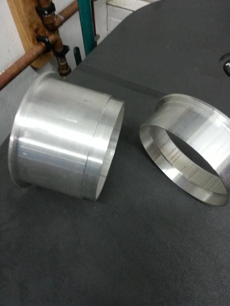

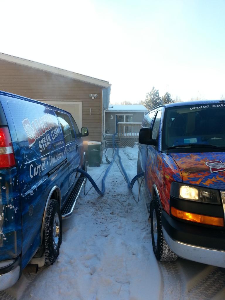

Since you don't have to worry about freezing why not just mount a manifold outside the vehicle beneath the door. Run the plumbing down through the floor and to the manifold.
That way you don't even have to screw with cutting on the door.
