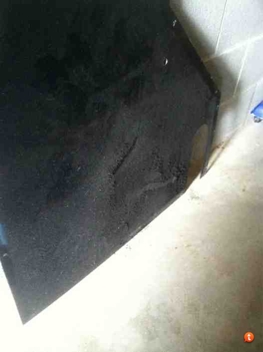

Thats belt shards built up

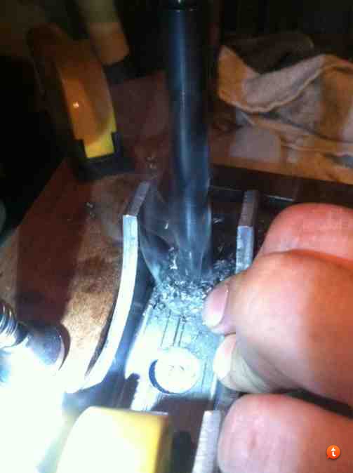

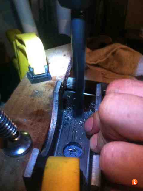

Building a better bracket than the factory muffler clamps, lol
Fab is fun : ) just not when ya least expect it
