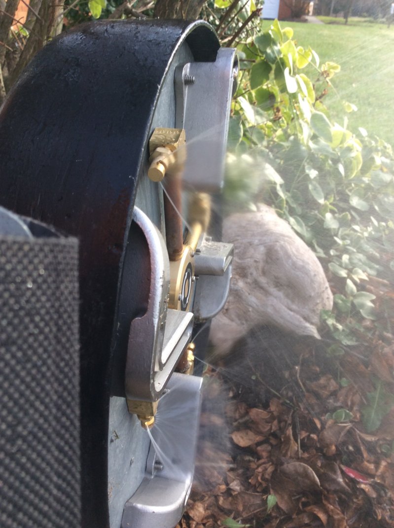

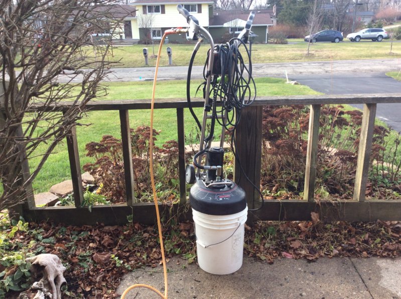

Kellie, the dual 3 stage CFX works perfect with the 360i; they were designed to work together. I use mine interchangeably with my Pro1200 throughout the day, some jobs the TM, some jobs the porty. This is what the business side of the 360i looks like hooked to custy faucet with a standard 100' Parflex TM hose:
I bucket tested this and a 5 gal pail was filled in about 6 minutes, which is plenty of flow.
Try it yourself; just hook your 360i to a faucet and run the vacuum from your TM and see if this is going to work for you. The CFX produces 230 CFM vacuum, as good as any dual 3 stage produces, at 40 pounds.

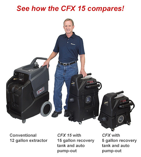

Make sure you get the right CFX.
I would dearly love the newer CFX 15, even though it is going to be much higher on my old 27 gallon docking station, which I rarely need to use.

I prefer the 5 gallon CFX. Put 10 gallons of water in a 15 and then try dumping it. Look at where the dump valve is located, it has to be lifted in order to dump and I doubt anyone would want to be in that position at a customer's even second floor apartment where there's no elevator. Even rolling the 15 around with water in it is not an easy task due to how low the body profile is to the floor.
In either case you're going to need to use the auto pump out which negates the need for the 15 gallon capacity. The 5 gallon unit is much more manageable and easier to carry around.

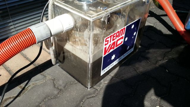

Unfortunately, sometimes the auto pump out fails, and if that happens with the 15 gallon you've got no choice except to figure out a way to lift the beast and empty it. The 5 gal unit doesn't have a dump valve but it's easier to lift in order to empty it if the pump fails. The pumps do and will fail.
Whilst I don't have the 15 gallon CFX, I see that it does have a waste outlet down low as some have commented on.
Rather than try & lift it, why not simply hook up a vac; hose and drain it to an outside point??
Down under, in some states, it's still legal to empty the water to the lawn or garden bed as long as it does not go into any drain that goes to a creek, etc;
Other option would be to place a machine similar to a Flood Hog?? before the CFX.
I use an Aussie made Gulpa, basically a heavy duty submersible pump enclosed in a perspex box, which pumps out on auto.
Just a thought.

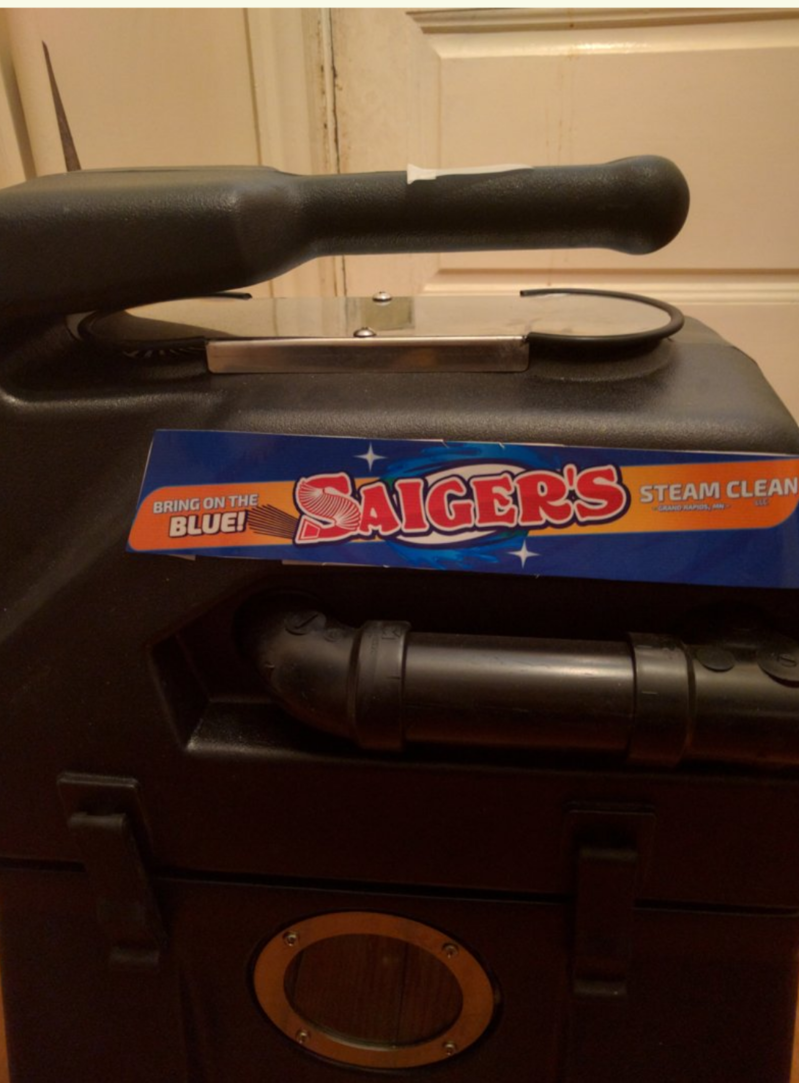

Make sure your discharge line fittings are absolutely tight or the pump-out won't function properly. I had the same issues as mentioned above until i installed a 45 elbow right at the machine and torqued it tight. I threw the supplied drain hose out and bought the HoseX. Much easier to wrap and carry and you dont see the gross discoloring of the clear plastic drain-hose. I also drilled and installed a cheapo 1/4" ball valve at the bottom front of the waste tank to better drain the unit.
I found that if there is any air leakage in the drain system, the pump cannot do it's job. You can do a search of my other comments on the CFX in other like-topic threads.

question wont a 5 gal. bucket fit under it to drain?
Not unless the CFX is on the docking station. See post #12 and note where the dump valve is located. The 15 gallon model is the larger one that the person's left hand is on (unless, of course, it's a mirror image which would mean that it's actually the person's right hand on the unit).
11,297
I see it way down at the bottom I was looking at the vac inlet at first. Ya that's almost impossible with out a pump out.
