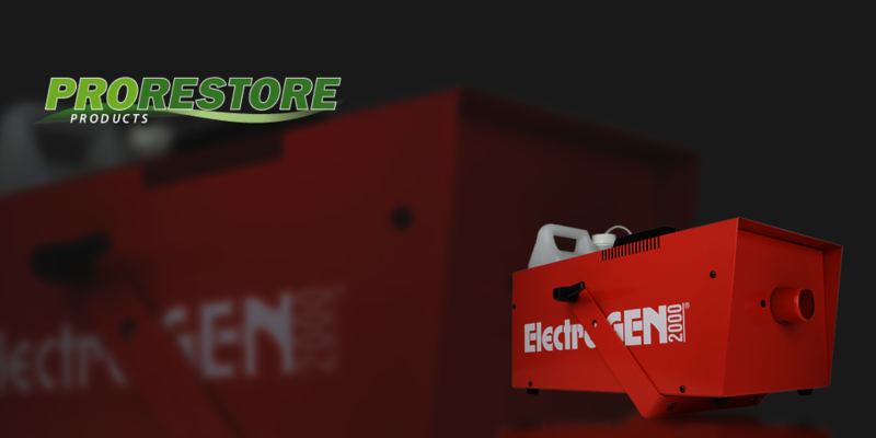

I like the Electrogen much more for fogging Thermo 2000 (water base) it does a nice job of delivering a nearly dry fog.
