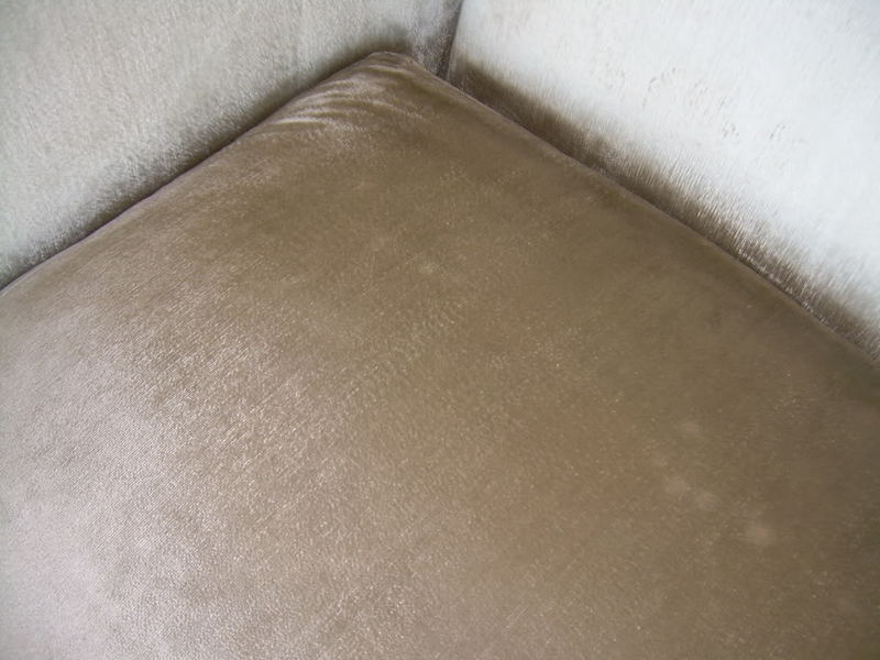

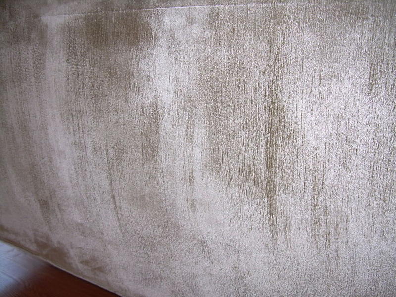

Removing tool marks from velvet
Terry
May 18, 2007
574
Wrentham, MA
Terry O'Brien
upholstery cleaning marks (pattern of upholstery tool)
I've pictures and am going to upload if possible
Thanks,
Terry

Re: Will a steamer and velvet or carding brush get the
Yes, if fabric is still damp when brushing. If this is a problem you are trying to correct, wet it down first.
I cleaned a dralene fabric years ago, 1992, it looks very much like a cheap synthetic velvet. The pressure from the Kleenrite uph tool, 100psi with a Ninja, was enough to blast/distort the weave. There was no brushing it out even when re-wet.
At least that was what I was told at the time by the more "experienced" cleaner that came to examine it. Never had it happen since.
The real key is not so much the carding action...
But to go three ways fully in all directions then follow through with the grain...
This way all fibers are on the same sheet in regards to proper directional lay iof nap when dry...
Mist litely ,but uniformly,force dry also...
I have witnessed too many instructors doing it or explaining it poorly .In regards to carding ,it is a art unto itself...
An upholstery class teaches to always brush out and leave no marks.
Big difference in approach if its cotton/rayon or a synthetic like acrylic.
Acrylics can usually be done with an extractor and brush.
The naturals need to be lofted and I use a gloved hand rather than a brush of any sort.
If all else fails use a hand held steamer with a clean white towel over the head.
spent 51/2 hours yesterday with steamer and carding brush and bare hand in the edges. Its a 6,ooo dollar couch and customer was pleased with outcome but wanted to wait till today for final outcome, even though it was dry when leaving.
The velvet brush was too course, carding brush ok but had to be lighthanded.
Any of you know where a narrow version of the carding brush can be got, something of the style of the velvet brush but with the softer thinner bristles. Getting in the corners and edges.
One thing i've learned from this is not having all your brushes in van at all times is costly.
Lee, you mentioned gloved hand, do you mean Latex or an another type?
