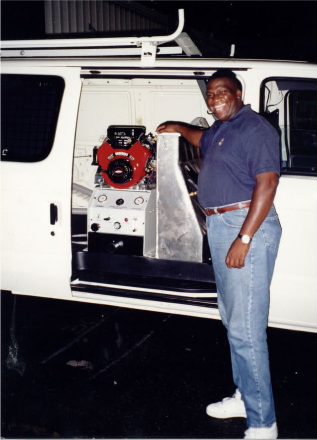

Oh...
And here's the proud original owner of that 1998 Hammer then...
And now, with the new version of it...
What a difference 11 years makes... 8)

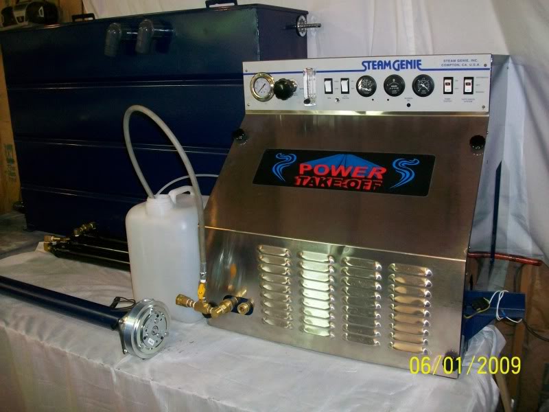

Duane, the mufflers look awful close to the vans floor and could cause heat damage.
Bawb that 454 650 hp is overkill for dat SteamGenie. See ya in Vegas

44,390
Ron sez:
"Bob, your blower elbow looks a little restrictive. Nice weld, but too sharp."
you'll havta blame Steam Genie R & D....that's EXACTLY how they built them....and no it poses NO restriction at all......it's Stainless and required a TIG weld!
