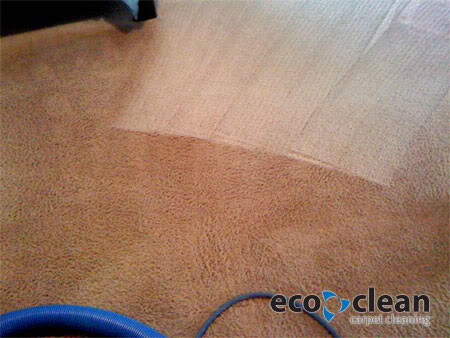

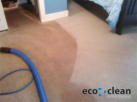

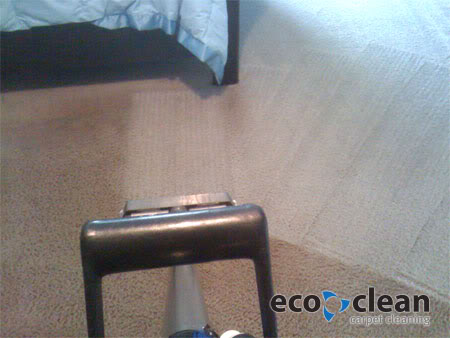

Snapped these pics with my phone.
I guess they left a little residue on the carpet. They were very surprised. So was I. Wish I had had the camera or at least a little better lighting.

Not to sound negative or anything but...with the pictures it looks to me that you just laid the nap down. I did a carpet about like that yesterday and if I left the nap down it was almost white but when I groomed it back up it was it's nice poop brown color. Just my two cents. But I would have loved to see a wand stroke going the other way, then there would be no doubts.
But no matter I am sure you cleaned it well! :D

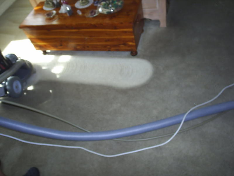

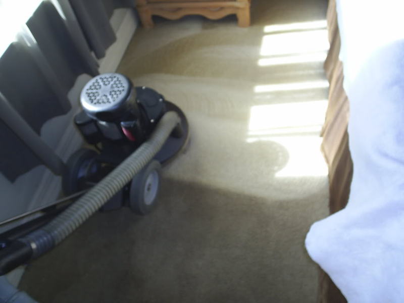

The carpet gets soiled evenly .....because of the chemical residue left behind....
NO OFFENCE ....Peter but this is a former Chem-Dry custy...The residue was terrible.. :oops:

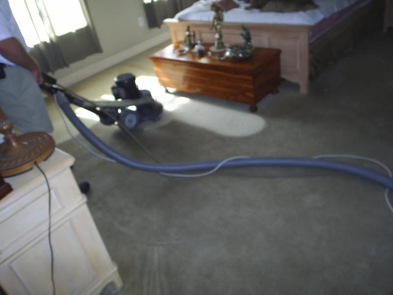

NO Prespray...It was FULL OF CHEM.... :shock:
230 Degree Water....&....Prochem "all fiber rince"....metered at 3GPH...
The carpet was very "Stickey"...It had just been cleaned the month before.. :roll:
"oh ya" and LOTS of Chemspect Defomer....

I groomed it when I was done and it looked white. I would have taken a picture but they were standing there. I didn't want to embarrass them.
Harper nailed it. It's residue left by the last cleaner. I don't know who did it last. I suspect they did. That coupled with the dog makes us look like heros.
That all said. It was mostly a case of rinsing out what the other guy left behind. Not particularly difficult. I presprayed with Planet Guard (and a touch of citrus solve). Presrubbed with CRB and rinsed like mad.

I'd agree with Jeff...looks like it's the way the nap is laying...because the "dirty" section doesn't look so dirty...
As far as your pics Harper...great job...but i will remind you and everyone else here...Chem-Dry's are not created equal. There are still CD's out there using (ONLY) the spray and buff method...which is probably the method used on the carpets you cleaned...because if I came to that home and used a CTS-450 TM with Powerhead (same if not better than your RX-20)..i know i'd get the same results. But I've seen a CD hack use a TM and fly through the job and it looked like sh$t...with only 120PSI, you have to take your time. On average...4-5 rooms take me 2 hours. I get amazing results and would put the CTS/Powerhead up against any other system out there. Over the years we've heard the CD bashing...the great Vortex/Aerotech fued...porty vs. TM and so on...the fact is: a quality technician who cares about his work/custy can do just as good w/ a porty/wand as joe blow with super heat/rx...just takes longer...it all comes down to the guy/gal doing the cleaning...do they care? Do they know what they're doing? Are they rushing?

Walt...Very nice job!!!...That looks like a "TI WAND".?
What ever it is set-up perfect....No streaking or jet distortion...Bad set-up
would show every flaw on the type of soiling..."looks great"
