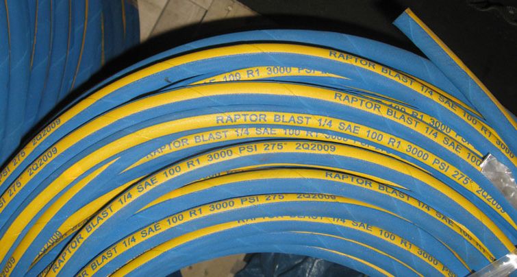

Just a note to our TM hose customers...
that the Raptorblast 275° F hi-temp hose has finally arrived.
Thanks for your patience,
Larry

It is kind of pointless to run a high temp steel braid hose. You still can't run hot cause it transfers the heat and melts lines in vinyl and polyester carpet.
They can rate the hoses however they want but after regular blowouts on steel braid rated 250 I still haven't had a blowout not related to bad crimps on my Parflex rated 230.

when it gets caught under the door the outside part chips away easily

This RaptorBlast hose was used to prevent the "neptune" hose failures.
The inner tube is much more resistant to carpet cleaning chemicals.
Larry
