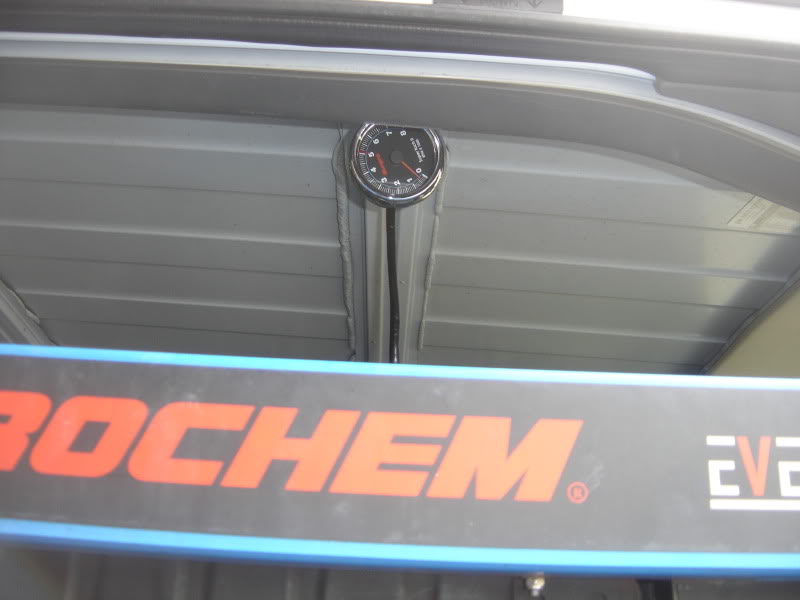

I use an adjustable throttle cable...I still have the governor on the engine...just not spinning it and no connection to the carb hooked up.
I mount the tach on the roof of the van...they would not last mounted on the the unit due to vibration.
