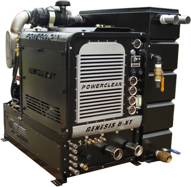

I thought I would put photo's it up to get some comments.
We are very impressed with this new PowerClean machine. For a Diesel, it maintains heat every bit as good as the Petrol slide in's do, but the vacuum is awesome. The diesel has more than enough torque to run the 59 blower and 3" kunkle valve without a drop in revs. The air filters are now in a custom external stainless steel housing box so the blower air filters (that normally sit inside the waste tank) cannot get covered with lint and debris and possibly loose vacuum.
The other super nice thing the amount of things that have had a ceramic heat reducing coating applied to it. We tested this machine in a box truck (posted under the Installs thread) for 3 hours under full load, and there was simply no heat build up in the pantec. None! It runs very cool. Cleaning with a single wand, we have been running it at 1500 rpm, not too much above idle and it is very quite as well.
And you can see the size of the waste tank. For a slide in unit, it has a large 125 gallon waste tank. It also has a series of jets that wash the internals of the waste tank down.
When I have posted photo's of some of the other Genesis machines and installs we have done, normally I get a few comments or emails suggesting to put a bigger waste tank with the beast or to let it breathe easier with larger plumbing.
So what do you think of this unit?

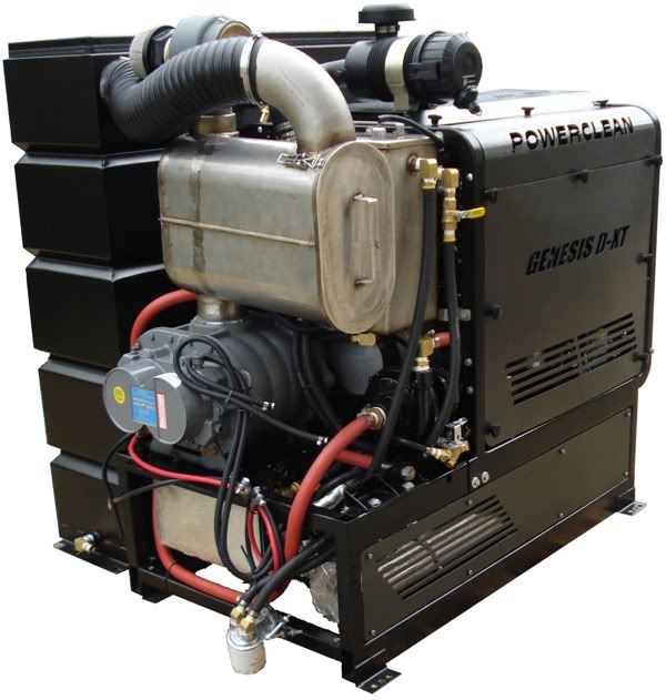

What's the internal blower plumbing set up like. Does it come with 2.5" ports. And what kind of heat can it maintain with 1.5 gal per min flow constant, and what kind of heat can it keep with a spinner...I'm sure it can't handle two spinner heat wise for tile though. How does the heat exchange system work? What kind of fuel efficiency numbers would one be looking at?

Looks great. Can you take out the blower filter and take a pic? You guys said at Connections that you were working on an external SS debris filter like the one used in the trucks down under. How is that going?
looks good Jim, thanks of sharing.
tell me, what's that ball valve and port under the vac ports?
It that for the pump out?
also, what kind of heat does it maintain when running in single wand mode?
(1500rpm)
lastly, is the 125 gal waste tank a "usable" 125 gal?
Reason I ask that, word on the street is, the gas Genny waste tank starts sucking water thru the blower well before it's rated waste tank capacity
ps..hope to hear the GPH fuel usage that Tim asked too.

Nice looking machine and its gets hot. It would be awesome if the gas tm was like this one.

What's the internal blower plumbing set up like? Does it come with 2.5" ports. And what kind of heat can it maintain with 1.5 gal per min flow constant, and what kind of heat can it keep with a spinner...I'm sure it can't handle two spinner heat wise for tile though. How does the heat exchange system work? What kind of fuel efficiency numbers would one be looking at?
The internal blower plumbing exits the blower then goes straight into a large bore blower exhaust heat exchanger and then from there flows through 2 x 2.5" mufflers upon then exiting the machine.
As for what heat can it maintain, at 2700 rpm it will easily hold 235-240 with a wand with 6 gpm jets. But your probably never going to run that engine at them revs constantly unless you are doing external hard surface cleaning, dual wanding or flood restoration.
I honestly did test the unit myself at lower revs, but I rang out client today that purchased this machine and asked him his thoughts. He is, or was a HydraMaster CDS user. His CDS machine in under 3 years old and has the salsa heater pack as well. He said at 1500 rpm, the Diesel Genesis was as hot as his CDS, but has A LOT more vacuum in his words. He also said at 1500 rpm, it was quieter than his CDS. He was quite impressed thus far with his new toy.
I agree with you though, due to the flow (unless your going to purchase an after market diesel burner or LPG setup) nothing is going to keep up with sub 240 deg temps with 2 tile cleaning spinners. It will however with 1 tile cleaning tool, hold very good temps still. You still will get temp with two tile tools, but nothing exciting I don't believe.
Bear in mind, from memory, a Diesel engines exhaust temp is around 800 deg F, whereas a gas engine the same size is around 1200 deg F, so the Diesel's aren't going to have as many burnable BTU's and therefore not feed the exhaust heat exhangers with as much heat. But what they slightly lack on the heat department, they more than make up for on the torque, reliability and longevity over the gas engines.
Rather than quoting something inaccurate, I will put them up after the weekend when we can calculate it and let you know real world figures.
Hi Lance,
Did you want to see in behind the blower filters? If so, I can do that a little bit later on. We have a third of our state under flood at the moment, and the client that owns this rig is flat out working. I will take you some photo's shortly however. The boys are PowerClean USA are working on a pre-filter like the one pictured. I don't know how theirs are going over there as I am from 'down under' and this is the one that we manufacture :)

Larry, the ball valve under the 2.5" vac ports on the waste tank is part of the self cleaning waste tank system. It has a large filter basket that sits directly above that tap inside the tank. It has a shelf in there that collects any of the debris that comes through the bottom of the filter basket, so when you start the self cleaning system, a lot of the heavier debris will collect here and is easier to wash out of that shelf, than getting caught and having to try and wash it out of the bottom of the waste tank. There is also a flood jet that pushes from the back of the tank towards to big on/off tap down the bottom of the tank as well.
In regards to the waste tank size, you are correct. It is not "usable" to 125 gallons. But then again, no TM manufacturer (to my knowledge) ever quotes usable. The quote overall size and vacuum. Just like blowers. Manufacturers do this, I think not to misinform, but rather as a benchmark. The waste tank on the gas Genesis, just like the Diesel Genesis, and the same as the Prochem and HydraMaster waste tanks never will get to 100% capacity before the high waste water shut down kicks in or the APO float switch engages. But it won't suck water into the blower on the PowerClean machines or any major machine manufacturer for that matter (unless someone disconnects the high waste water level shut downs every manufacturer uses in the waste tanks). It may however, suck through some foam if it is floating around inside the waste tank. I will also get back on here as I stated above and post the diesel consumption.

SRI Cleaning said:
Looks cool! what are all of the qd's on the from for? What is the expected price for the u.s. gonna be?
The large S/S on the bottom left if for incoming water. Because the Genesis runs a multi-temp cleaning system, that is what these are for. One Q/C is for cold water, another for warm water, and two high temp, high pressure Q/C outlets.
I am sorry, I don't know what the price is over there in the USA, but your nearest PowerClean distributor will be able to inform you. If not, Larry, the director of sales for PowerClean could shoot you an email.
Scott Rogers said:
What is the Valve in the middle of the dump tank for?
Hi Scott,
I mentioned this in Larry's reply. It is part of the waste tank wash down system.

Sorry Jim, I didn't mean take away the blower filter rather take the filter that is in the SS holder out. I am wondering what shape it is and how it protects the blower.
It looks like it's oval and I wanted to see if the blower sucked air from in the middle of it so any debris would be caught on the outside of the filter. The canister looks really cool...i love seeing custom jobs.

I, too, would like to see the inside the vac filter assembly.
