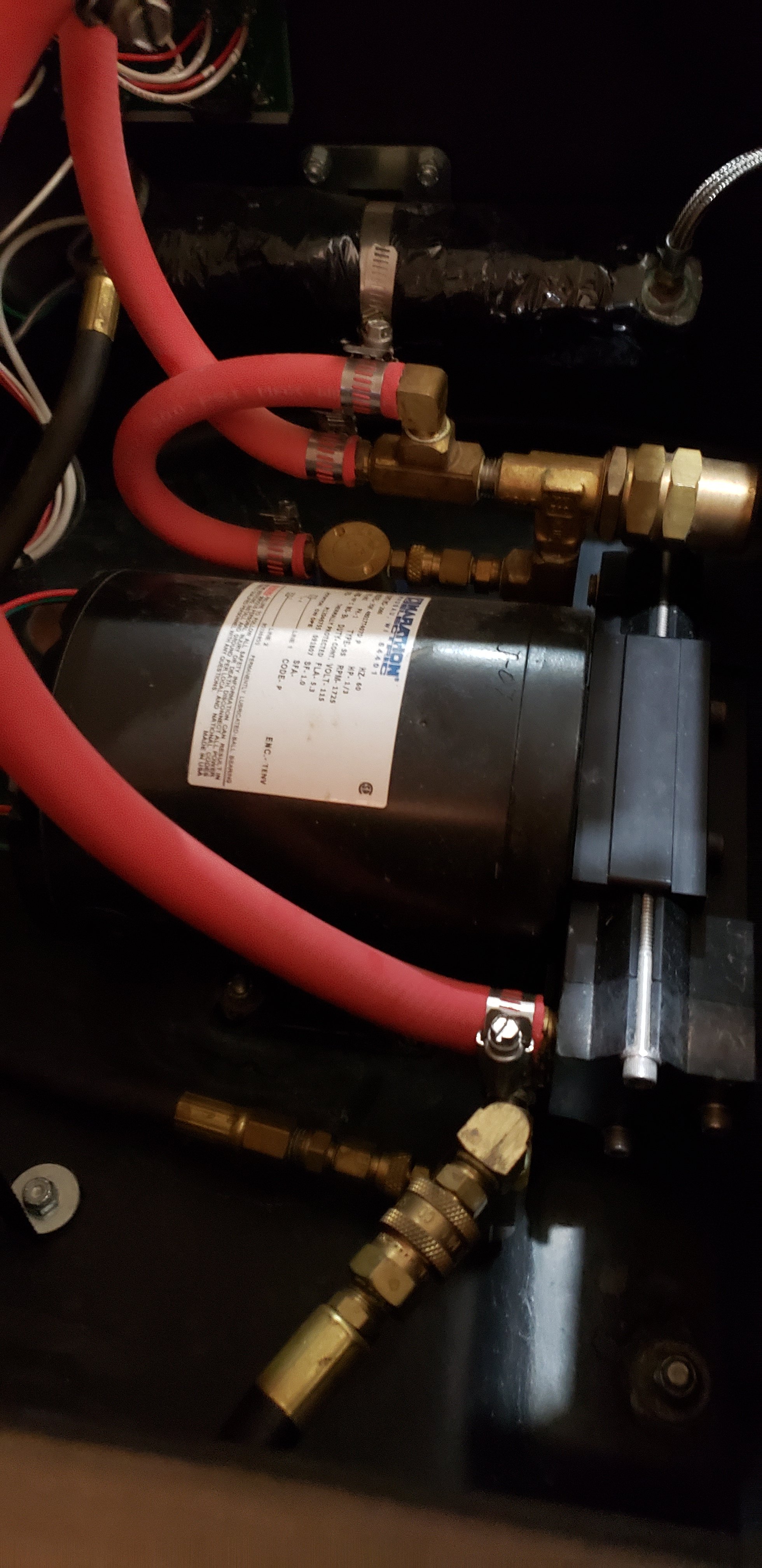

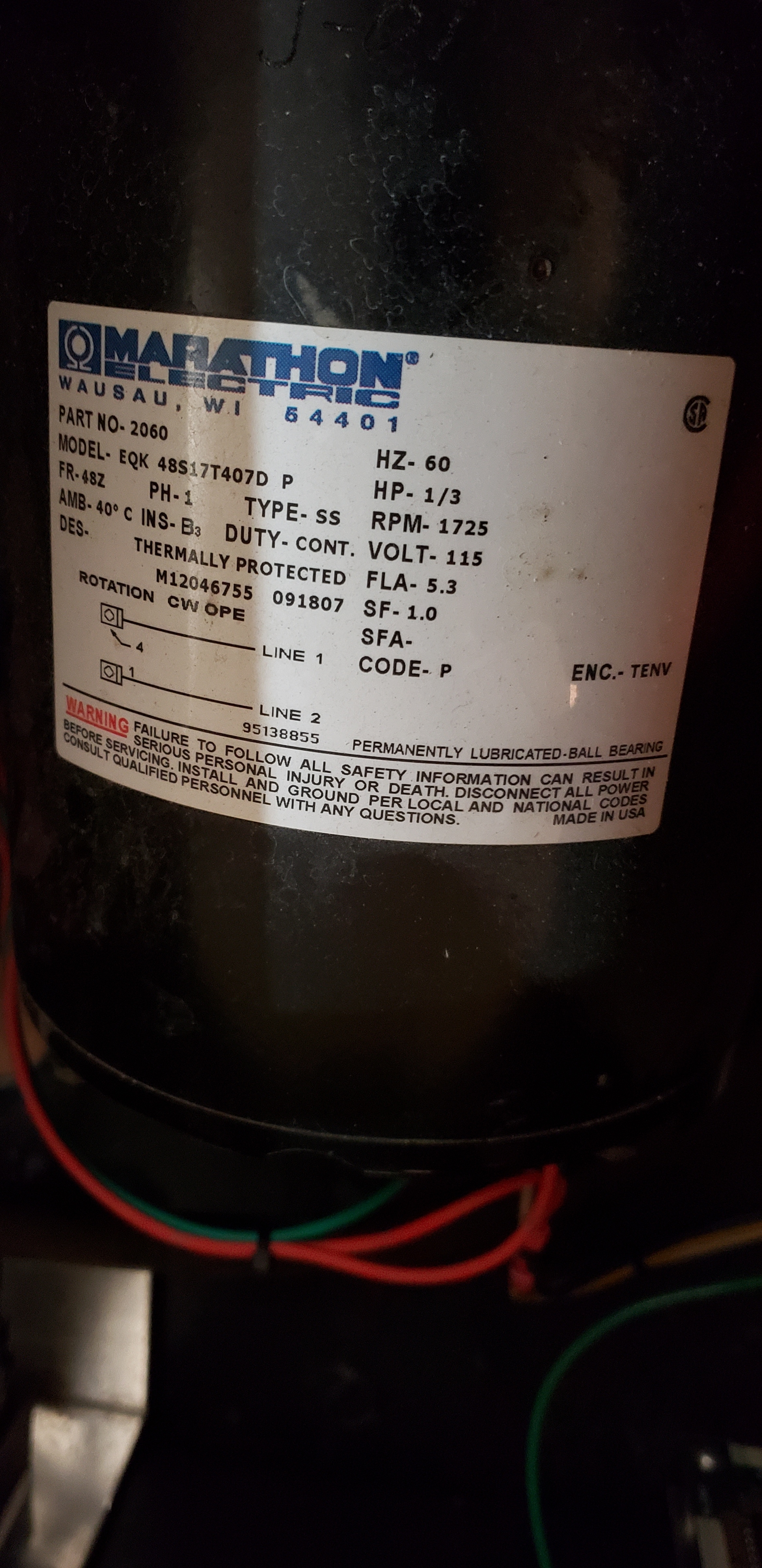

My US Products Solus 310's pump is getting bad and seems to be loosing pressure. Should I rebuild it, replace it with then original or try and find some aftermarket pump? Any links to suggested pumps appreciated.

Like tile carpet and mostly upholstery.
probably a 500 psi two vac machine
It's hard to find one machine to do everything well. If you're doing a lot of tile, consider the rotovac ranger 1200 psi. You will have 3 power cords and need somewhere for the apo to go. Otherwise I would recommend a tile specific machine with 2-2stage vac motors and something with 2-3stage vac motors in parallel and 500 psi like the Mytee speedster. Don't buy a heated portable. Tile cleaning really needs a large capacity machine or an apo. I am using an old ninja with a 1200 psi pump mounted on top. Works great except for having to dump every 5 minutes.
