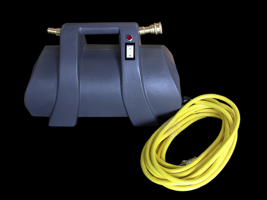

EDIC has an external heater that I've heard through the grapevine can have some issues.
Sandia I know nothing about.
The heat option puts the amp draw to need 2 cords.
My pick would be the EDIC with a kleenrite heater.

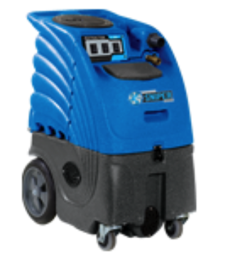

I've narrowed it down to these 3 units
1. EDIC Galaxy 5 with the external heater
2. Mytee 8070
3. Sandia 6 gallon heated
Let me here you opinions please

Ok i think i settled on a sandia 86-2100, dual 2 stage vacs, 100 psi pump 6 gallon fresh and recovery tank, non heated and runs on 1 cord. weight is 82 pounds.
If i decide i want heat later on i can add an external in line heater which will put me at two cords when using heater.
I think i like the fact no internal heater inside the unit. Best part only $945 and free shipping.
I like the Esteam E600 non heated as well but best price I can find on it is $1,182.00 but no free shipping also the Esteam Ninja Classic, 150 PSI Pump, Dual 2-Stage Vac Motor, No Heater, Machine Only i like but that one is $1,332.00 nd no free shipping.

well i went ahead and got a 10gallon 150 psi dual 2 stage non heated ninja classic which is a one corded machine, pump is a on demand pump so it don't run till you trigger the upholstery tool.
If i decide i want hotter then hot tap water i can always add an external in line heater putting me at just to cords.
dual two stage vac motors should be fine for upholstery with 2inch vac hose under 50 foot

Good way to go. Not much heavier than the 6 gallon and gives you the ability to do small carpet jobs as well.
