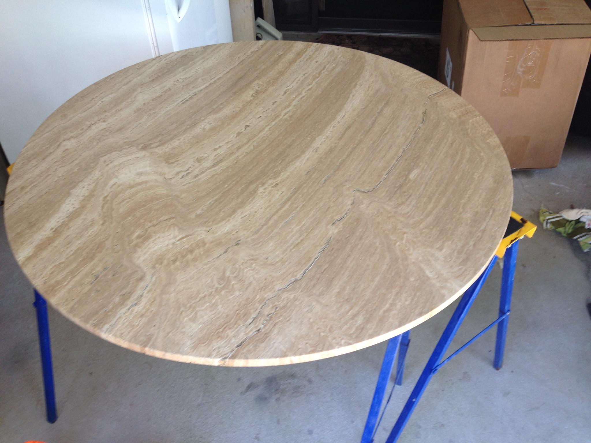

I am new here and seeking some expert advice. I have a table with a round Travertine top that has been in the family for about 60 years. It has gotten dull looking all over, with what I guess you all refer to "etch" spot areas that are a little worse. I have been looking all over the net for info and products to try to re-polish it; and finding lots of info that is sometimes conflicting. Most of the products only come in large bulk quantities to do hundreds of square feet of flooring etc. Some recommend dry polishing powders, and others the paste type compounds. Some contain acids, that require special neutralizing rinses; and I worry about getting on the wood. Others seem to involve diamond impregnating pads and use a very low rpm polisher that I do not have. My question;; .... is it possible to re-polish and put a fairly even shine (doesn't have to be a really high gloss; just even looking again with some shine) by maybe using a wet/dry 800 grit sandpaper and wet sanding it? Table top is about 3' in diameter. If this is possible; would it be best to do by hand, or with an orbital sander?

Here it is..

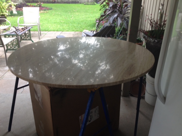

You obviously missed your natural calling; should have been a baseball coach. LOL I followed your advice to "swing for the fences"; and I seem to have hit a Grand Slam Home Run! I had gone by my local Harbor Freight to get a cheap orbital palm/hand sander, figuring the rock/stone dust would have the same effect on my good sander that pouring sand in the crankcase of my truck would have. They also had combo packs of 220, 500, 1000, and 1200 grit wet/dry silicon carbide for CHEAP and it looked like good quality stuff, so bought it. On to the local auto parts store and picked up 1500 and 2000 grit which was the finest they had. Spent about 5 to 5 hours on it and it looked REALLY GOOD. Decided to try and find some 3000 as you suggested. Found one place with 2500 so went and got it. Went through all the grades sanding dry. Did a final polish wet with the last of the 2500 grade. Now it looks even BETTER! I was only 9 when my Mother got this table; and that was 60 years ago; so I can't remember or swear to it for sure, but I don't think it was this shiney when it was brand new. The picture attached below is just wiped off and cleaned with NOTHING on it. It was taken against a very overcast sky a little after 6:00PM. You can see the reflection of that large oak tree in it nearly like a mirror. I actually noticed a squirrel running on a limb in the reflection when I was fixing to snap the pic. Believe it or not, that little $11.00 (with coupon) "Drill Master" sander held up like a champ and completed the job running strong....surprised the Hell out of me! Now I have to decide which direction to go from here. Do you have any more good advice to seal, or not to seal, with one of the many stone seal products I have seen; or any other finish protector or polish to put on it?

Looks great.

Nothing really is bulletproof and remember that travertine will etch if anything acid is spilled on it. You could use Saiger Super Sealer, but then if it is an outdoor table you could just apply a good automobile paste wax from time to time.
By the way, you really did a good job. Well done!
