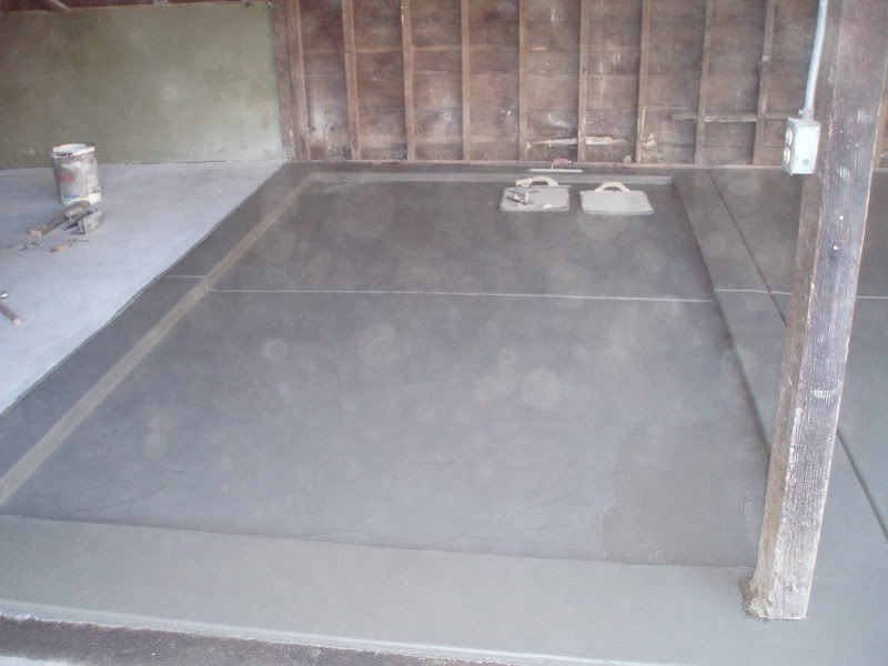

Pit number #2
116,356
#1 is to the left and lots of flat, clean concrete for dusting, HWEing and what not to the left.

Kind of a small pit don’t you think?
You’re going to wish you didn’t put that expansion joint there in about a year
116,356
The walls will have a water proof dry wall about 4 feet up.
The 17 x 15 pit is out of the frame.
This is the small one.
Steve, you need to up the strength of your Dr Dean Edels.
There is a sump pump hole right that there.

How does the pit fill with water if there is a hole in the bottom? If you plug the hole, wont any rug you place in the pit be sitting in dirty or urine filled water? I know the general idea is to have a river effect with clean water coming in and the dirty water going down the drain hole. How much flow can you get in a pit like that, and what do you use to pump water into the pit? A waterhose?

Waste of a lot of money! My pit that I made only cost $68 dollars and I can break it down
if I need more room.
Remember not all rugs need to be pit washed!!!
I only do the urine soak rugs .

Mikey,
If your talking about the green drywall, it is water resistant, NOT waterproof.
I would do as Randy suggested. Use cement board, thinset and tape the joints.
That is water proof!
