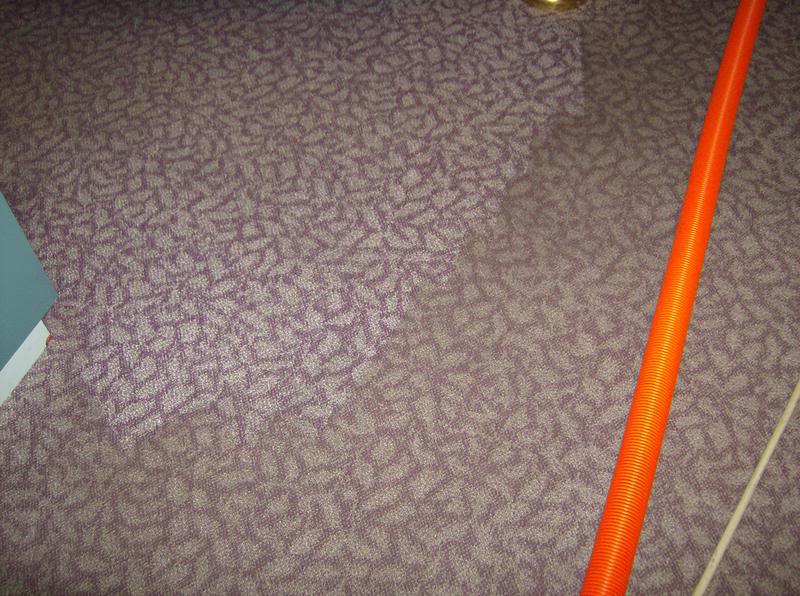

this job requires the stretch of a life time...thanks greenie for the 2-1/2 " set-up with the live reel bypass...9 sections 400 psi and dry in 1 hr 20 mins with no blowers.
pre spray was butler with a little boost of dynachem's citra solv...
customer is very very happy..
we have cleaned over 30k sq ft for him and well over 500 chairs..and he keeps on adding work by the week. he pays net 3 days...i love accts like this.
i just dread the day it go's away..i am glad i am not relying on it being a permanent part of my business...we will pray for it to stay forever but plan on it going away after each job..if that makes sense to you all.

Which side is the clean side and which side is the dirty side of you pic above? :shock:
davegillfishing
2,229
dave gill
i dont have time to answer that question...i am on my way to the bank to deposit the check :lol:
