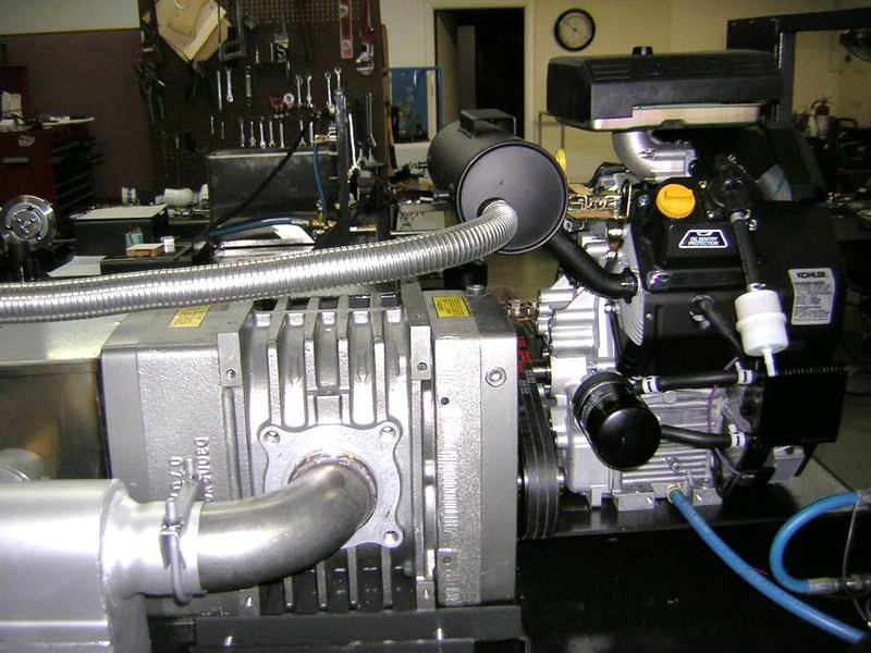

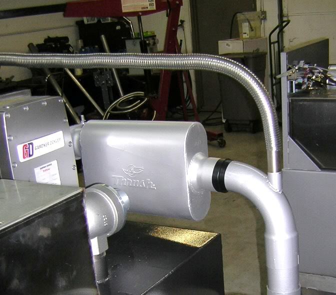

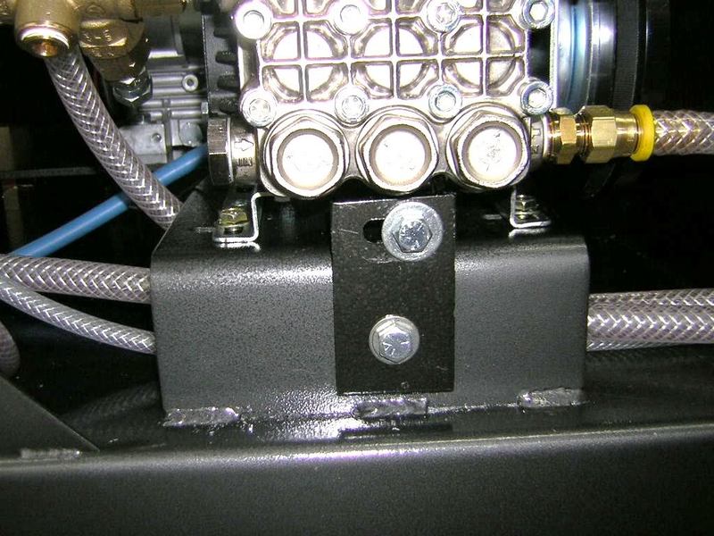

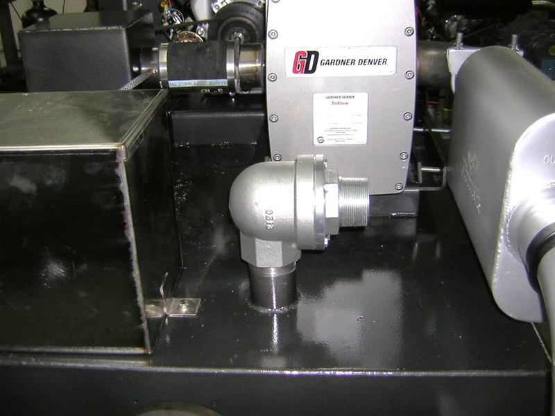

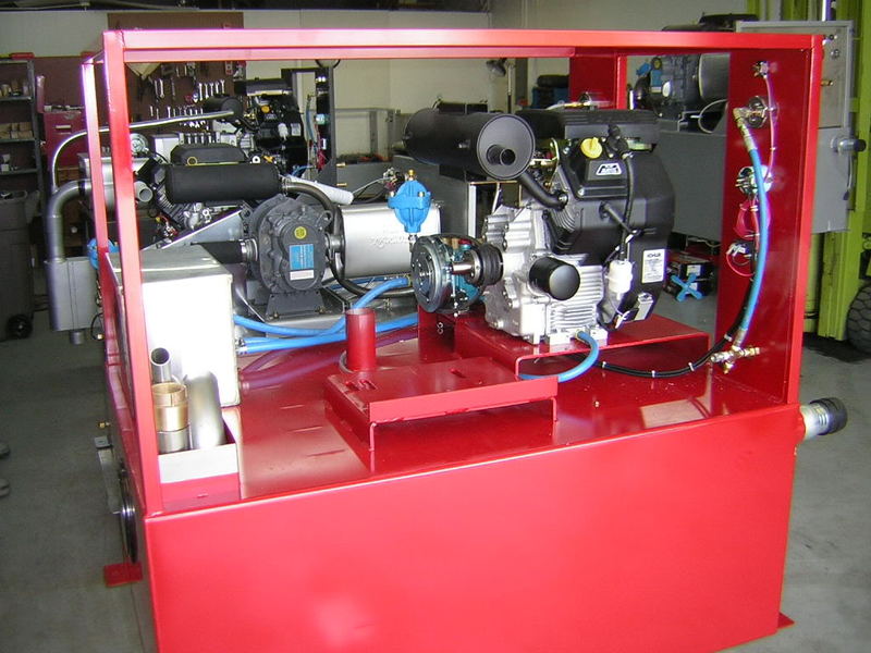

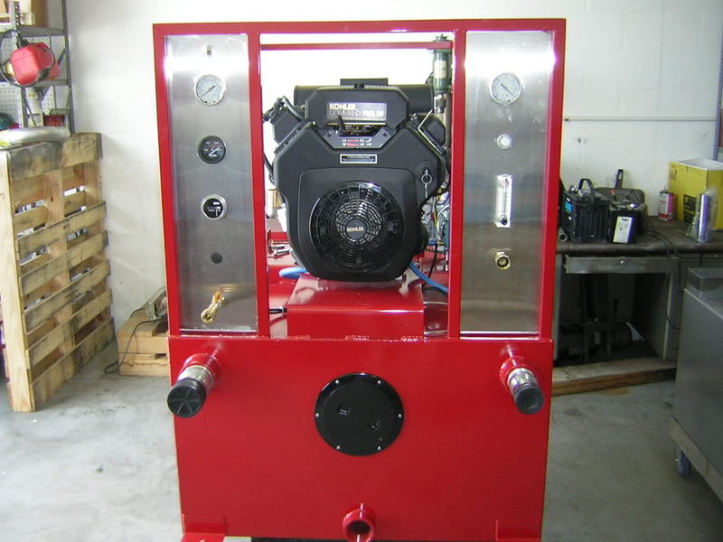

Mikey P said:
Over kill for a back up or what?
150 gal. SS Waste Tank 127 gal. usable
30 HP Kohler Engine
Sutorbuilt 408 Tri-Rotor Blower
General Emperor Pump & Clutch
2-2&1/2 in Vac Inlets
2 in. Bayco Relief Valve
SS Blower Fittings
2 Hi Flow Mufflers
#4 Little Giant 180,000 BTU Heater with mounting brackets
Adjustable Pump Bracket
THIS IS WARREN'S UNIT

That's an awesome looking machine.
I wonder why he didn't go with a 59 blower and slightly larger motor.
Will it be able to dual wand?

work of art!
I'm not going at ask what Mikey paid, but what does that same machine retail for?
This unit will maintain 240 degrees on a Greenie 10 flow wand or it will maintain 240 degrees on two standard flow wands. This unit is fully capapble of running two wands if needed.
It has the legendary TNT layout design, uses the most common local available parts. All the components are easily accessable. Once the unit is mounted in the side door of a van the pressure pump is located between the driver and passenger seat. Also the blower and engine maintenance can be performed from this position.
The price of this unit is $16,995 and includes the base unit, #4 high pressure Little Giant Heater, 100 feet of vacuum hose and pressure hose and one 12 inch standard flow wand.

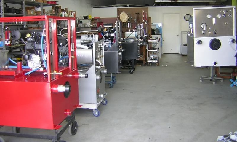

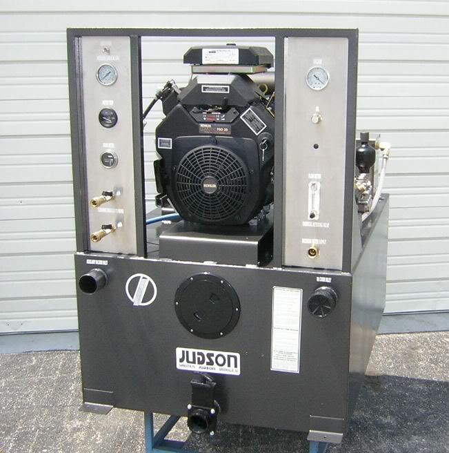

You are looking at my 2nd west coast demo machine, The TNT-500 I think it looks sweet, kind of an urban commando S.W.A.T. thing going on.

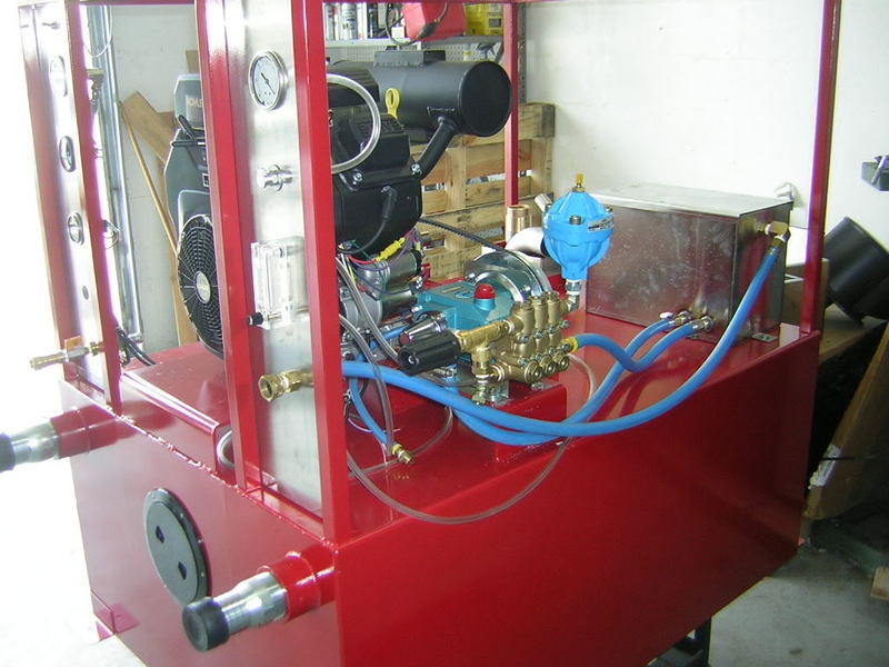

I think I see another TNT in the background headed this way as well, what I now call the Classic TNT.

How about some tnt Dynomite graphics waterjetted into a polished sheet of stainless, done on a Radius bowing Out, Judson across the top, dynomite in the center, TNT-500 across the bottom, would look clean.

Nice very Nice. Congrats Mikey and nice job Judson. I love the simplicity of the machine.
You may be running the van more than you thought.

30 hp, air cooled, #4 blower, propane heat, huge foot print?
Is this a 1985 special?
Sounds like a step backwards to me.
Propane? With all the free heat from the engine and blower?
At least they put a Kholer moter on that bad boy you will be
able to swap that thing out quickly and cheaply after few thousand hours.

Go measure your pos Titan and waste tank's total foot prints and compare it to the Pail's.
It will be twice the size.

if it were choked down by Hydomyster I would have to agree.
With the 2.5 filter less Judson set up it will equal your 59 in performance in every way.

Doubt it. The way the Titan is set up it will blow your 6008 out of the water.
Its as good if not better than my old 7008.
