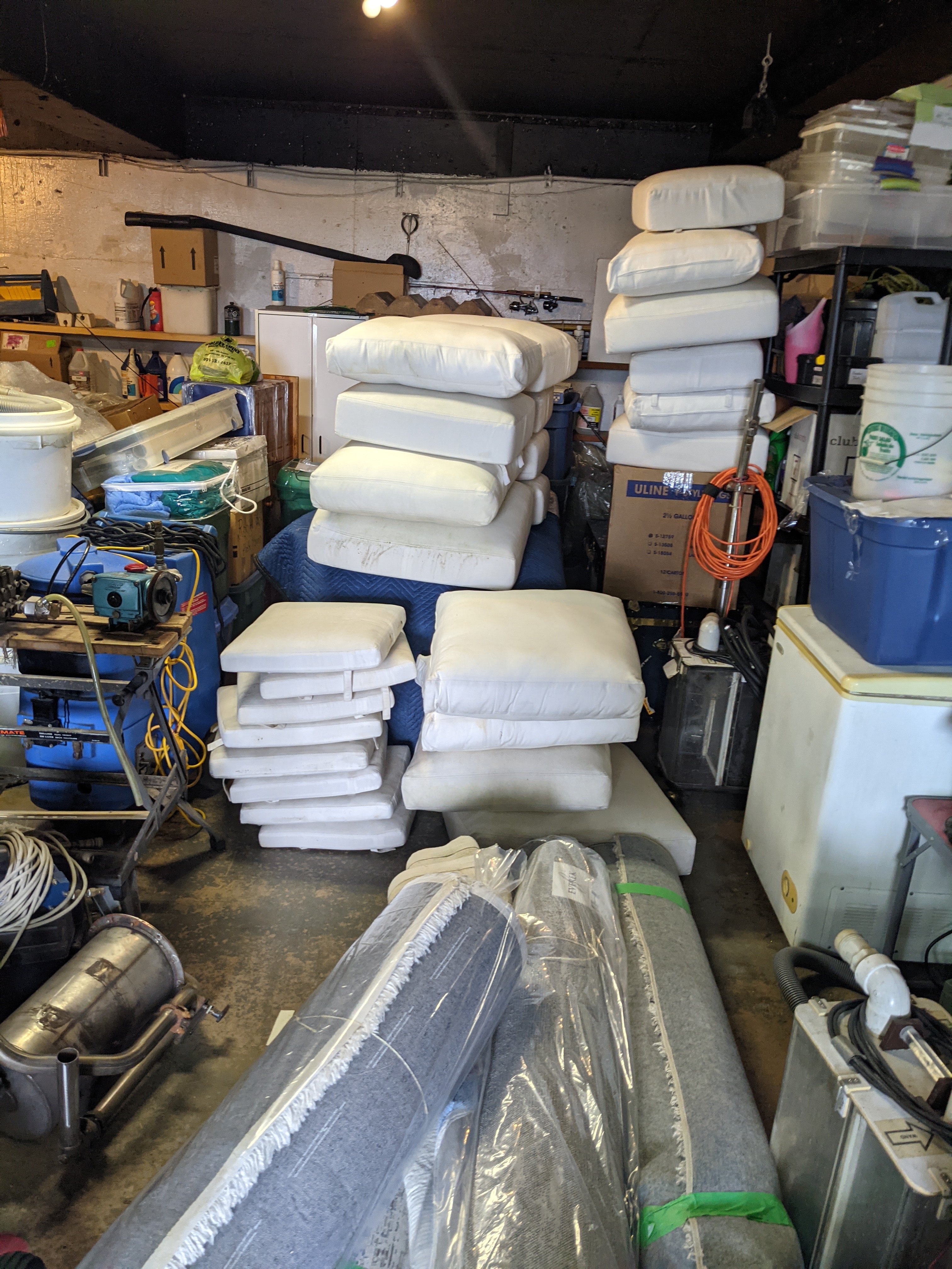

Picked up about 27 outdoor cushions today. Why do people think white is a good color to be left outside?

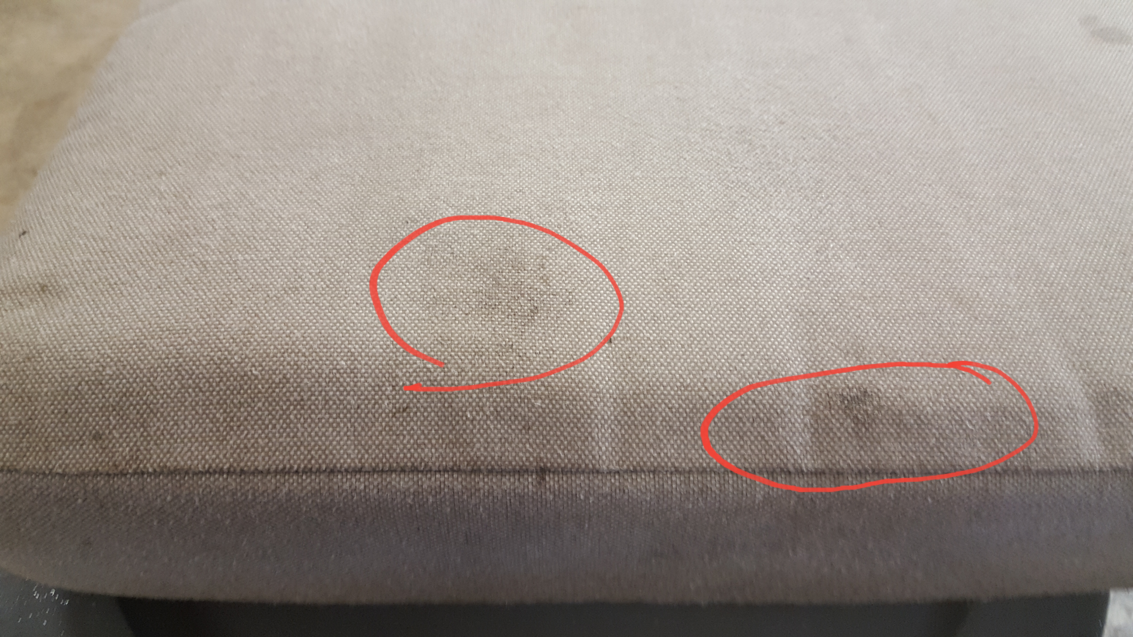

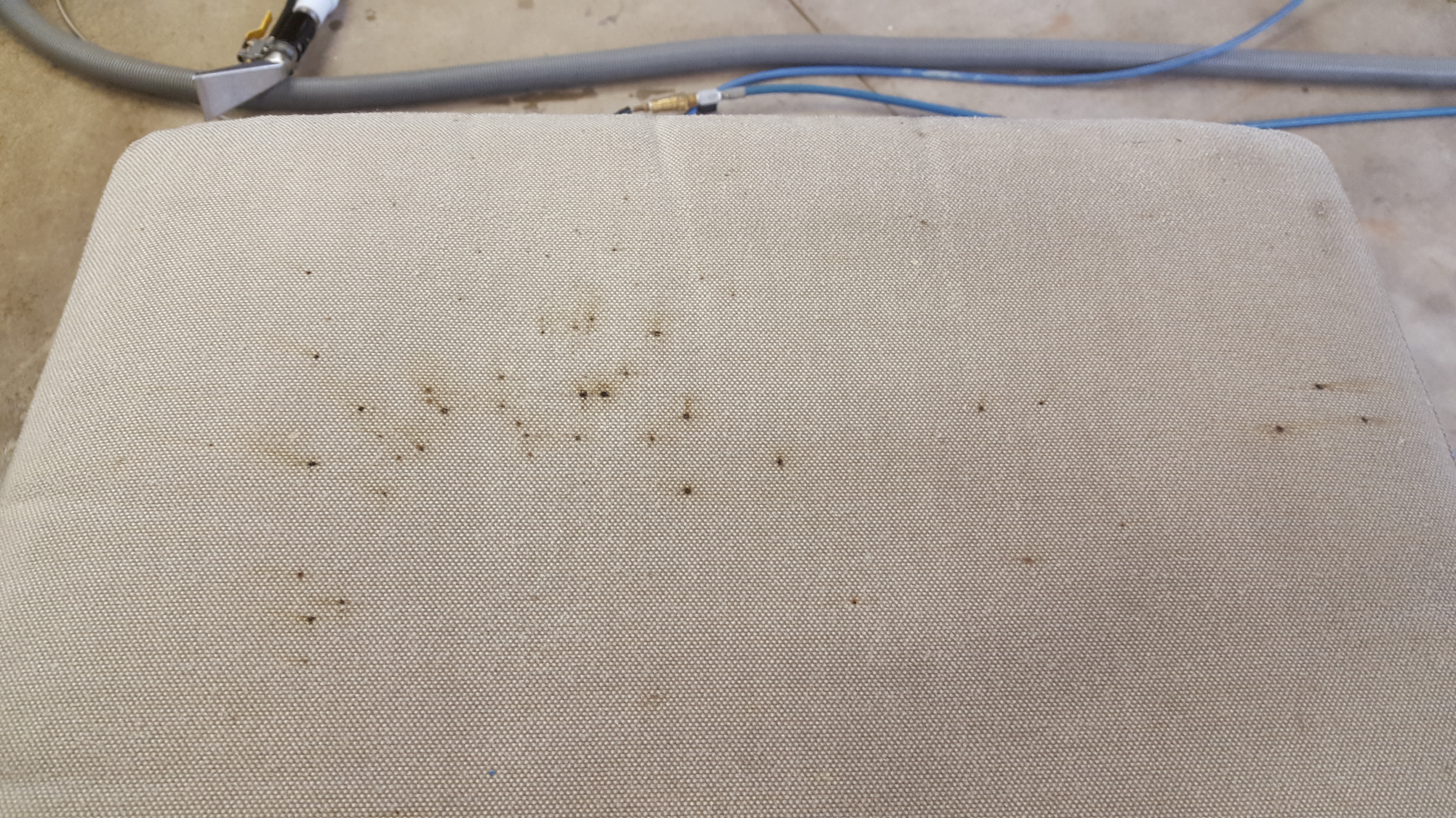

These cushions have mold and water stains. I use peroxide in my pretreatment, let dwell a bit then rinse it out. Removes quite a bit of staining. Then I apply full strength on any remaining stains, let dwell then rinse out.

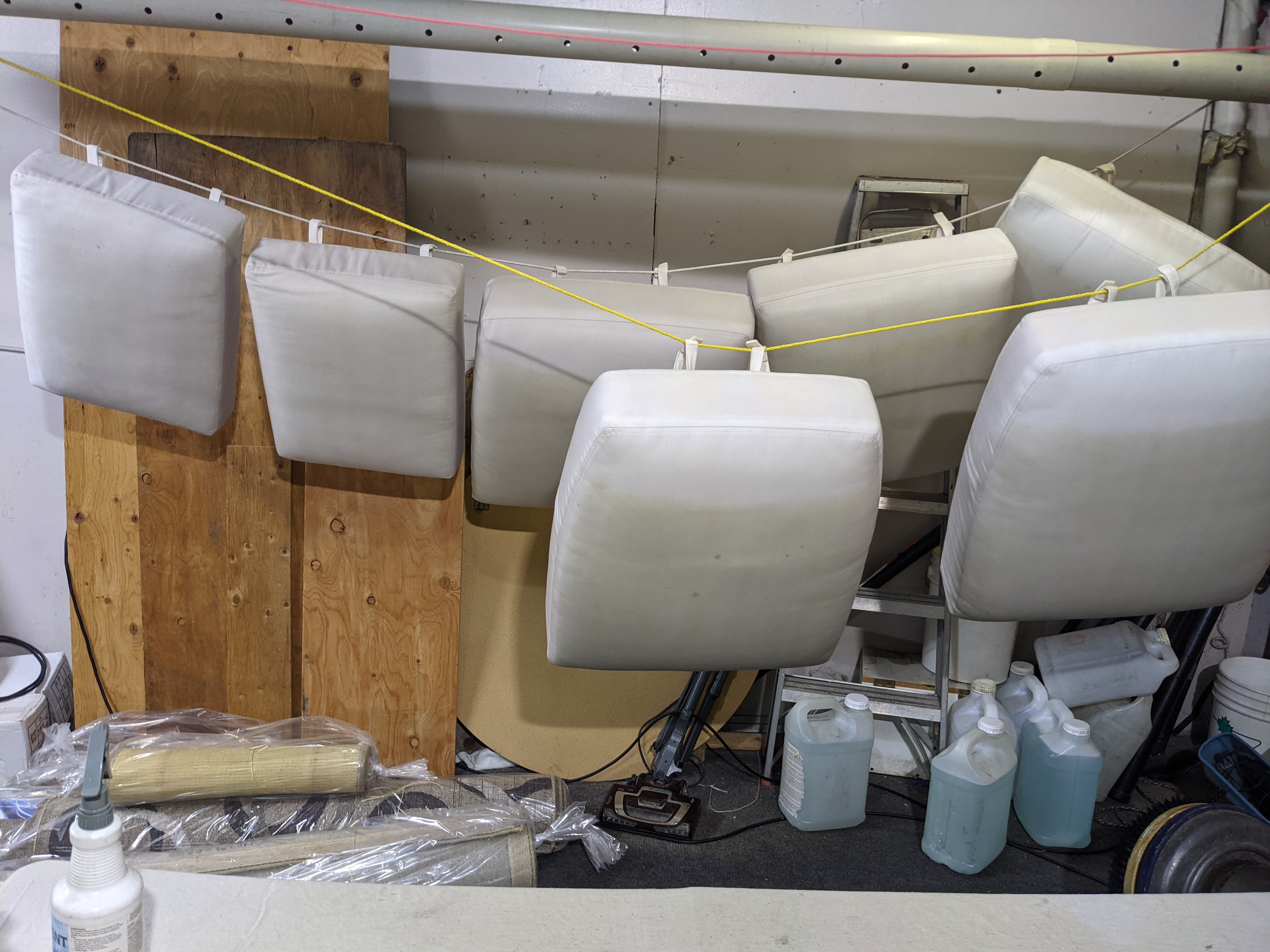

Do you set them out in the sun after you apply the 40 volume?
28,266
No, don't usually have enough sun here. Ironically, we had nice weather until the day I had to pick them up. Poured rain and the cushions were soaking wet. Lots of fun.
