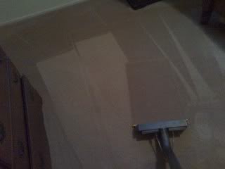

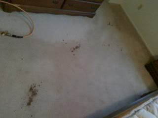

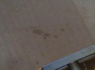

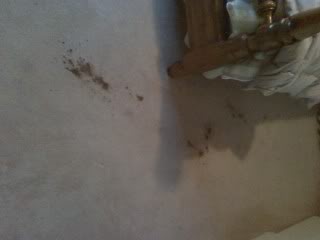

got a call from a regular old lady who had a fit of the Whistling Crackers..
perfect opportunity to test the 123 Resi version.
I mixed it strong and boosted with the D-Limo.
Gave it 5 minutes and rinsed with Soap Free.
Got the bulk of the shit out but far too much did not come out after heavy and HOT rinsing.
I thought I'd try some O2 but seeing how its pretty much the same shit as 123 I used my trusty Redline with a 40 Vol boost and Pow!
gone..
Maybe 123 needs some enzymes or STPP.

I am pretty sure the commercial prespray is nothing more than an enzyme cleaner. I would never clean "shit" with sodium percarbonate or a regular spotter. I would use powerburst, enzyall, or similar. You should have used the enzyme.

Seriously. First pass no prespray with cool water. Then a peroxide based quick finish to the job. Unknown fecal or bloody soiling can have iron based staining that tends to be set by heat.
Everybody has probably had experience with returning blood stains that end up being more problems the second time around. Cool water reduces the spreading and pooling allowing more to be removed (and not just moved) in the initial extraction.
