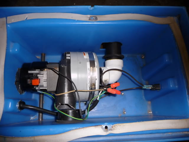

thats funny, that was the second thing I noticed when the little inline booster arrived, the vac motor had dislodged from it's hose clamp mounting and busted off the plastic "horn" of the exhaust (visible in pic) from rattling around in the case, maybe Ed will use better than hose clamps to anchor his vacs, they come with three anchor points from Lamb, use at least one of them.
