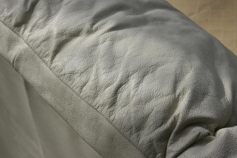

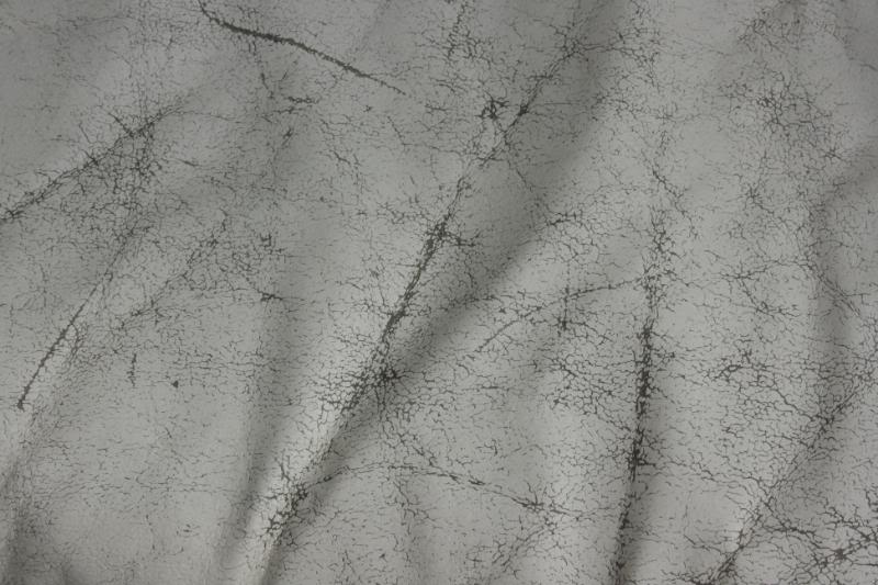

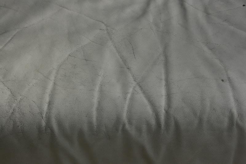

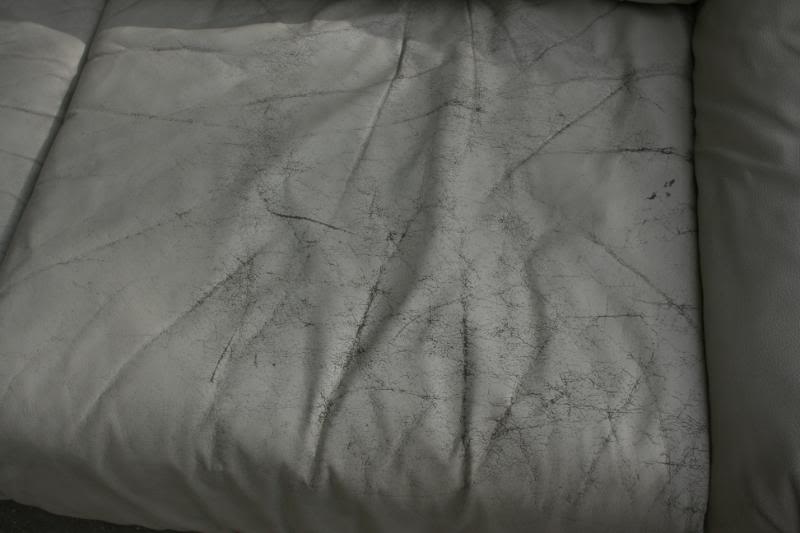

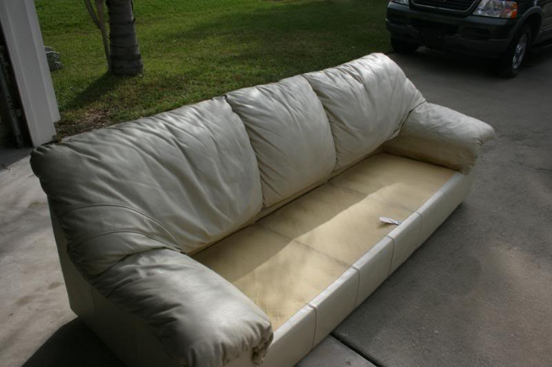

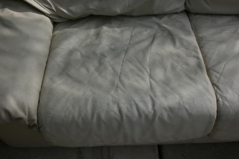

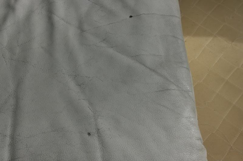

after a bunch of pics and questions i finally have a piece that i can do..

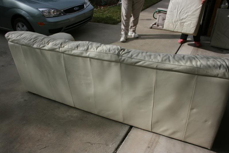

this is a sofa that a customer gave me because she was going to toss it..
so this is a piece that is in my garage and ready to be played with, i cant wait to
get this done so i can start pushing this service to my customers..i just needed to do one
before i really pushed it..
here are the pics
if you can tell me what i need and how much of it i need a little direction and i will get started..
thanks
by the way...we want to paint it light brown

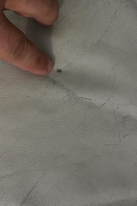

Damn Gill those are disgusting. What the hell are you so stressed about that you would chew on yourself that much?
I can tell you this, you'll have to sand down that cracked leather, bondo it and air brush the color back.
I taught Tony how to do this so I'll let him pay it back to you.

Dave will need to first of all clean with some scotchbrite pads and rinse the whole piece.
Then apply some Hydrator and cover with saran-wrap overnight for several days.
Then repeat the same process with fatliquor.
This will close up a lot of the cracks that were caused by the leather having dried out.
Once that process has been completed the remaining cracks and nicks can be be filled with leather filler and sanded,
Then you can start to airbrush or pad on the color coat.
I would not advise a color change because on the outside back and sides you will be coloring over the old top coat and so it may not bond well enough.
Roger does have a great product called "Adhesion" that may overcome this problem but since I have stopped offering color change services I do not know if this would work.

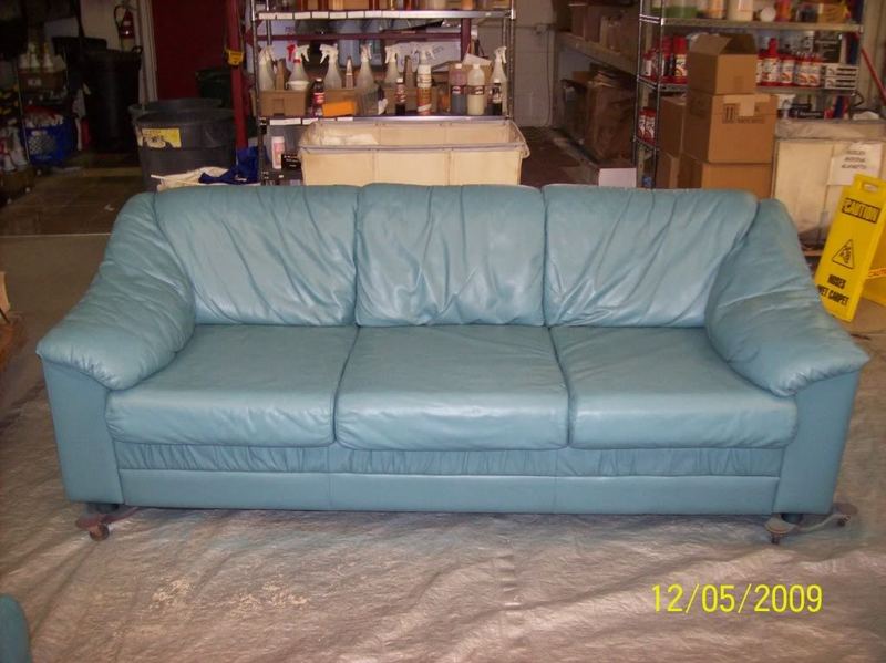

Thanks for the message.

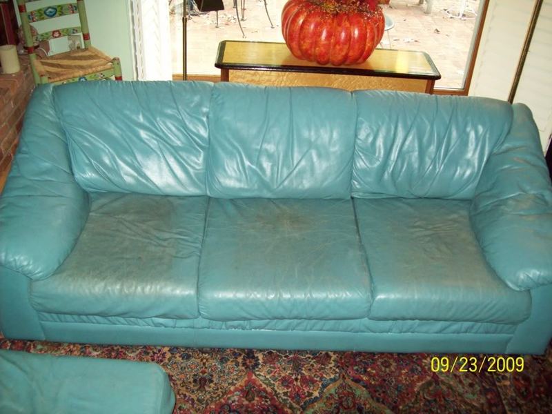

So you wish to transform your sofa like this 15 year old piece into a 15 hour old piece as shown in these pictures.
#1: Before
#2: After

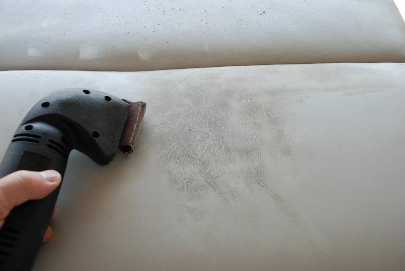

Don’t worry about side entertainment – get the right tools first and practice if you like it especially the spray guns.
Next is sanding tools – one for detailing and one for general surface as shown.
It’s preferably used one that has speed control.
And sanding disc for the oscillating sander – get the 1000, 1200 and 1500 sanding grade.

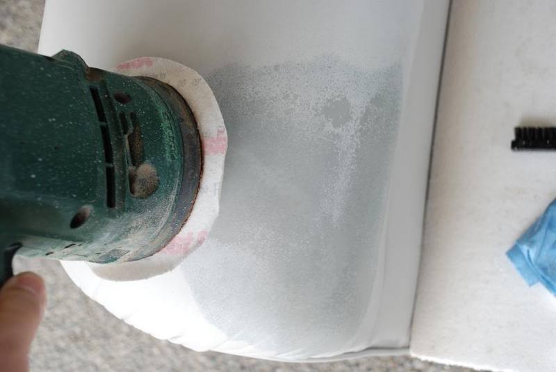

got the sanding tools already..i will pick up the sandpaper tomorrow...
so do i just start like it is a car till all the finish is off, stop when it is down to bare leather
or do i want to scuff the leather as well?
we want to go really dark brown, almost black but not black.
thanks
oh and i will not worry about all the side comments, i just wanted to make sure i was not missing something that i shouldn't be missing..
i am going to be playing with the spray guns this weekend and will see what i end up with..my buddy is going to let me borrow one before i buy.

Dave, if you are going to use a sander may I suggest that start off by wrapping the sandpaper around a sponge ( remove any rings from you hands ) and begin by sanding by hand just to get a feel for it. Whenever you are sanding start with a medium grit and go light. You can always move to a coarser grit and a heavier hand. We do a lot of sanding by hand. If the leather is really brittle, thin or dried out, be very careful as you don't want to rip s new hole in a cushion. Roger has products that will re-hydrate the leather and strengthen it's structure.
Good luck and take lots of pictures for your future brochures and web-site - you can always delete them if you screw up.

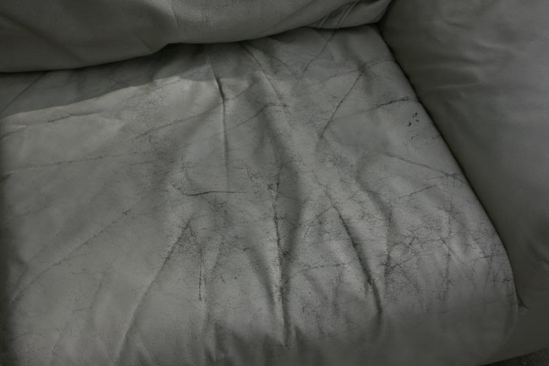

These areas can be easily be identified by the darkening effect once the leather is prep clean during the rinse process.
Needless to say by the look of these cushions, they qualify to be rejuvenated, impregnated and repair unlike the remaining parts of the sofa.

makes sense..i am going to start sanding on the nastiest cushion tomorrow and see what happens..i will post pics.
thanks for taking the time.

Do the one cushion as you please for comparison of system approach and do mark to identify it.
Leave one cushion and try out with this recommended approach.
Prep Cleaning:
1. Examine the existing condition of finishes by giving it a 2” Scotch-Tape test.
2. This test will determine whether the entire finish is to be removed to the crust or partially.
3. Prep clean it with a pH 7.7 prep cleaner by application, horsehair brush agitation and spreading it as thin as possible with an even coverage and let dwell overnight.
4. Clean off suspended contamination with a pH 3.8 cleaner and rinse with a pH 3.0 rinse.
5. This is where our decision to remove the existing finishes begins after rinsing.
6. If the Scotch-Tape test reveal that the finish have to go, it may be easier to remove it clean with a leather Razor by hand in combination with spray rinse.
7. Otherwise the existing finish will be partially wet sand without hurting the leather crust.
8. Note: While the leather crust is acidified with a pH 3.0 rinse, it’s cationize and is stronger than dry and have less chance from being hurt than if it is dry. Do not remove any damage leather at this stage; leave it for the repair stage.

1. Color Coating
To control the flow of color coating a thickening agent helps to improve hold-up especially on vertical panels.
This is practice by adding 5 to 10% into the color coat prior to spraying.
Sanding again comes in for the repairs areas
Note:
This is a “green” system, where no solvent or alcohol is used for the entire process.
It’s Non-Hazardous, Non-Toxic and Environmental friendly without the VOC.

ok..i am glad i didn't go after it with the sand paper before i read this post..
i will do the test and report back..
and i want to use all your products so if you could give me part numbers and amounts i will need for
this project i will get it ordered and start my project.
i will report the scotch tape results later today.
thanks
dave
