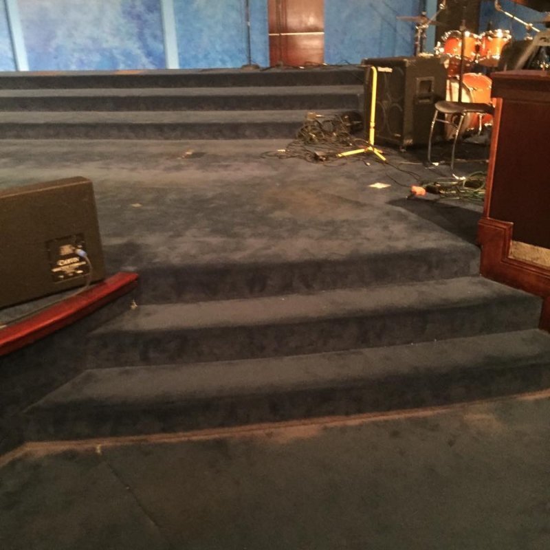

So one of my Minneapolis color trainees this week was told by someone that there is no market for carpet dyeing services. ;)
Check out the job that my trainee just got in today!
Congregation just purchased this church. They want the entire carpet restored. It's still in excellent overall structural condition. $$$
He should be able to charge $6,000 - $8,000. Job will take him one day. Total material cost will be around $20.
Equipment needed: Portable extractor, dye wand ($80), and some dye.
