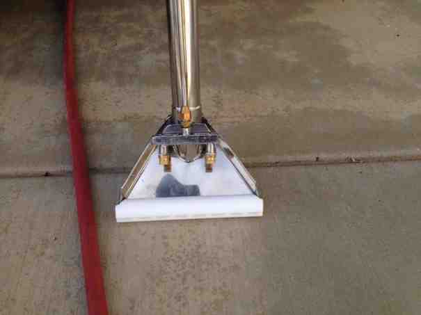

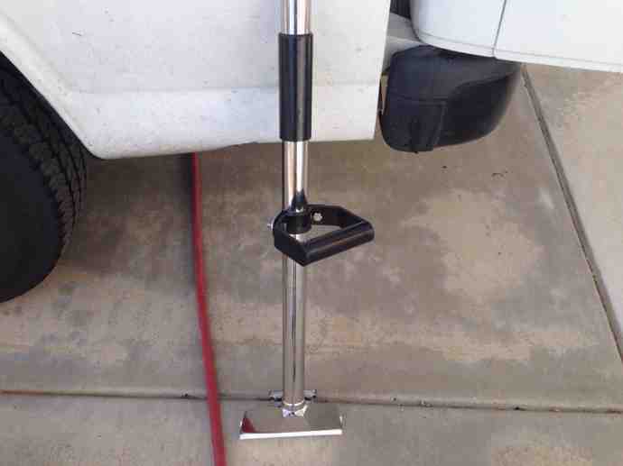

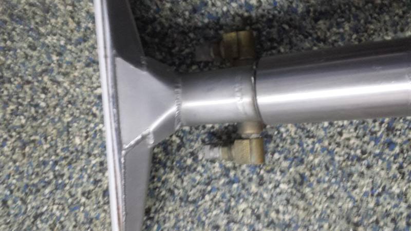

I really like this tool for detail work like stairs, thanks Cobbs for a great tool

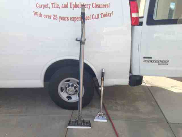

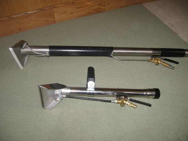

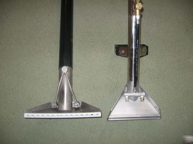

I love mine too ..it's looks similar to your Cobblet tool
The large one is a Greenie tool..it's a good tool, but I personally prefer the smaller 22" tool

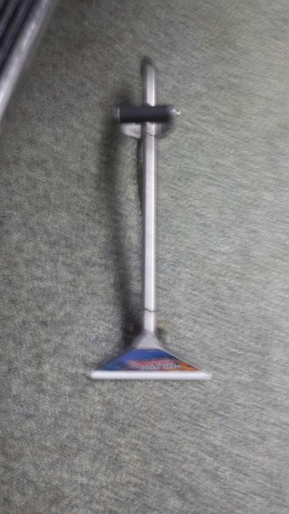

I have the Prochem stair tool with 1 jet... The newer ones has 2 jets like yours...
I still like Able's one that he chopped a Prochem TI... But I just run the RV360i on the treads to get the them filthy one clean...
I even have one of those swivel ones that Mark Saiger showed in his hose management video... I never did use it, but after watching his, I may give it a try... It came with some equipment we bought..

Those are cheap Vietnam copies of the prochem stair tool. Stand for something or fall for everything...Buy the prochem tool Proudly made by PMF in the USA
Not the Greenie tool Larry poste that is a PMF custom Stair tool and we have them in stock.

Dang, Larry. You keep your tools clean.
LOLL, Art
Those were new 5-6(?) years ago
I don't know what country of origin the small came from, I DO know it's a well made solid "forever" tool
I don't know if it's the same as Cobblet's ..I bought mine for down right cheap (like a $100?) from some chic on e-bay ..that wasn't around long ...maybe the Asian mafia got her??....i donno, but do it's a damn solid tool

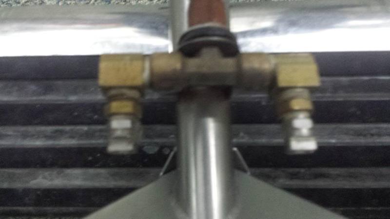

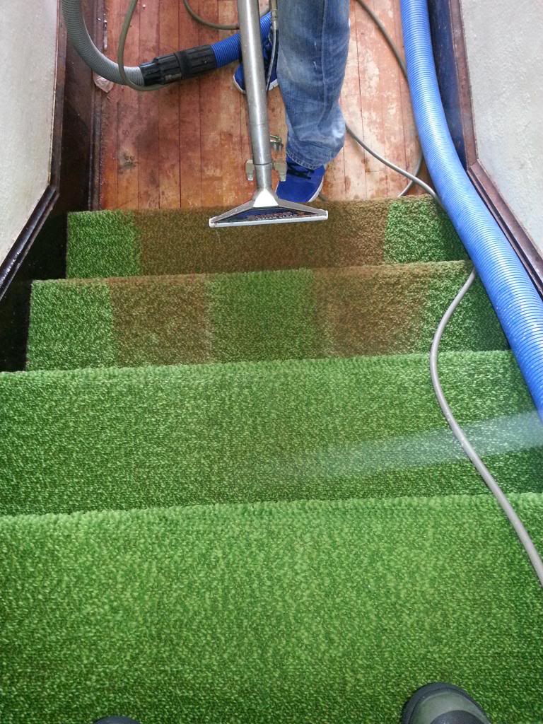

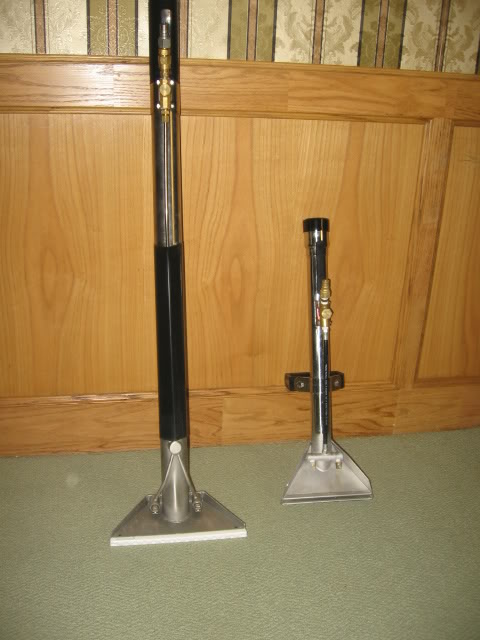

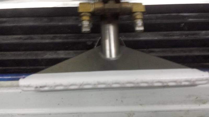

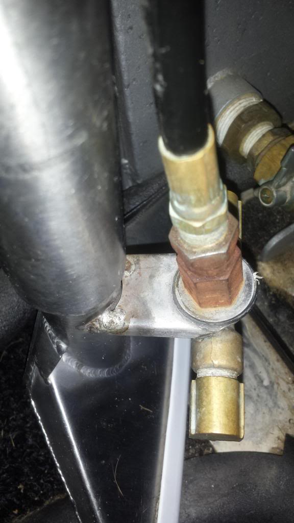

Here is one of our 2 stair tools with swivel head. They are terrible with a single jet in my opinion, but with (2) 80015 jets, a Hybrid Greenglide and soft pull trigger, we do love this tool.
One I had built by PMF the other I got from John Olson. The first one I got has 1/4 inch size jets, the one from John Olson has 1/8 inch size jets with adaptors. Both work great. I am thinking about ordering 1/4 size for both and then experimenting with check valve extenders as well. Just on my "To Do" list and haven't got to it yet.

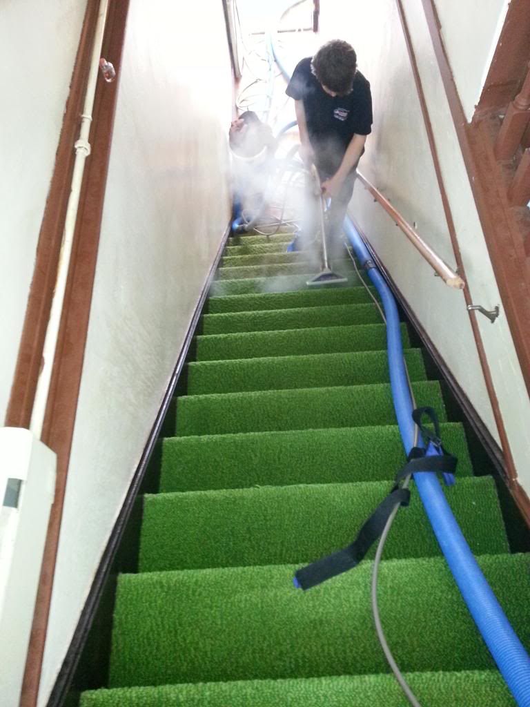

Flushing out Red Iron Ore from steps (not really easy all the time)

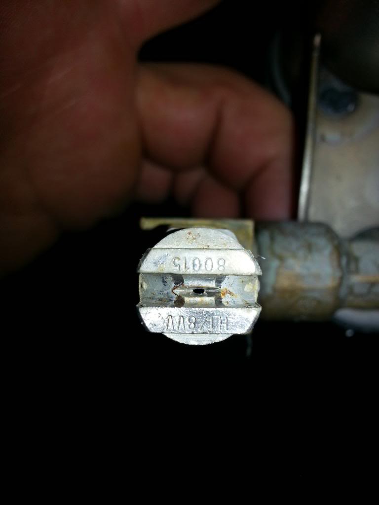

Before new jets were replaced for this worn out jet (we took the pic to get the correct jet number at the time)
Link to the video mentioned where Jeremy was cleaning a set of steps with it (brief looks at that at :25 seconds and :44 seconds.)
http://www.youtube.com/watch?v=9nOdeq6QWxw
