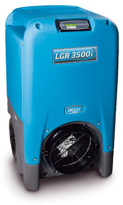

New Drieaz's New Dehumidifier-3500i
Delivering 170 pints at AHAM at only 10.5 amps, the LGR 3500i takes dehumidification to new heights. Built with the same restoration-ready, easy-to-transport design as the industry-leading 2800i, the 3500i delivers supersized performance and reliability. The 3500i is built for the tough environments found in water damage restoration, construction, and rental use. The rugged rotomolded housing and durable construction make this Dri-Eaz dehumidifier the number one choice.
Product Features
• Groundbreaking water removal rate – 170 pints at AHAM
• Displays inlet and outlet temperature and RH for easy monitoring
• Digital control panel with plain-English system messages, not codes.
• Wireless remote monitoring capable. Track operating conditions from any Internet connection with the HygroTrac Remote Monitoring System (purchased separately).
• Rugged Dri-Eaz rotomolded housing is easy to maintain and won't mar furnishings.
Product Specifications
Power 10.5 amps, 115 volts
Water removal AHAM (80°F /60%RH) 170 pints | 80.5 liters / day
Water removal Max. (90°F / 90% RH) 240 pints | 113.6 liters / per day
Process air 400 CFM, floor-level outlet
Air filter 3M HAF (Dri-Eaz part no. F421)
Use weight 165 lbs. | 75 kg
Looks like nice unit!

I am not a fan of the x-large LGR dehumidifiers. I think 110 to 140 pint LGR dehumidifiers are the sweet spot for most drying jobs. The cost of removing an extra 3 to 4 gallons of water (at AHAM), in purchase price and amp usage, would be better invested in air movers. An extra Phoenix focus or Force 9 air mover would evaporate more water from, and add more energy to wet material, drying a job faster. If more dehumidification is needed at the beginning of a job an additional large dehumidifier could be added during the first 24 hours or until the humidly is stabilized then removed.
There is also a big difference between moving (and setting up) a 135 lbs dehumidifier and a 175lbs dehumidifier.
5,856
Shawn Forsythe
The Dri-Eaz 3500i costs hundreds less, weighs less, and pulls 5% less amps, but is only rated at 6 pints less per day.
I think the tale of the tape is interesting, at the least.
yeah but shawn if you actually believe phoenix's numbers you are smoking crack, those ratings are total horseshit, if they are anything like the the 200 max ratings, that drieaz 3500 will pull 50% more than the big phoenix unit.
