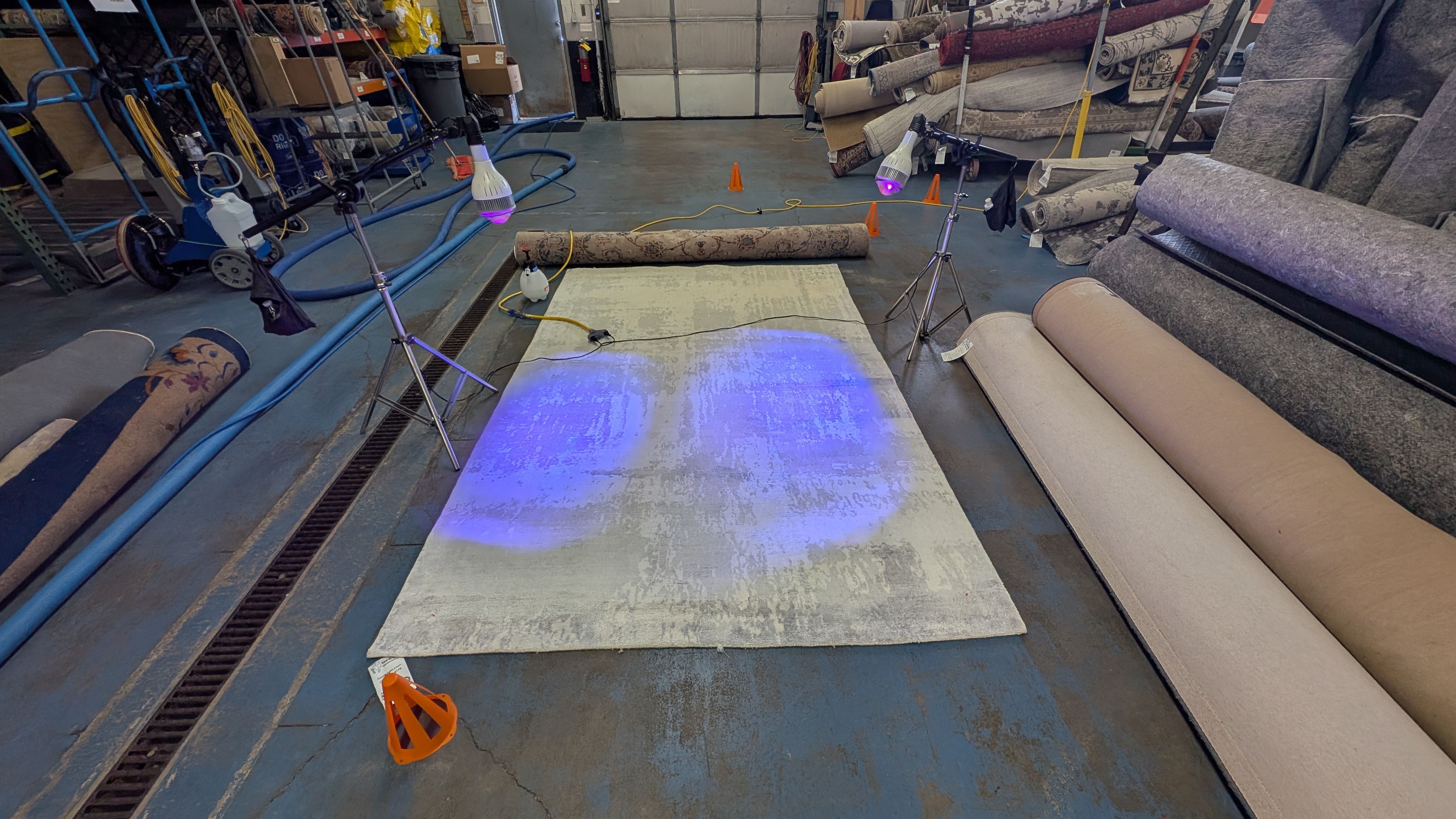

UV light helps if it's stubborn.. I haven't had a problem with multiple applications.....but it requires various trips..
Sani-Bright is big on UV
Yes, I'm planning to drop off a bottle of 3% peroxide and my UV light & invite the spiller (husband of course) to go at it carefully. UV was the only other safe thing I didn't use cuz of time constraint. I've left a light and spray bottle on site with (different) customer before & had good results. Thanks

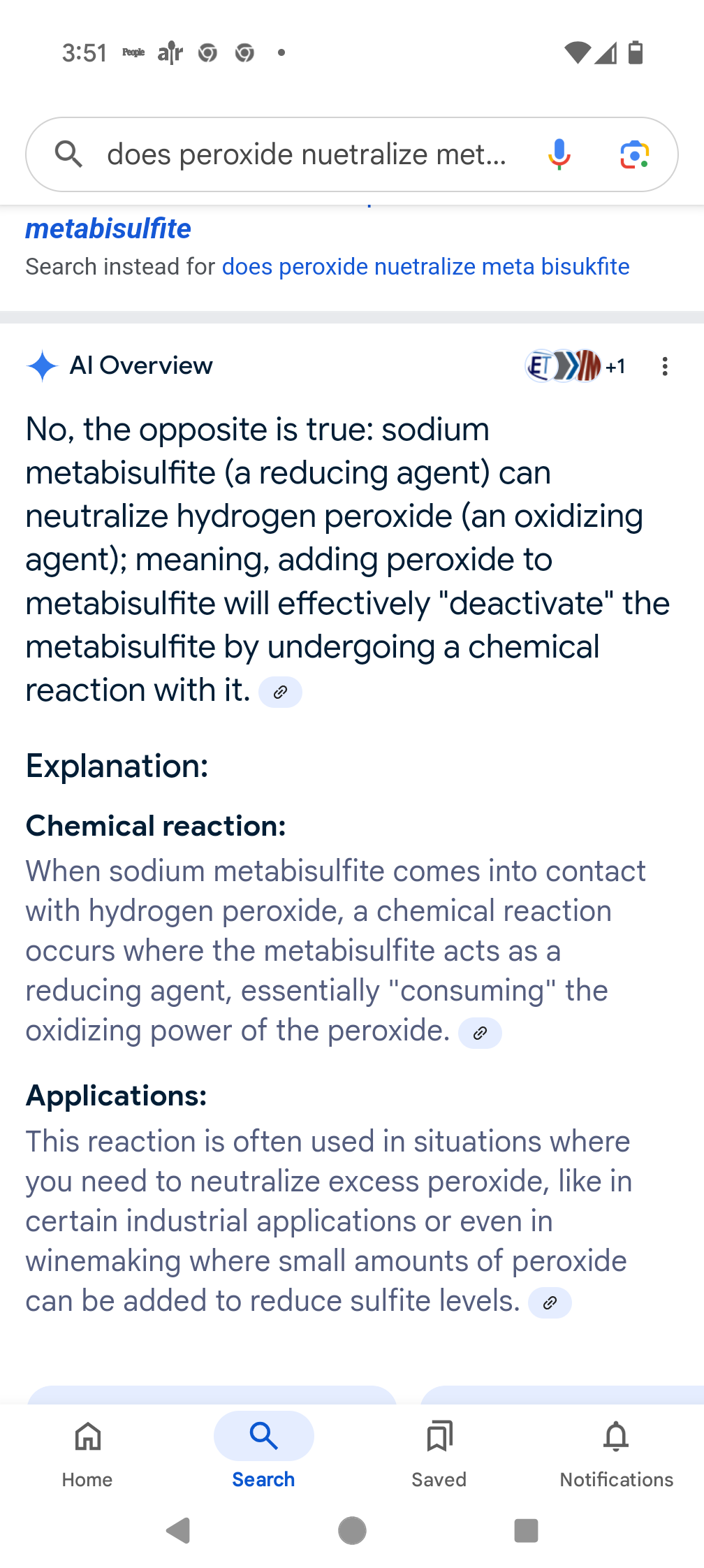

Decaffeination process often removes a lot of the natural color so they add artificial dyes to give it back that dark rich look. We also find artificial dyes in some red wines. Often the vinter can't get the color they are looking for naturally, so they add a little coloring. Usually an oxidizer will work well on red wine but if you find you are struggling with a stain, try a reducing agent and see what happens.
