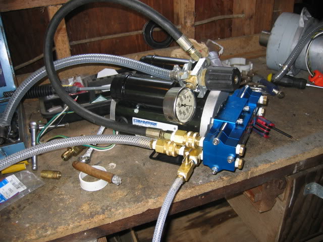

If you want to inject chemical into the solution tank, just interrupt your water feed at the intake with a dema valve, and siphon the chemical in. If your dema valve acts up it's an easy fix outside the machine.

Looks freaking complicated! :lol:
That's what I was thinking, plus you're still passing the emulsifier, or whatever else you plan to add, through the pump. Running an inline avoids that, saves your pump.
Bjorn
2,450
ah bull shit a little dry slurry thorugh the pump is not going to hurt a darn thing

challenge with running your inline sprayer inline with the wand
you don't get the flow to the wand. Those inline sprayers have a very small outlet. Ever take the end off and spray directly out from one? Just a thin high pressure jet, but not a lot of flow. Works great for prespraying but I don't think it would be enough for a wand.
