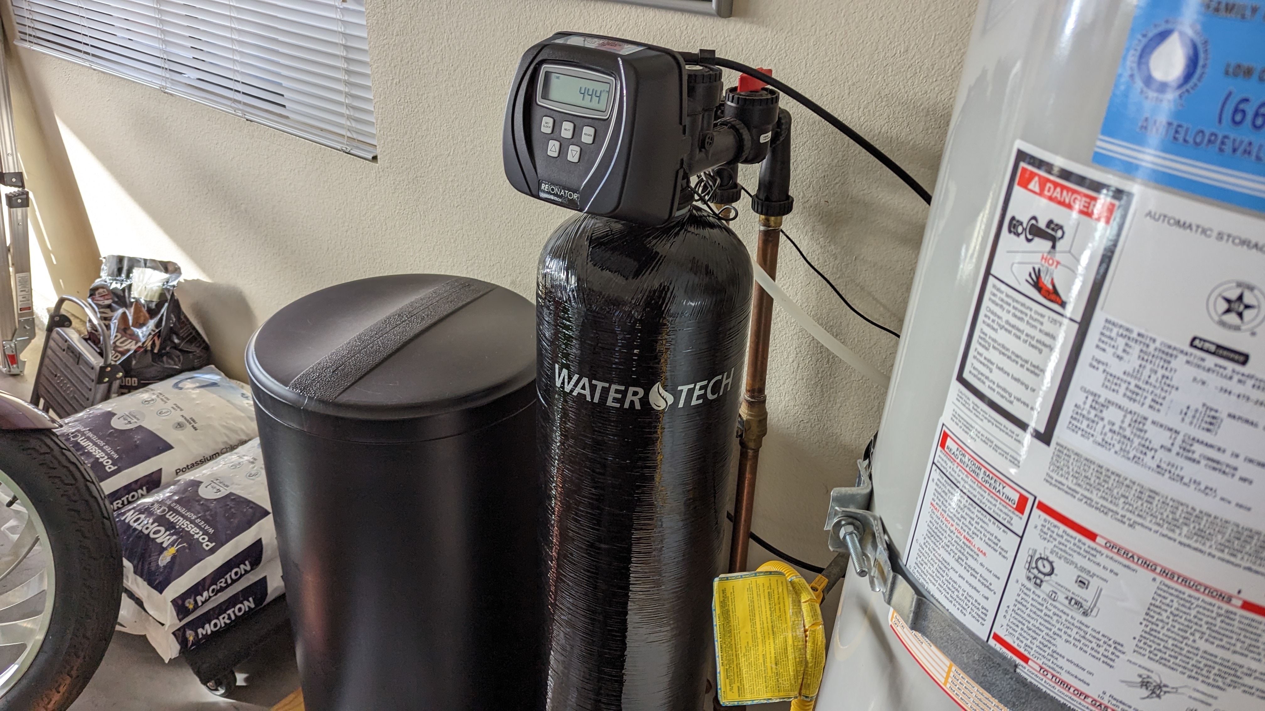

I asked could it be here water softener ?
No I use potassium chloride.
I ended up going to the water softener and pulling a pellet out and it's pretty salty.

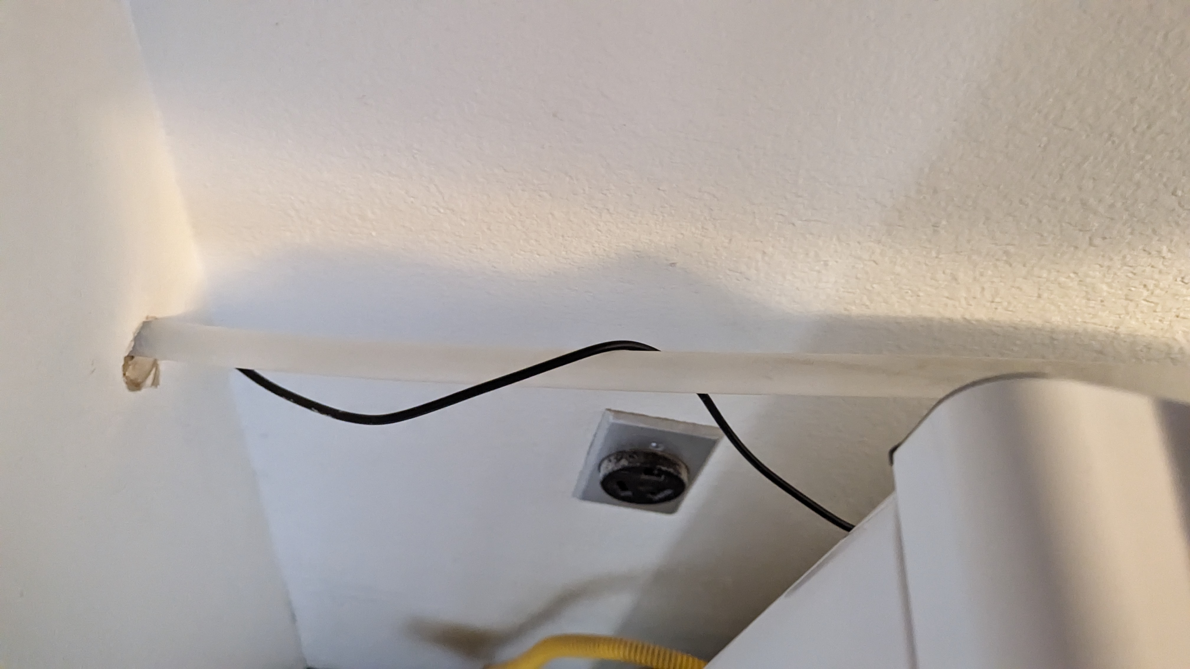

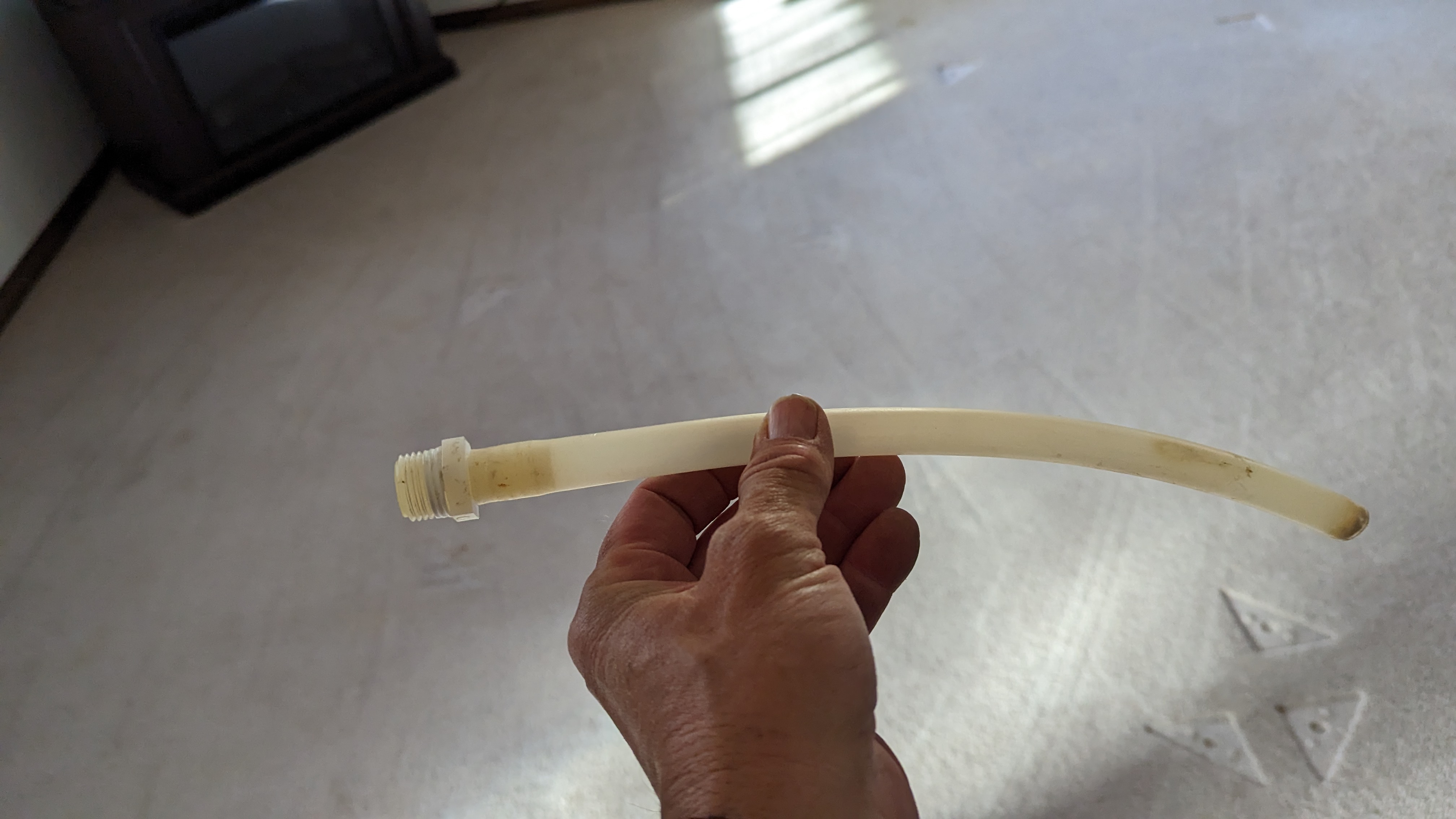

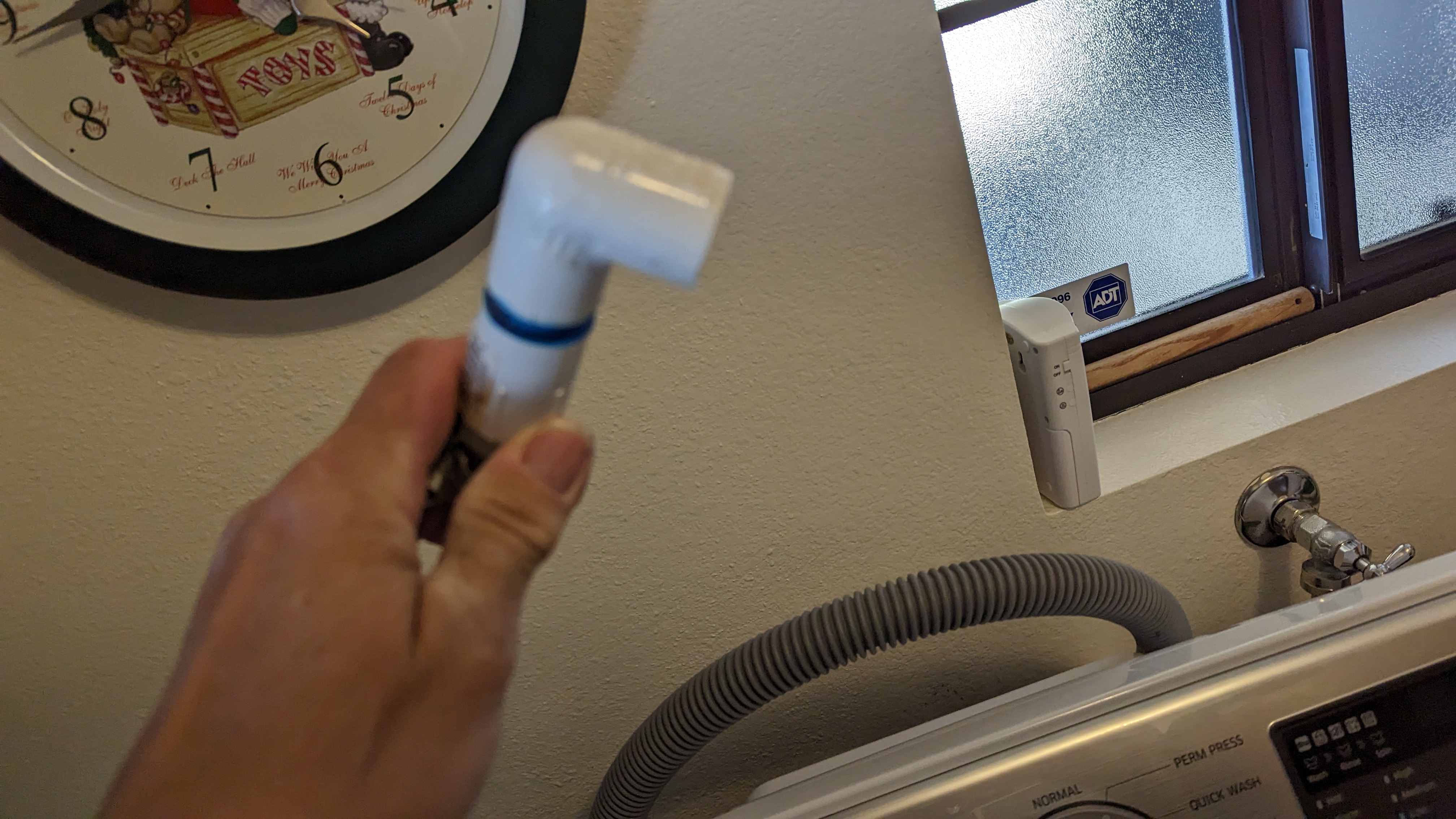

So then I follow the tube for recharging it through the house to the drain in the washing machine.
Sure enough the plastic elbow snapped and the hose was hanging loose.
It recharged when she was gone and leaked water into the house.
