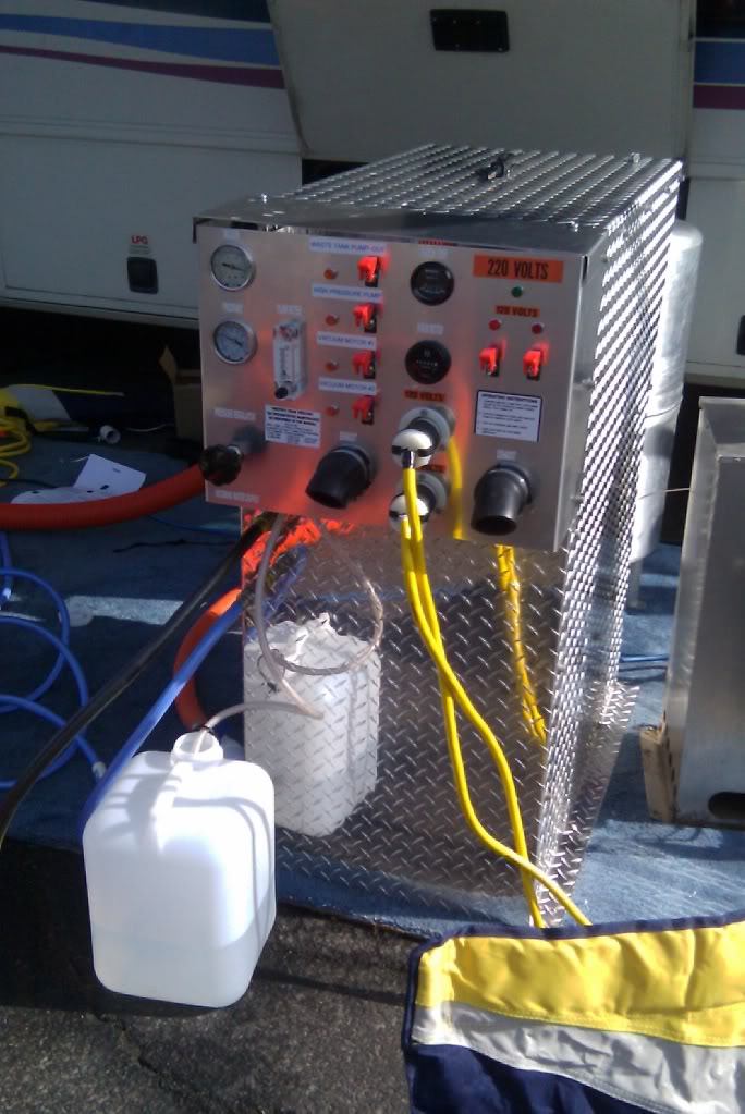

Odin’s electric machine was very impressive. I always thought it was a piece of crap, but after seeing it in person I would use it any day of the week. With the 2.5 inch hose the suction was just like any other truck mount and the heat was great as well. It was also very quiet which I liked. Any cleaner that is a so called green cleaning company would be out of their mind to not get a machine like this. I was very impressed.

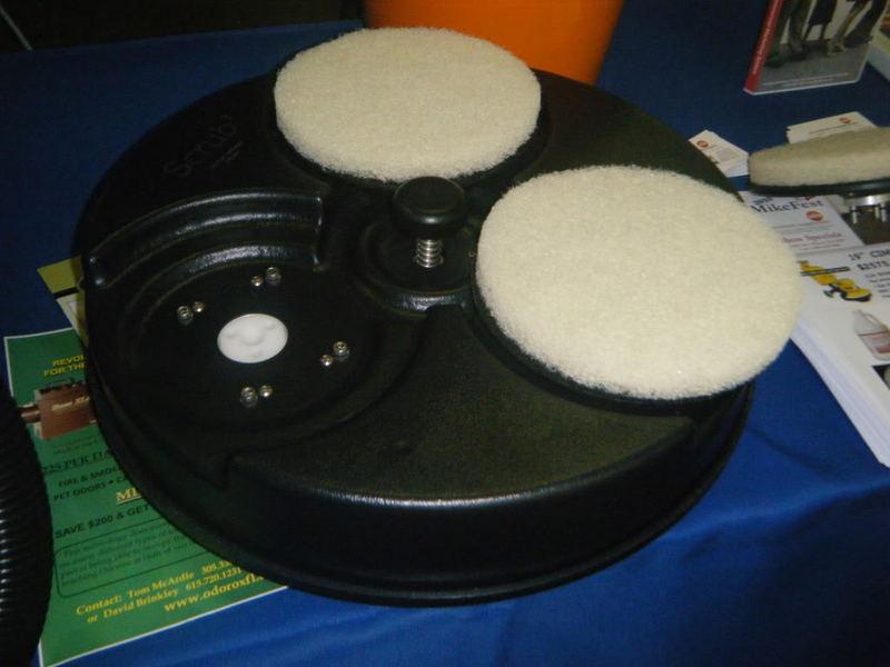

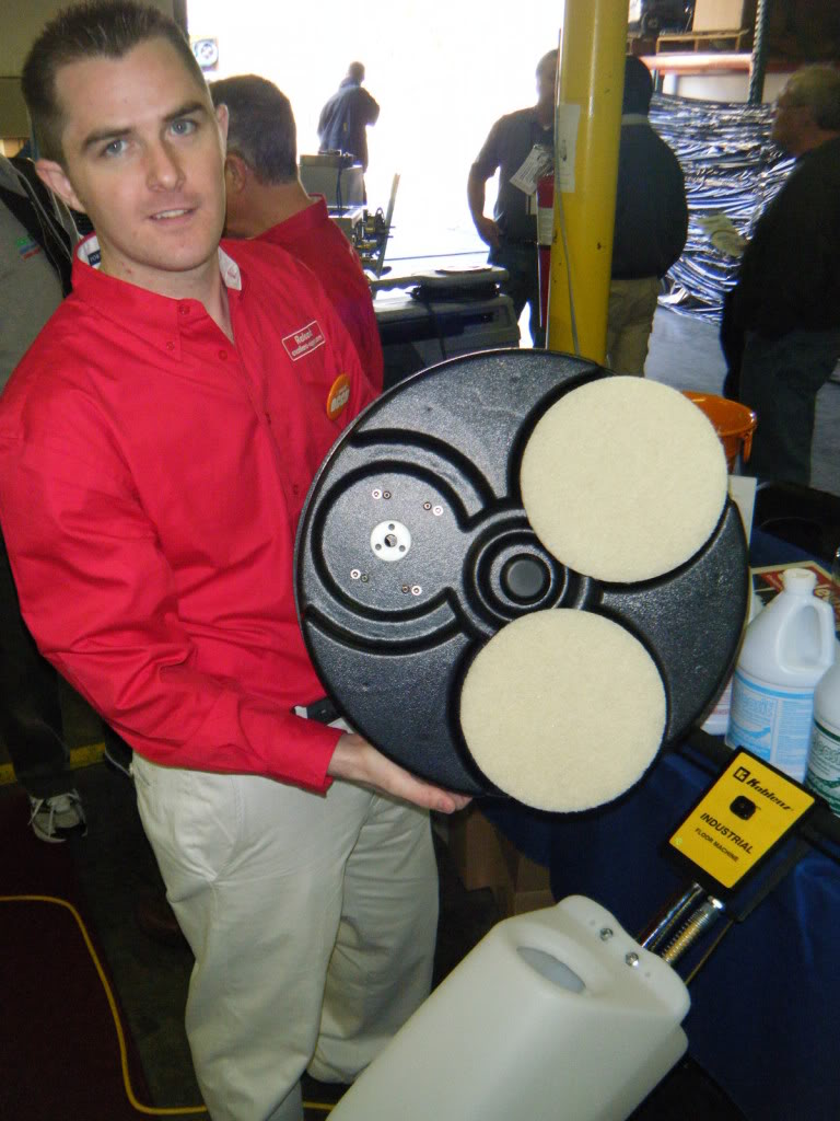

The neatest tool at the show was excellent supply’s adapter to turn a standard 175 into a cimex. Actually the cimex turned more slowly and the adapter gave more agitation. The cimex though allows you to just push it and the 175 has to be swung. It was impressive though.

I received a phone call regarding that tool on Friday night, I think. Ricks tool, I'm talking about. He said he was impressed with it, but that it was priced at something like $600 and was made of plastic. ?????????????????

Its out now. Retail is $695 but the MikeyFest special was $595. I brought one home with me and will report back after using it some. Daniel mentioned that you have to swing the machine but actually Rick Gelinas said it is best to just walk it forward and back like the mex. It is plastic but this thing looks very durable. I don't do a lot of commercial and since I already had a good 175 it seemed like a great option.

In respect to Terrys TM. Its a nice looking machine but its on diamond plate overload. IMO it would look better without so much of it, and probably cost less to build also.

I have to say Terry's unit,the C-4 ,and the predator unleashed were very impressive as well as Billy hick's aerotech.I also thought the Zipper wand was cool.I saw the new prochem fans (I believe thats who the new fans belonged to) and was not impressed at all.They seem to blow no better then the small $70.00 dollar blowers Sams club sells that are manufactured by Lasko.It was really cool to see alot of equipment in action and be able to evaluate it first hand.
Seeing things in person is best. I really liked his machine. It was simple, very quiet, great heat, and plenty of suction. Like I said earlier anyone that feels they need to spend a hundred grand to have a 200 gallon waste tank or calls themself a green cleaner and drives a tractor trailer should look at getting a simple easy machine. Would this machine work for apartment cleaners? Not now with moderate fuel prices. For upscale residential it would be perfect. Then you could really claim to be a green cleaner instead of saying you use planet guard and recycled paper in the printer.

I didn't see you or I should say recognize you. Could someone post a pic of Doug? I guess everyone likes what they like. If I have learned one thing, it is to never buy a tool or just go on board hype until you demo it. I liked it but maybe a little too much stainless. I guess that is for looks. It is supposed to resemble a tm so I can see why T put all the stainless on it.

Terry said the unit he had there was a proto type. He now makes the package much smaller. This would probably help the look(reduce the amount of diamond plate). He said the current model uses the same instrument panel but the rest of panel are smaller. There was a lot of unnecessary space inside.
