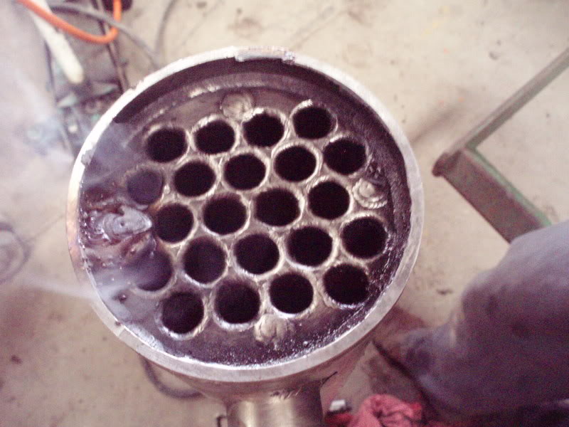

I made the terrible mistake of not checking my helper's work and my lower HX paid the price.
So..

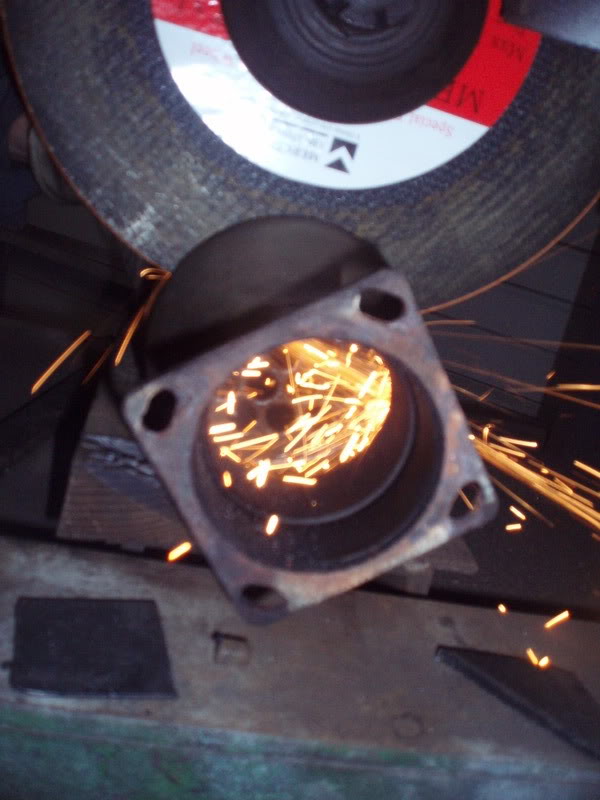

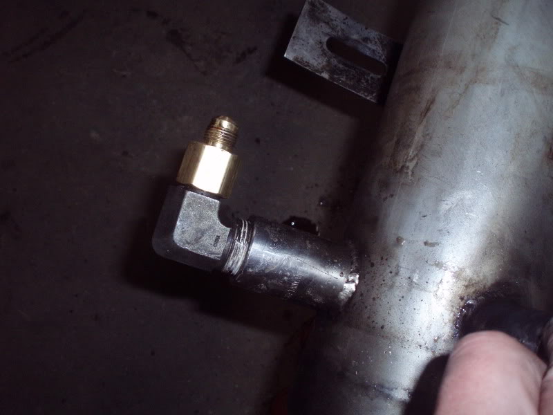

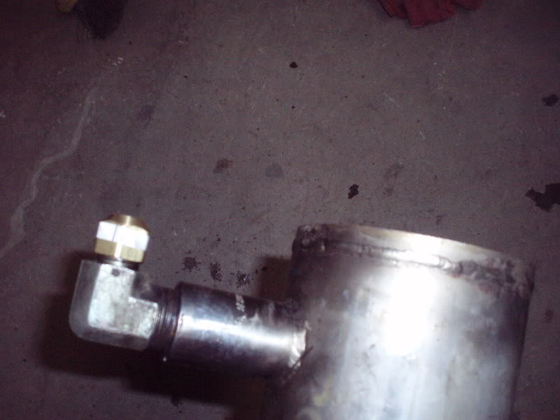

We pulled it off, plugged up one oil port and fitted a air gun friendly port on the other..

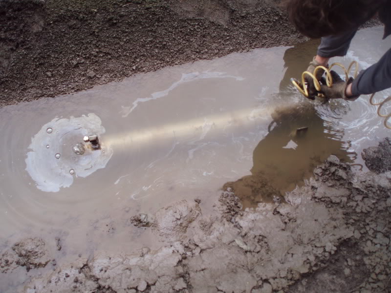

Then we placed it in the only body of water we could find and used a air compressor to put the internals under load.

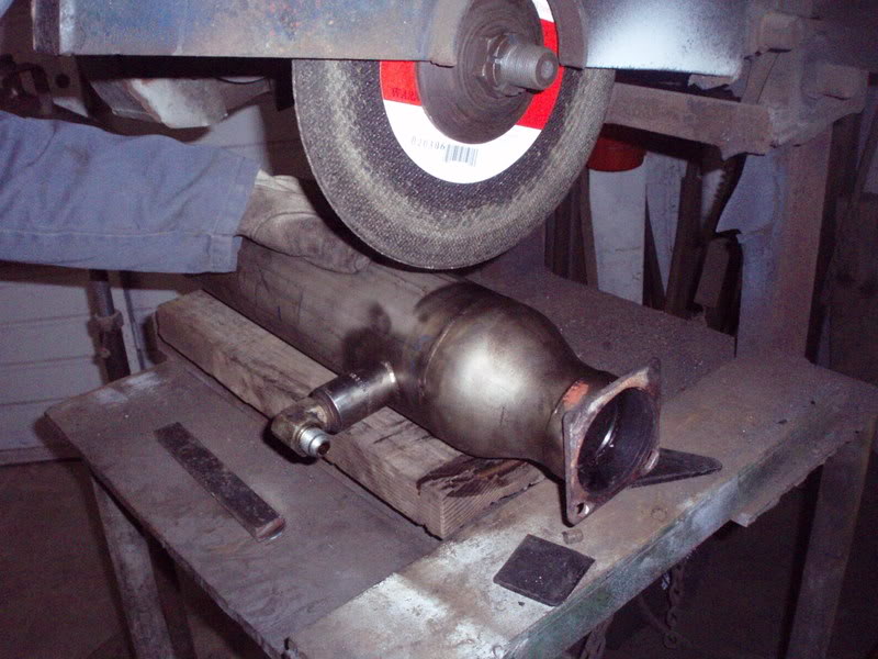

The cracked tube bubbled up with guilt so we then cut off the reducer that goes to the EDV..

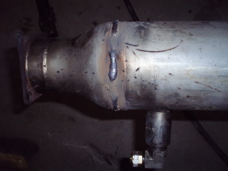

And then welded up the damaged tube on both ends

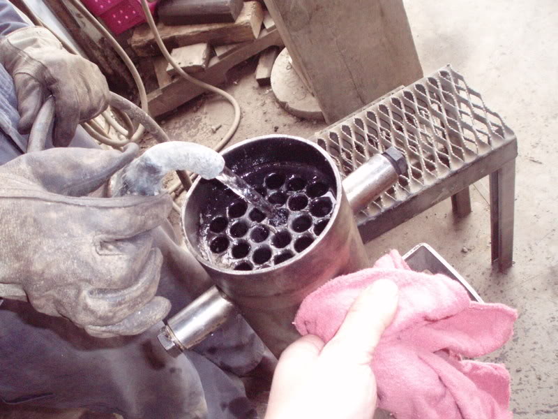

We double checked it in the mud pit out back and all was good so we gave her a bath

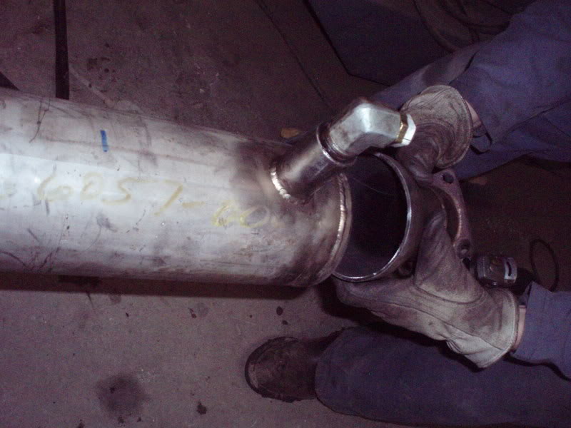

And then welded the reducer back on and tomorrow I will fit the HX back on the Worlds Most Dependent On A Properly Working EDV Cleaning Machine.

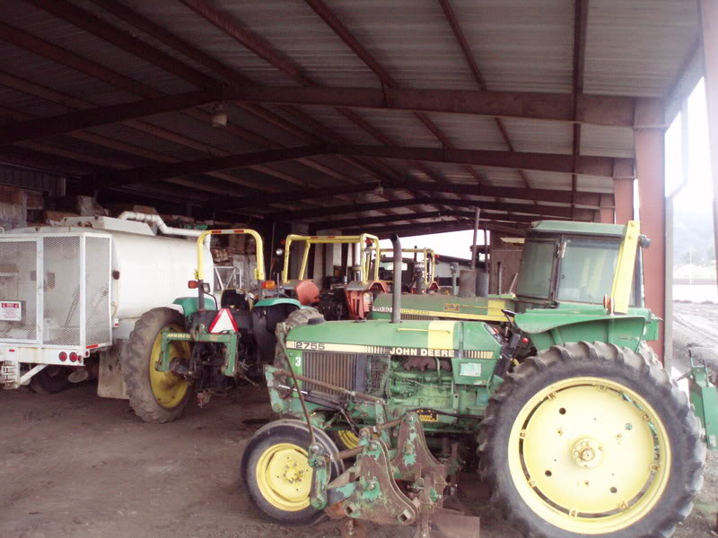

Its nice to have a good pal with a farm...

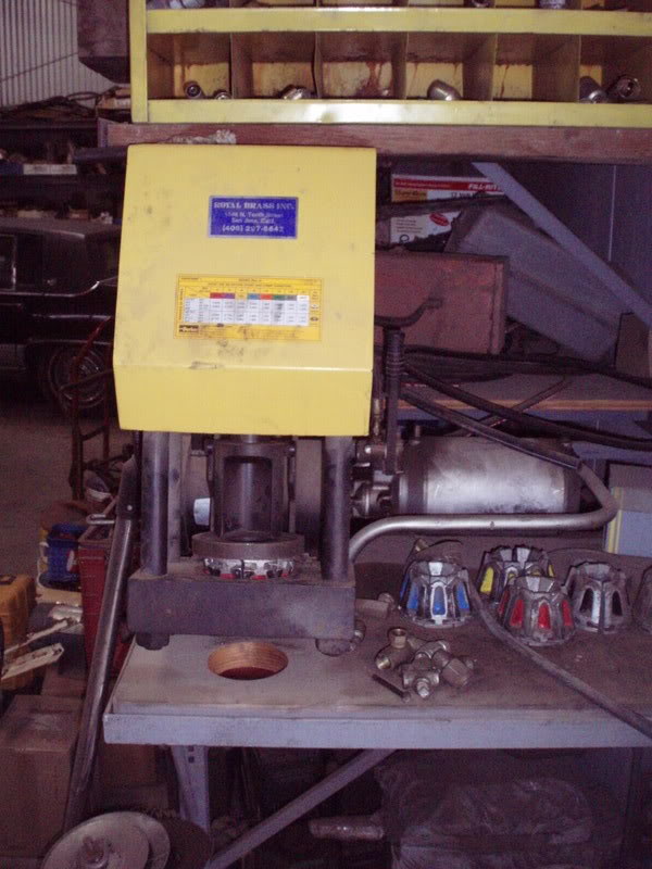

He even has a Hose swedger.

No way you could replace the individual tube instead of welding it shut? A die grinder and ten more minutes work, as long as you already had it open.
