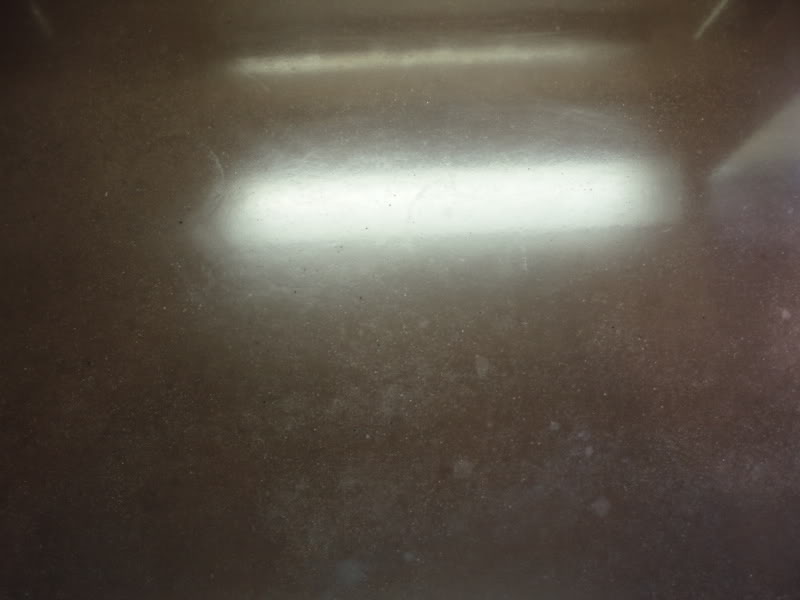

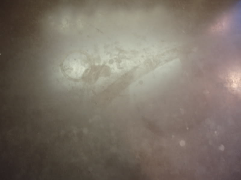

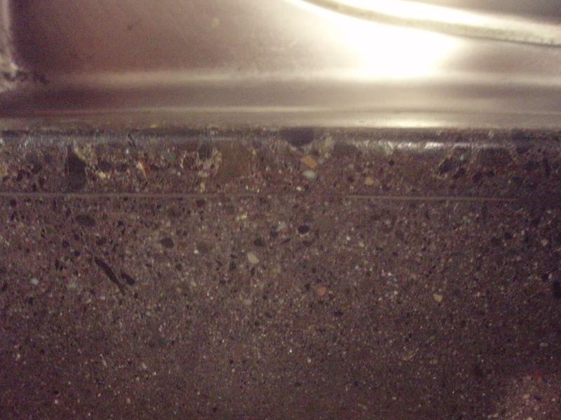

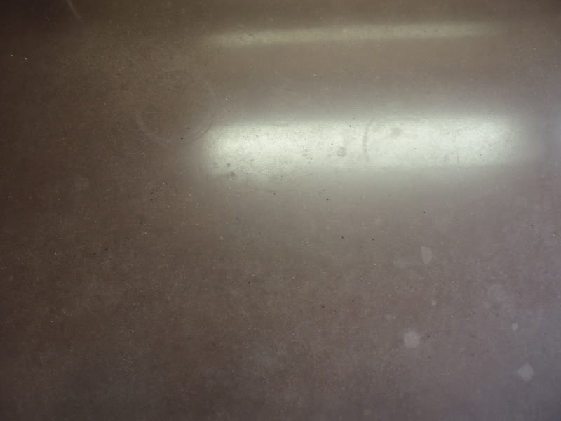

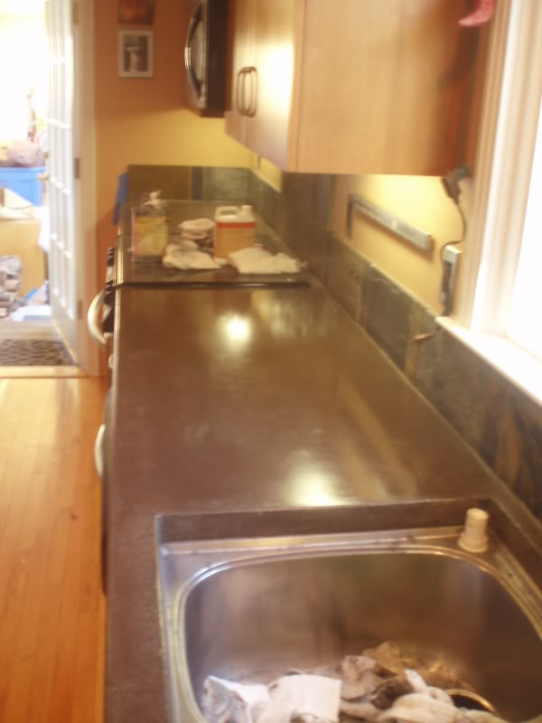

Before (five years old, only penetrative sealers, lots of deep etching but no stains.)

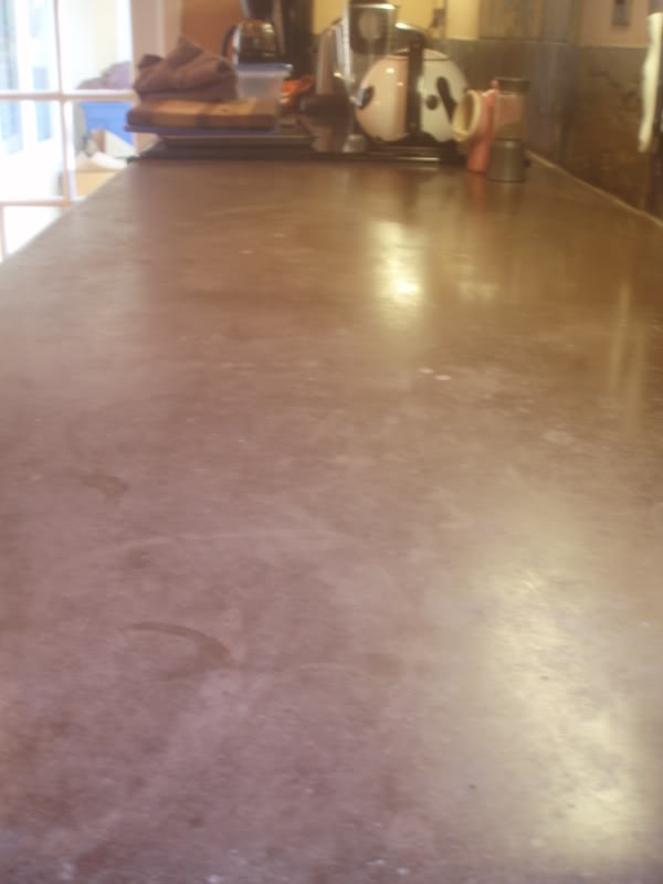

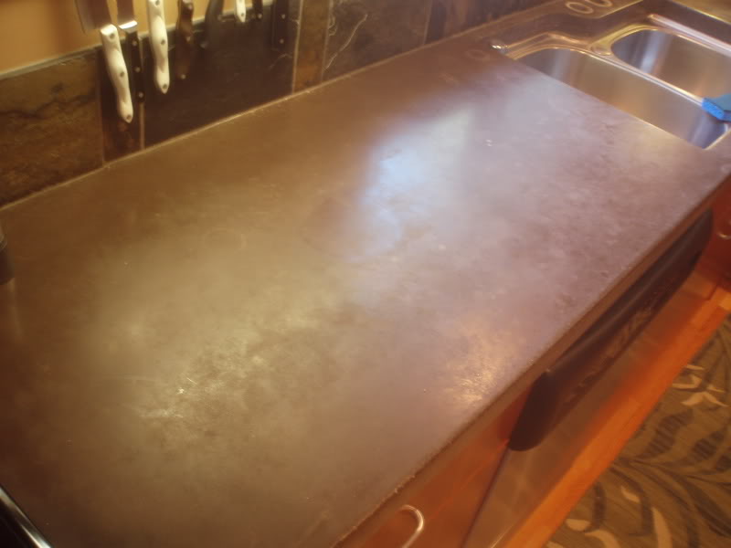

After a round of Monkey Pads (400 -11,000) Didn't get all the etching but looks way better.

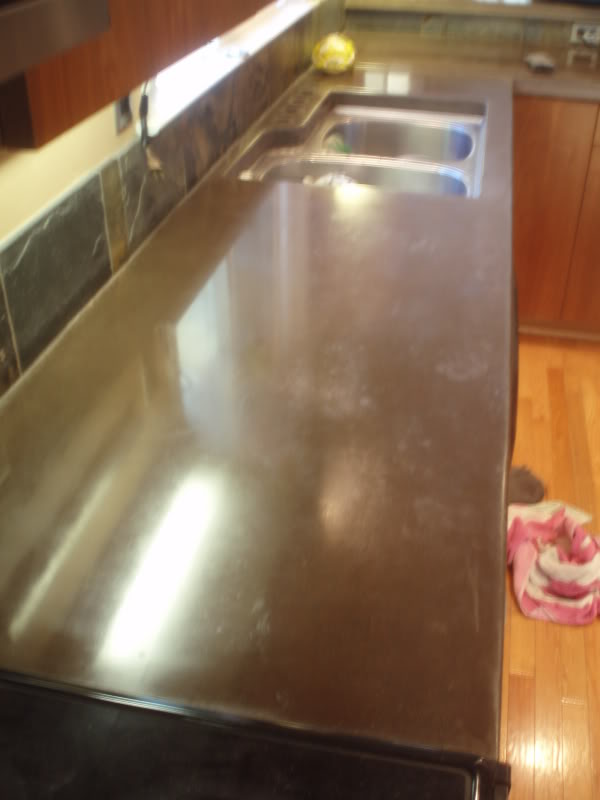

After Enhancing and Monkey Waxing.

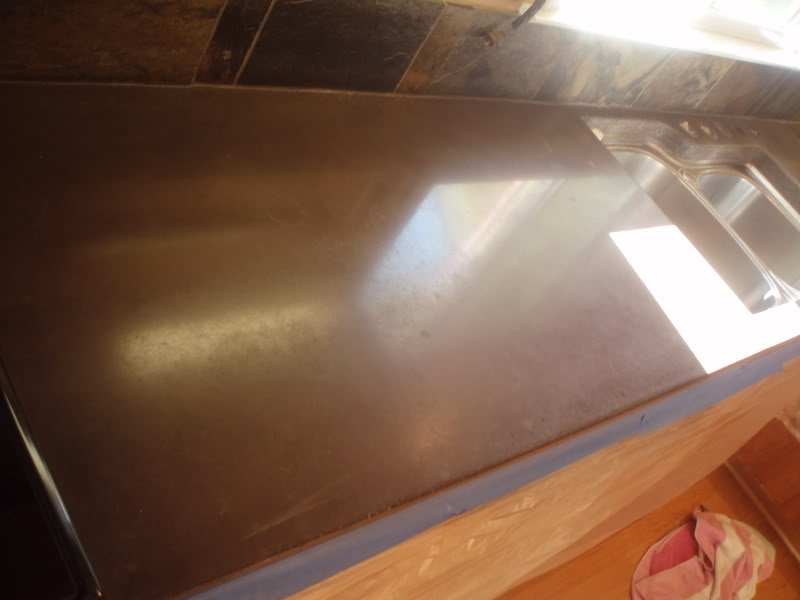

After Padding and Enhancing but before Waxing
After Waxing..
I'm hoping the Concrete specific pads dig a little deeper.
Have to be careful not to go too deep or you'll expose aggregate.
Etching is a fact with Concrete counters.
Got to learn to embrace the wine glass rings.

Hey Mikey,
Nice counters. Did you make them yourself? There is also, a great sealer made by suface 519 called E32K looks natural and is chemical stain resistant. Great job and looks good!

whats with the nasty rags in Mrs. Ps sink????
seriously looks good....shoulda got some diamonds and used a orbital on it, then you could have gotten the rings...
and a 11k shoulda made it pop more then that...
