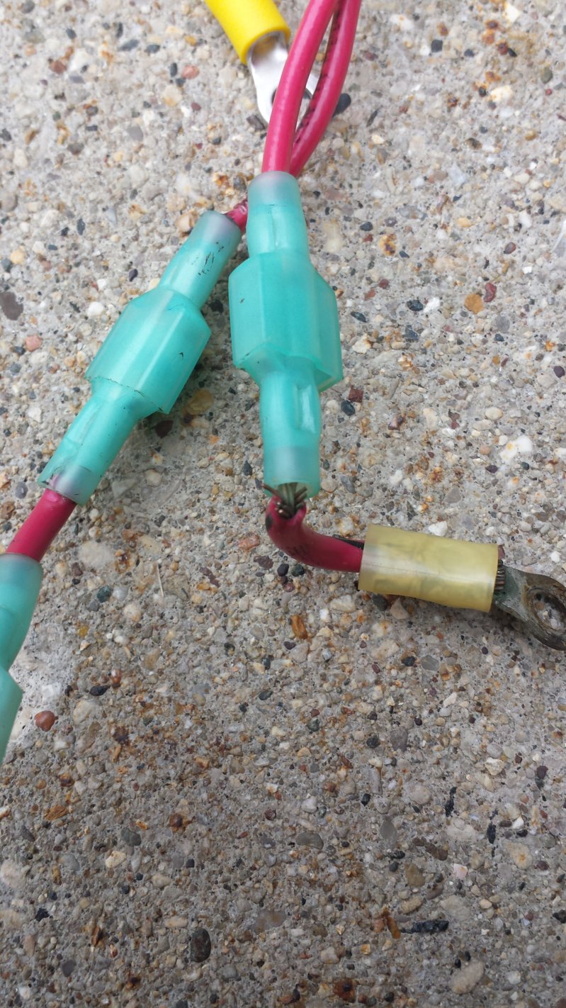

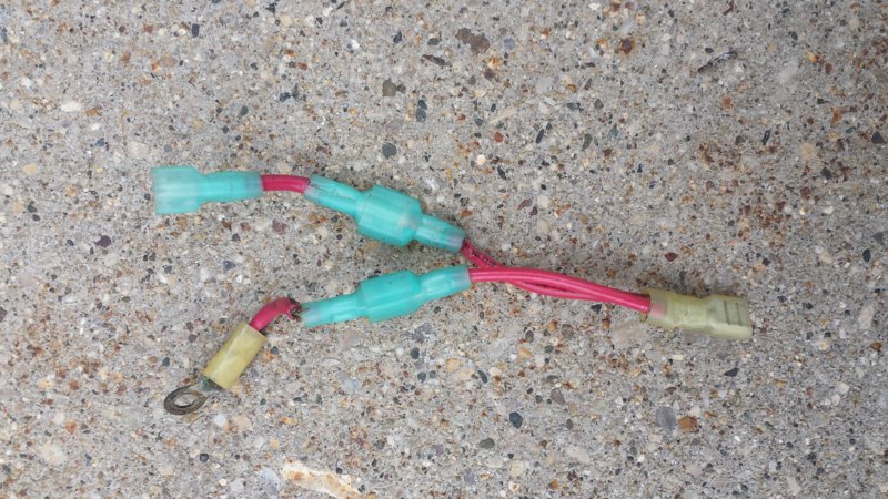

it was just a simple switch back out a relay and hook a ground up to see what it did...
I didn't think that was to confusing......if it did not change anything..plug back in the new relay....

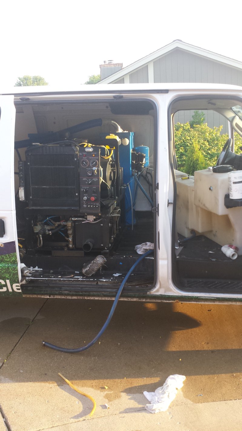

OK, I put the new oil pressure switch in today and the electrical is back to normal, :rockon:but still runs rough..
There is a ground that goes from the negative batt. to a engine mounting bolt..
I'm going to mess with the fuel side after a big commercial job tomorrow.. I'm going to use it mostly for tile and my other van will do the carpet.
A
Able 1
I think I got it!! So when I put it under load the governor doesn't move, and if I physically move it the belts even out.. I grabbed it and it all loose and you can pull it about a 1/4 to 1/2" out of the hole..:headbang:
