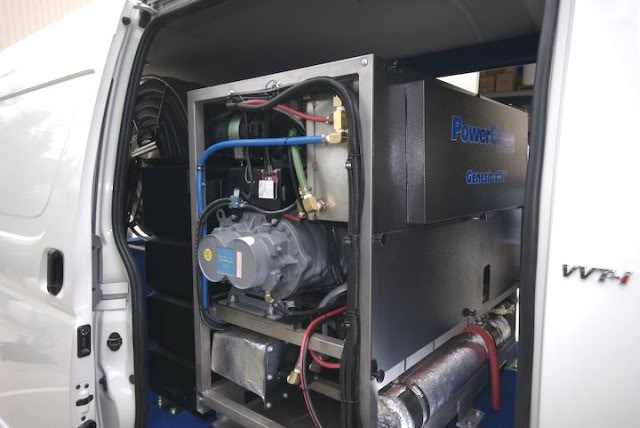

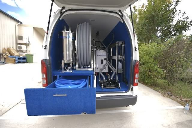

This again is a Toyota Super Long Wheel Base - yes this is one of the larger vans we get access too here in Australia before you really need to fork out for the larger Sprinters and Iveco vans.

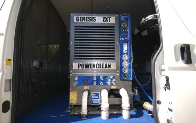

We installed the new Genesis ZXT into it and ducted the exhausts through the floor with underbody mufflers.
These are one of the few vans we have down under that have dual sliding doors. Make servicing the machine a breeze with the second sliding door.

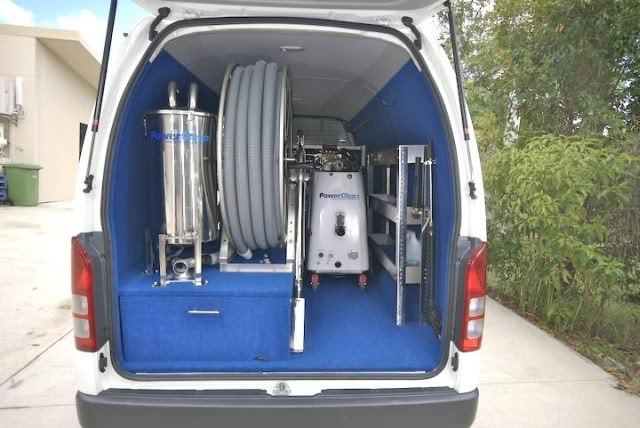

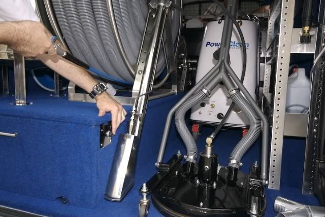

This is looking in the back door of the van. This van and machine have been set up specifically for hard surface cleaning. You can see in the right hand side mounted against the stainless chemical shelf is a high pressure lance and also the foam generator attachment also.

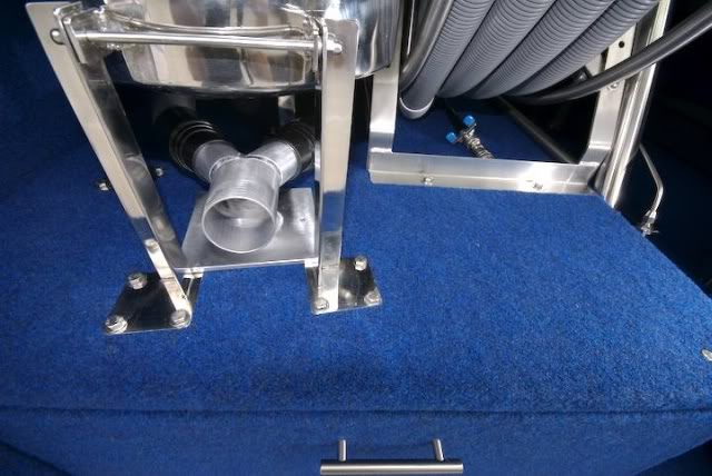

We have made the suspended drawer with enough width left in there so we can wheel in our high pressure portable (1000 psi with 2x3 stage vacs) which you can see. Sitting in a bracket affixed to the stainless steel vac hose reel is our edging tool, and of over the far right hand side is the larger external waste pre-filter to stop the larger debris reaching the vacuum tank.
And yes, we have plumbed this rig for 2.5" hoses.

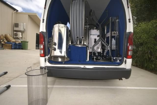

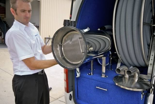

When you go to empty the stainless pre-filter, it is as simple as unclipping three hold down brackets, then the entire filter pivots over and outside the rear end of the van.
You can then place the rubbish from the mesh cage into a bin, and hose out the rest of the tank whilst it is upside down.
We mounted the high pressure solution hose at the back of the vacuum hose this time. Being electric wind up, we don't have to reach back and wind it up by hand, so essentially, we could mount it wherever we have spare room in the vehicle. We just press the button and it winds up from underneath the vacuum hose reel.
This is the final shot of the rig showing the hard surface head in place and also the sliding drawer being filled up with extras.
Jim

John Middleton said:
Damn, all that work and still not a solid HEAT and VAPOUR barrier between the cab and the back!!!!!
Good job mate, just yankin ya chain :lol:
John :lol:
Hi Johnno,
Your starting to sound like Ash now :wink:
If you have a close look in the second photo down, you will see there is the normal cargo barrier in there. However, if you see up in the corner and all the way around the edge of the actual van pillar and roof a black rubber strip.
It is hard to see on the photo, but there is actually a thick sheet of perspex inserted in front of the cargo barrier which has been completely sealed with a thick rubber gasket all the way around. It actually looks like a Toyota genuine part the boys have done it that neatly - even if I do say so myself :) So don't worry, there will be no heat or vapour reaching the cabin from the cargo area.

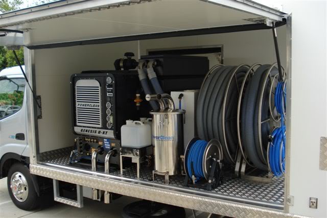

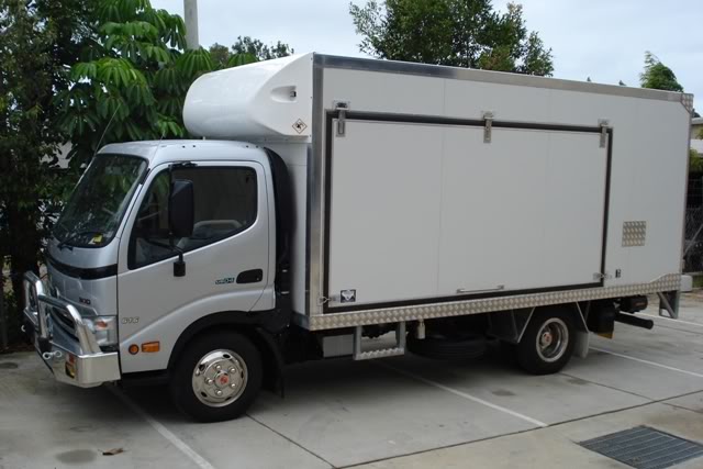

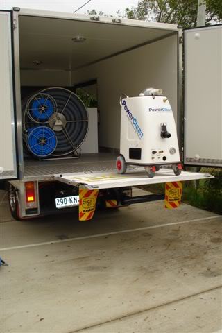

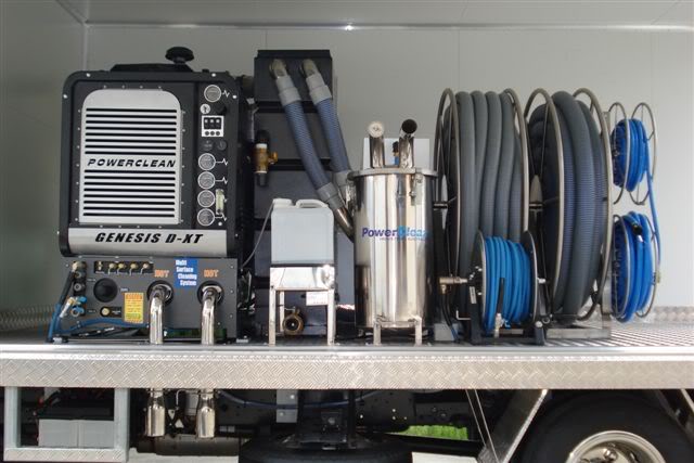

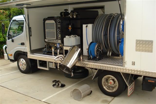

Here are photo's of a truck I put up in another post recently. This is our closest thing we can get legally on our roads and still keep a normal car license without going to a truck licence.

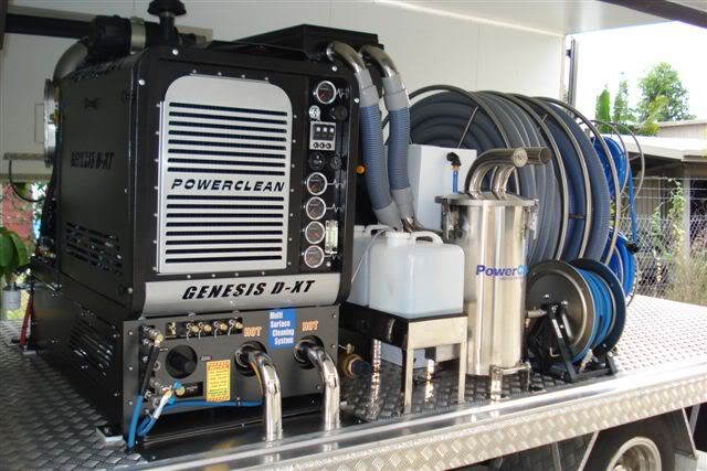

We have installed the new PowerClean D-XT Diesel Genesis
The D-XT has been been completely designed to handle 2.5" hoses. So we continued that train of thought on even to the external filter. It has 2.5" outlets as well (that can be quickly adapted back to 2" if necessary)

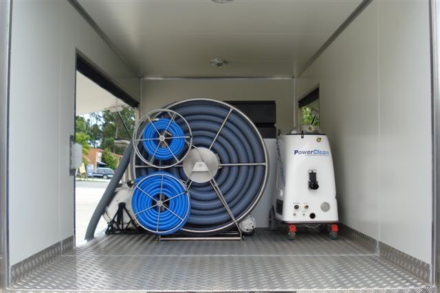

We put in a separate Stainless vac hose reel just to cater for the 2.5" hose. It holds 2 lengths of 2.5" on it. The reels are electric wind up as well with variable speed depending on the length of hose you have out.

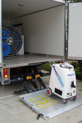

We fitted it with a tail gate loader as well to make getting portables, Cimex and dehums in and out of the truck a lot easier!
This rig isn't quite finished yet either. We are building racks that will hold 25 airmovers around the edge of the spare cargo area and then over the Vac hose reels. I will post more photo's when we are completed if you guys like.
This is a custom external filter box we manufacture that can easily pivot outside the pantec and drain. We make this for the guys doing external hard surface cleaning as well as flood work. You can see directly behind this tank is a 600 litre poly fresh water tank that feeds the Genesis on a demand system.

That is just insane. (means 'awsome' in yank-speak)
After seeing that, I'm cleaning out my van tomorrow and polishing my wands till they glow.

WOW. Awesome install. Can I get that filter basket over here?? I'm going to the Power Clean website right now to check. I'm in the process of putting the Terminator in a box truck and I have NO intention of using the old in line filter. They suck. Or I should say, they block the suck.

We say insane for cool things over here so I get your drift, thanks. :D And as you commented, there is a lot of polished gear in the back. Personally I feel any other tradesperson can turn up to Mrs. Piff's house and have a untidy vehichle/machine.
However, being cleaners, I think it reflects on us, so that is why we put a lot of work into making these rigs shine. And the best part, all of our clients that get these rigs keep them looking that way for years. They also have a lot of pride in their equipment.

The PowerClean USA guys don't have it on their website yet as far as I know, however they will have these type of things very shortly. They are a very progressive and forward thinking manufacturing company with some great ideas!

That is a sweet lookin rig. Is that a marine grade carpeting on the drawer?
When we do use carpeting, we rust proof the floor first, then use marine ply as the base, and affix marine grade carpet with marine glue to make sure with all the moisture and heat in the back of the vans, that our rigs still look great years down the track, not just while we deliver them.

That in-line filter, the external blower filters along with the internal cleaning jets in the recovery tank should eliminate any need to open the recovery tank.
What is the approximate diameter of the in line filter? Wondering if I have room for it.

Jim, the new installation pictures are just as awesome as the others that you have posted.Going back to the Toyota installation;is the carpeting glued directly to the factory walls or to the marine grade plywood?Also,if it is glued to the ply,do you attach the wood to the walls and then carpet the wood or do you carpet the wood and then attach to the walls?Thanks again and keep those installation pictures coming.
