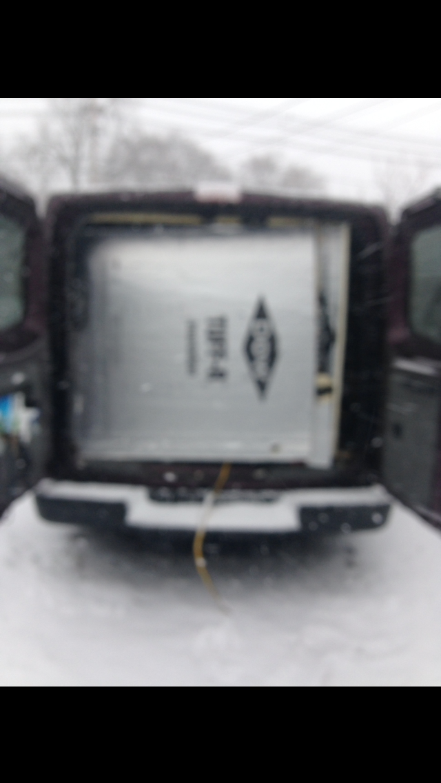

Tell me again what I should do with this 370?
It will be in our attached insulated garage..

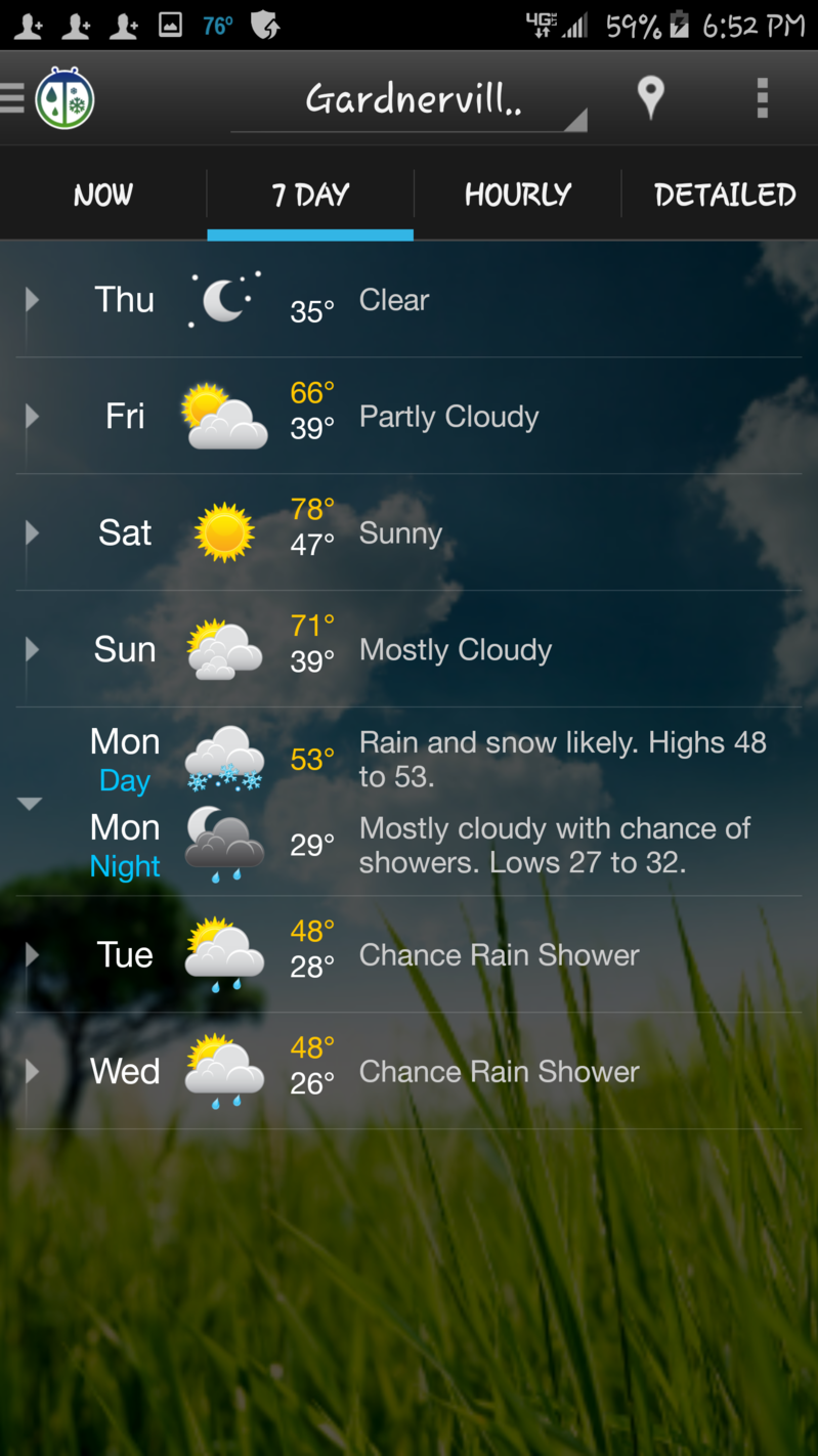

We have a freeze warning tonight. All the TM's in but one. Our north garage has fire contents we need to move into the building next week.
The one tm outside has a single heater in it. Mike its not single digits, run one heater just to make sure the temps don't drop too low in there. Your day temps are so high its not going to be cold enough to be too concerned yet.
That's not too bad really yet....
Inside your garage ....especially with insulation, just the heat from the van having been run will help, and setting some type of heater in it too a preventative can help....
But I bet you will be good....close all windows and doors too.
If you ran the TM for awhile before putting away, that heat exchanger and unit will help keep some heat in there too...

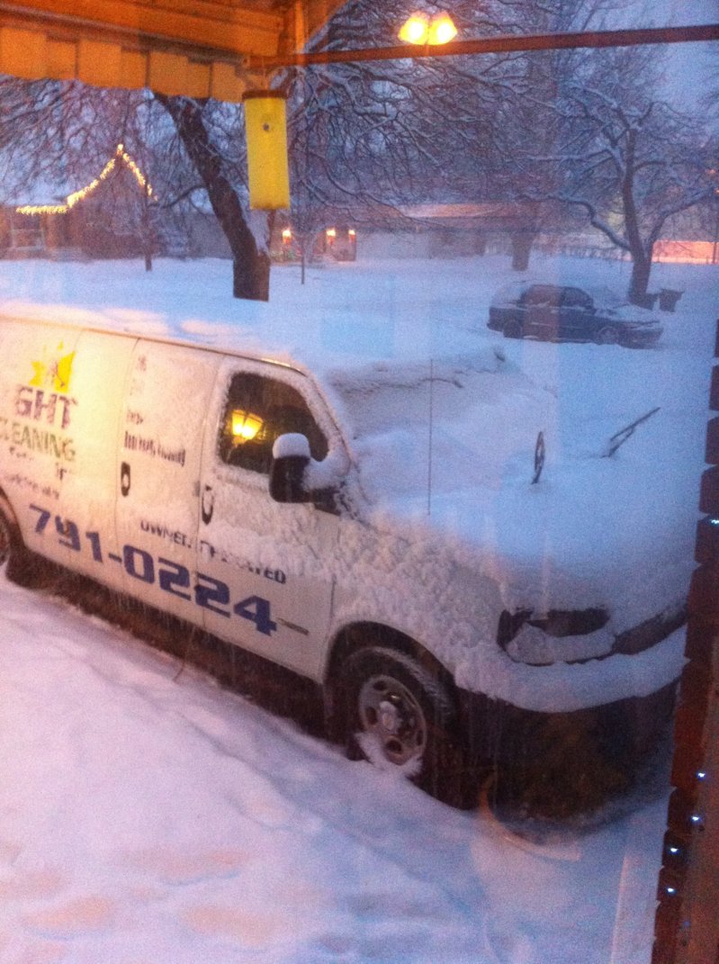

My 1st house I insulated the garage and didnt have to plug in a heater until it was less than 10 degrees out. This past wintewr was the first with parking outside and will be the last. Pluggin in the heater melted roof top snow then as the water flowed down the side - it froze the doors and wiper arms. There was like 2-3in of ice around the arm that had to be chipped daily along with chipping the door cracks to avoid bending the metal.
