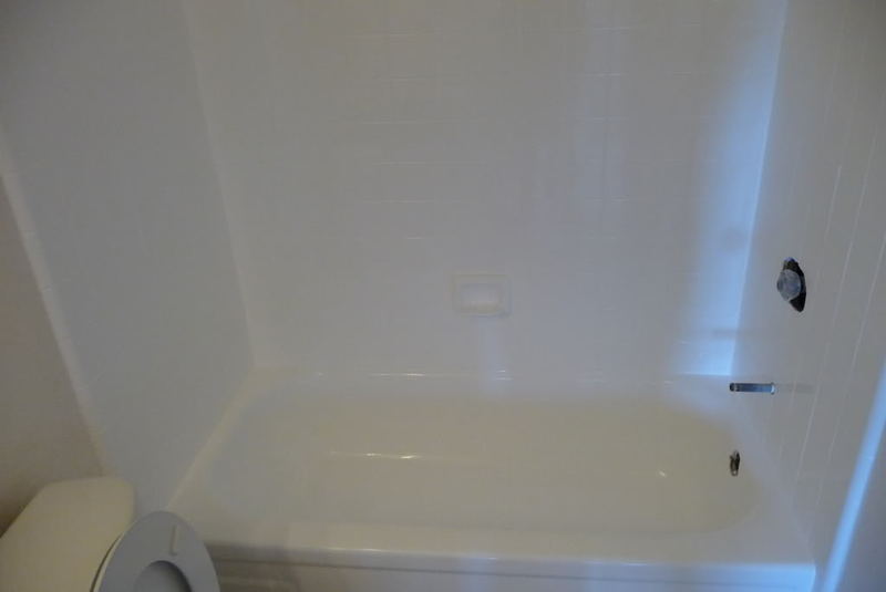

Have any of you any experience with this?
It was done on a shower stall at a section 8 I was at yesterday.
Looks great. Totally seals the entire surface with a epoxy.
I just have to wonder how long it lasts and how it holds up to doodle bugs and scouring.
