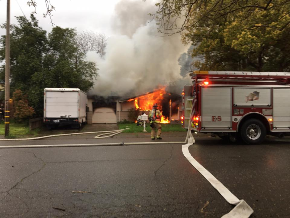

My buddy did this with a shopvac to his gas tank and burned down his house. Actual pic below of his house. Personally I use the harbor freight vacuum thing that is charged by an air compressor. Much safer.
14,079
Did you watch the video? The guys takes a moment to specifically say NOT to use this to suck gas
