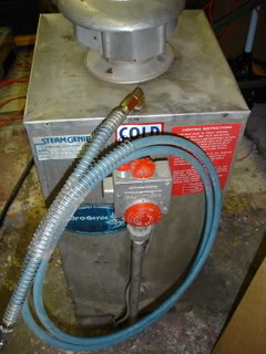

Here are pics of the two sides of the heater.
The first one is the Hot water side, notice I have the SafeConnect for hooking up your wand to.
The next shows the LP connection, followed by the warm/cold water supply line on top.

Thanks Greenie. The fitting they sent for the hot side does not fit in the thread. What size adapter do I need?
5,856
Shawn Forsythe
The outlet of the heater is 3/4 FPT.
Use a 3/4-1/2 bushing, and tee into the 1/2 pipe thread for the balance of the plumbing.

If you look close, you can see I did exactly what Shawn suggested. We actually assemble these kits in the pic to make it easy.
a T and some bushings and you are on your way, print my pic and take it with you.

Yup Doug, that is your oooooold Genie heater. and No I haven't done anything with it yet, but makes for a sexy photo model doesn't it.
