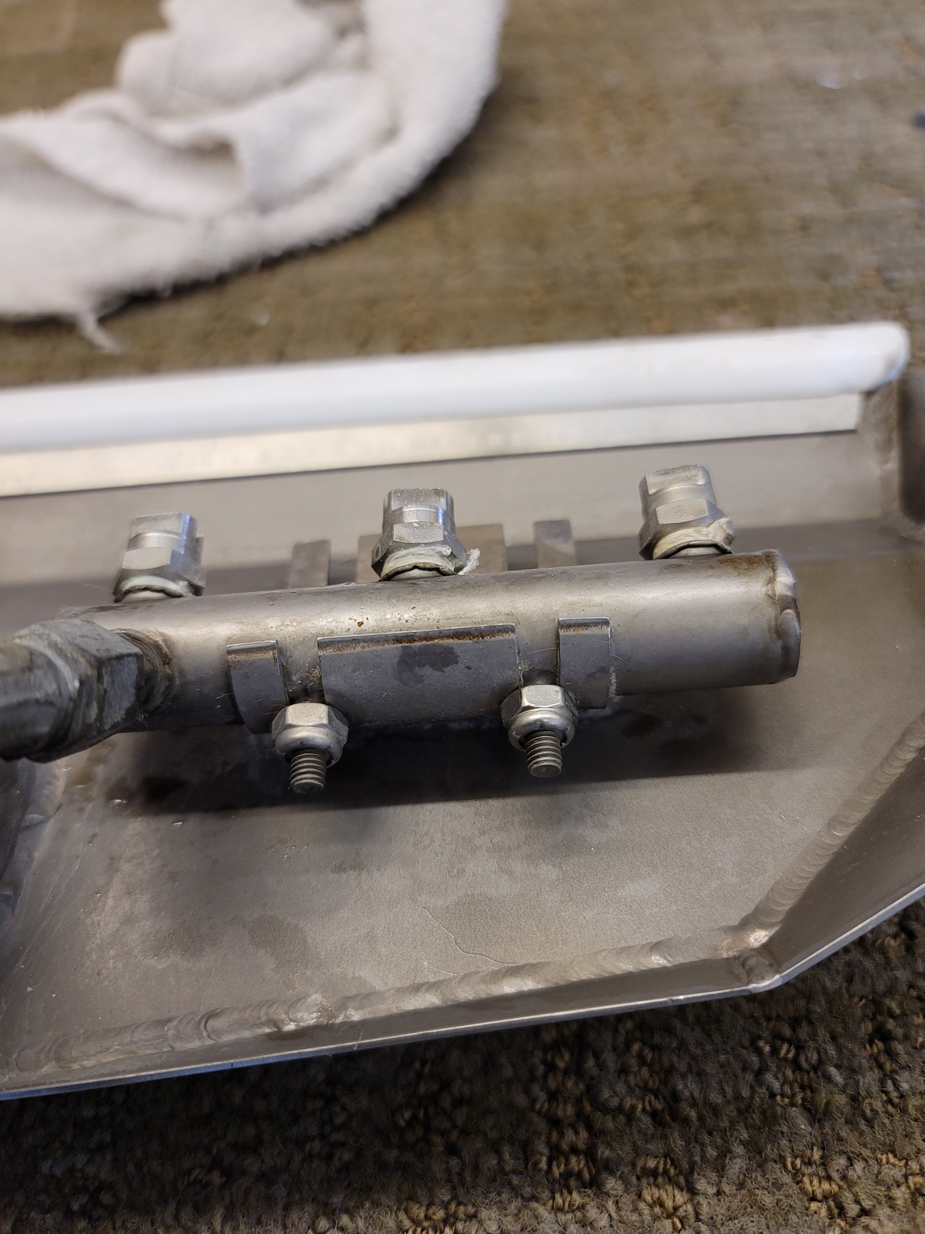

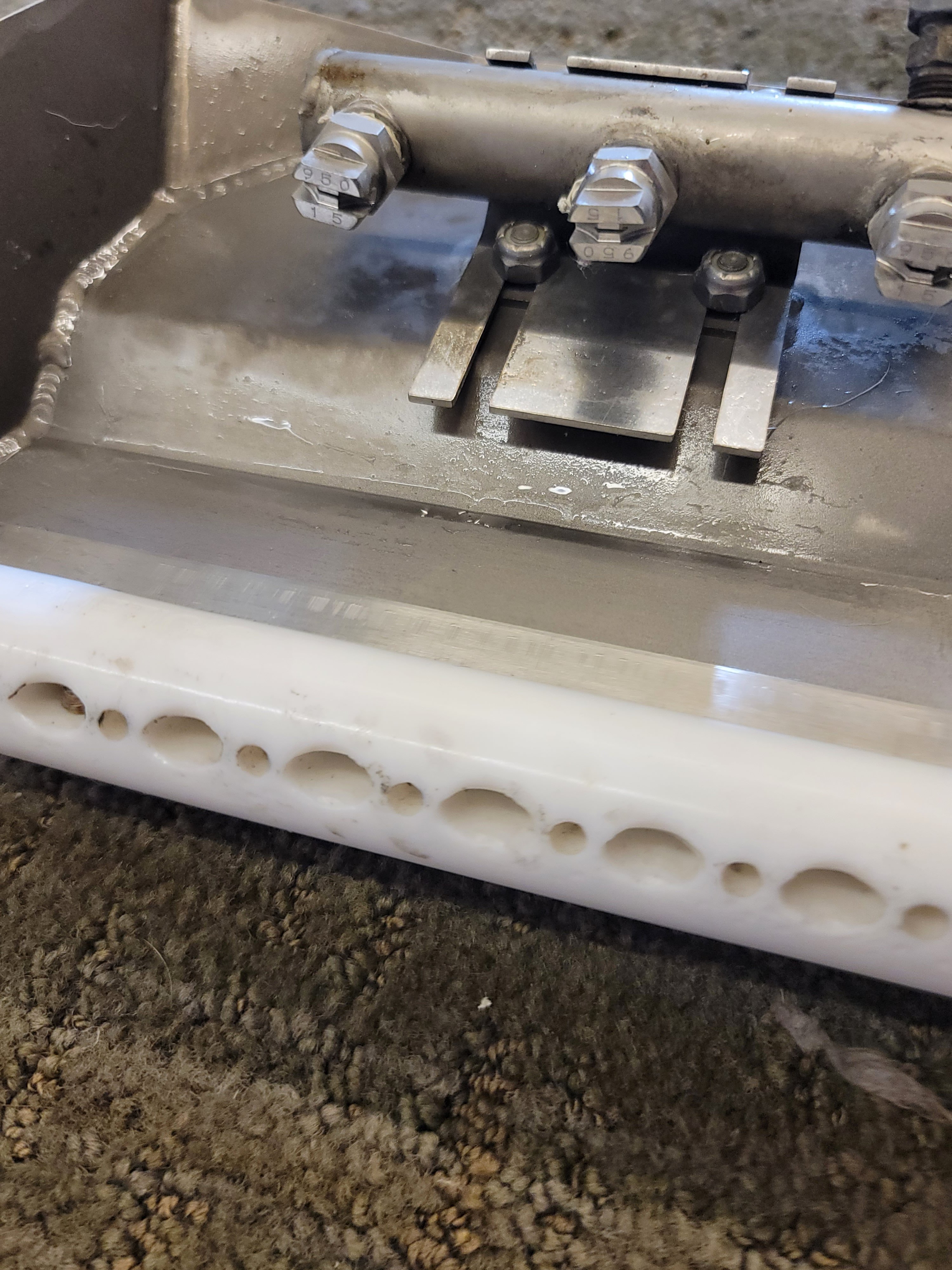

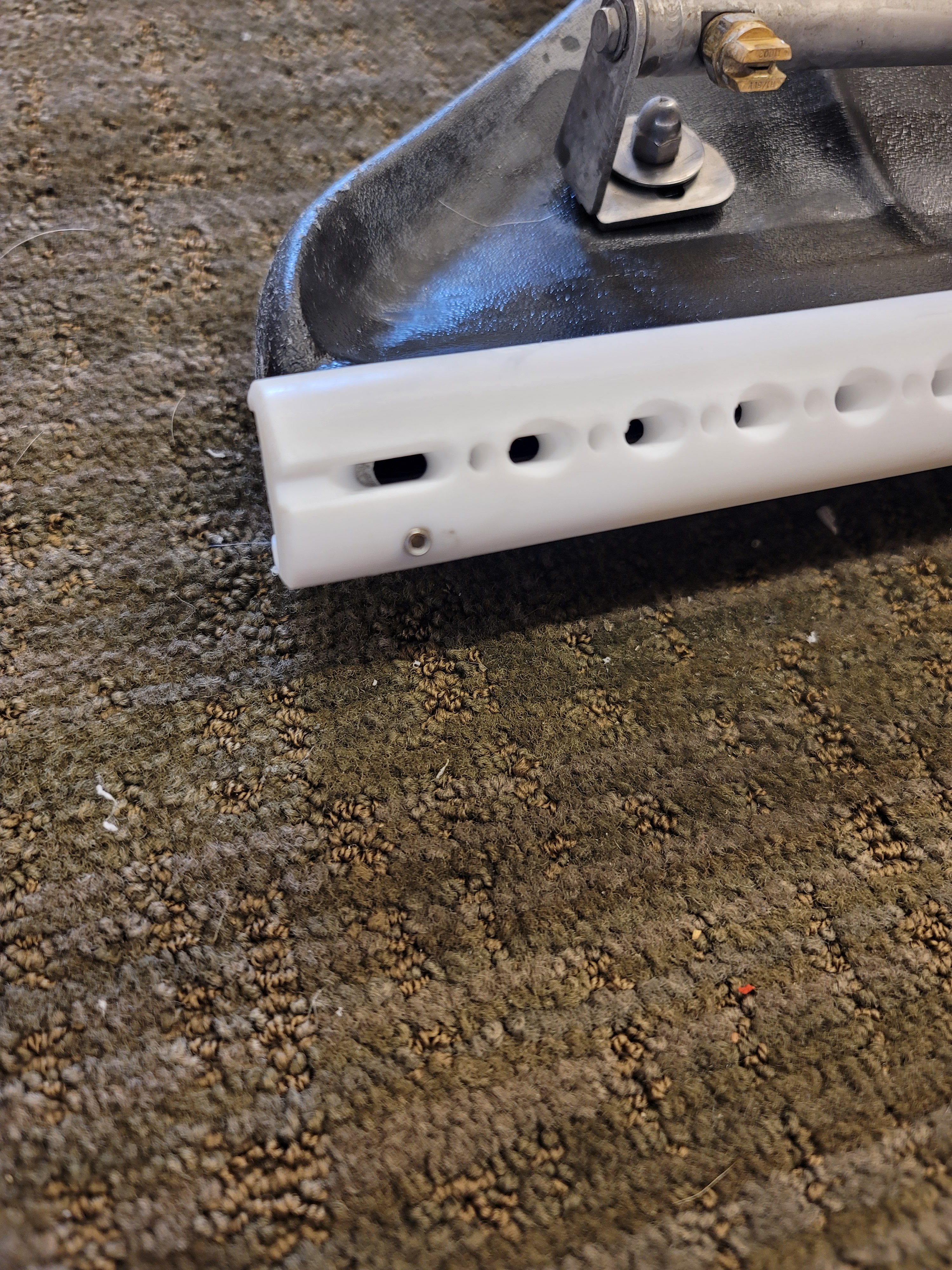

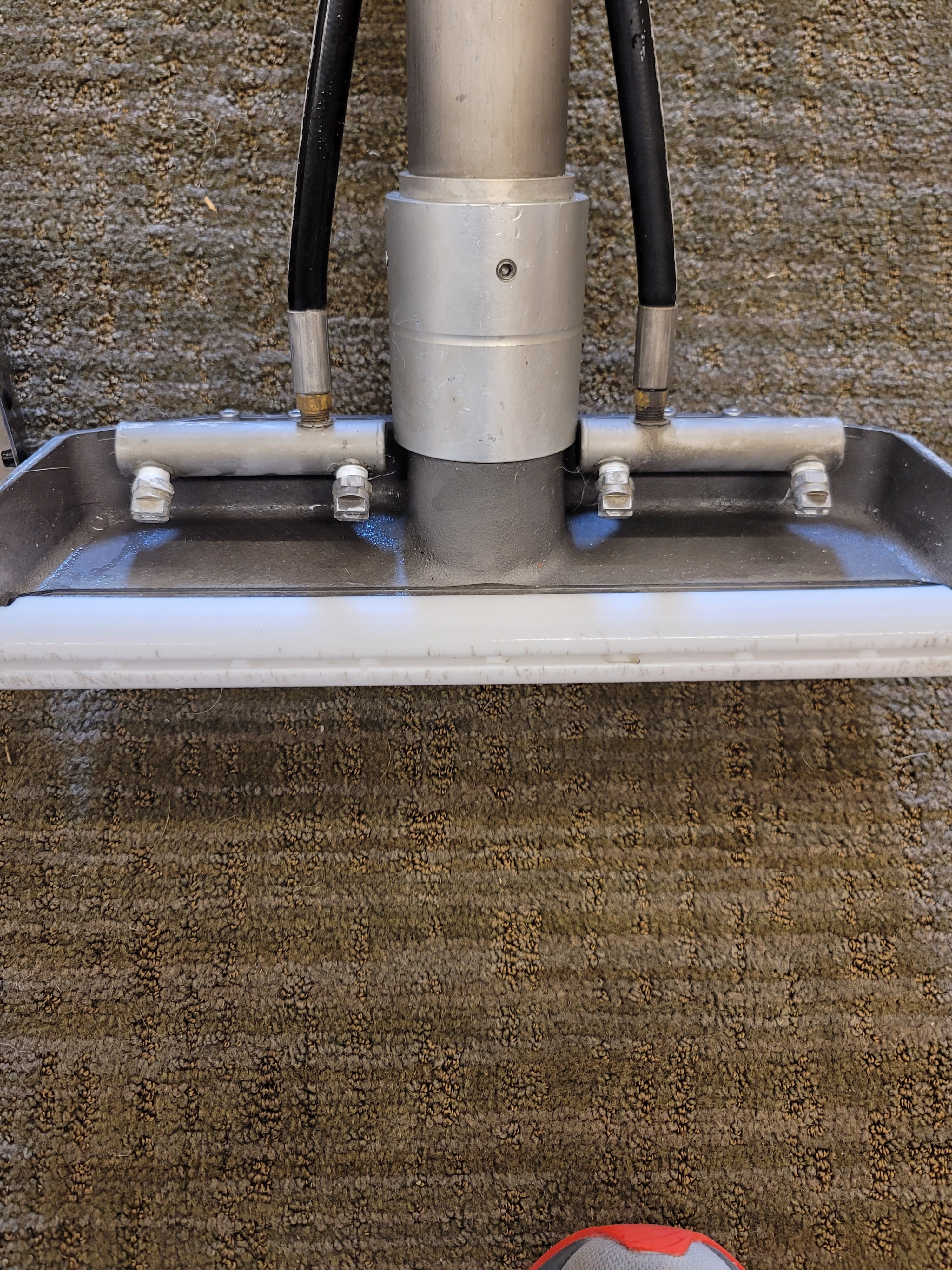

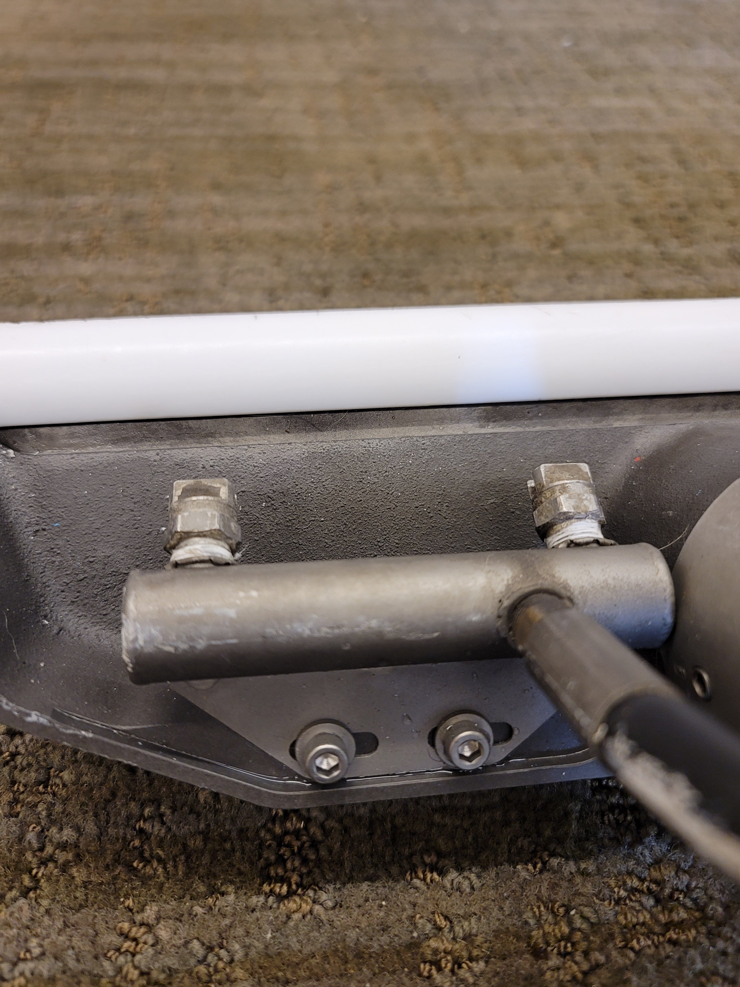

I bought this wand a while back used and I'm not sure if any adjustments other than the glide have been made to it our not. The jets appear to hit the glide and that doesn't seem correct to me. My PMf Mach 15 clears the glide with ease, but maybe that positioning isn't correct either because I purchased that used. @Mikey P
The first 2 pics will be of my Dev wand and the last 2 of my PMF.
117,254
Bend the hangers..
You want the spray to hit just behind the Glide and 5% or so may hit the Glide because the spray isn't flat but if it's striking the back of the Glide either they got bent and hit or said manufacturer isn't paying attention

Bend the hangers..

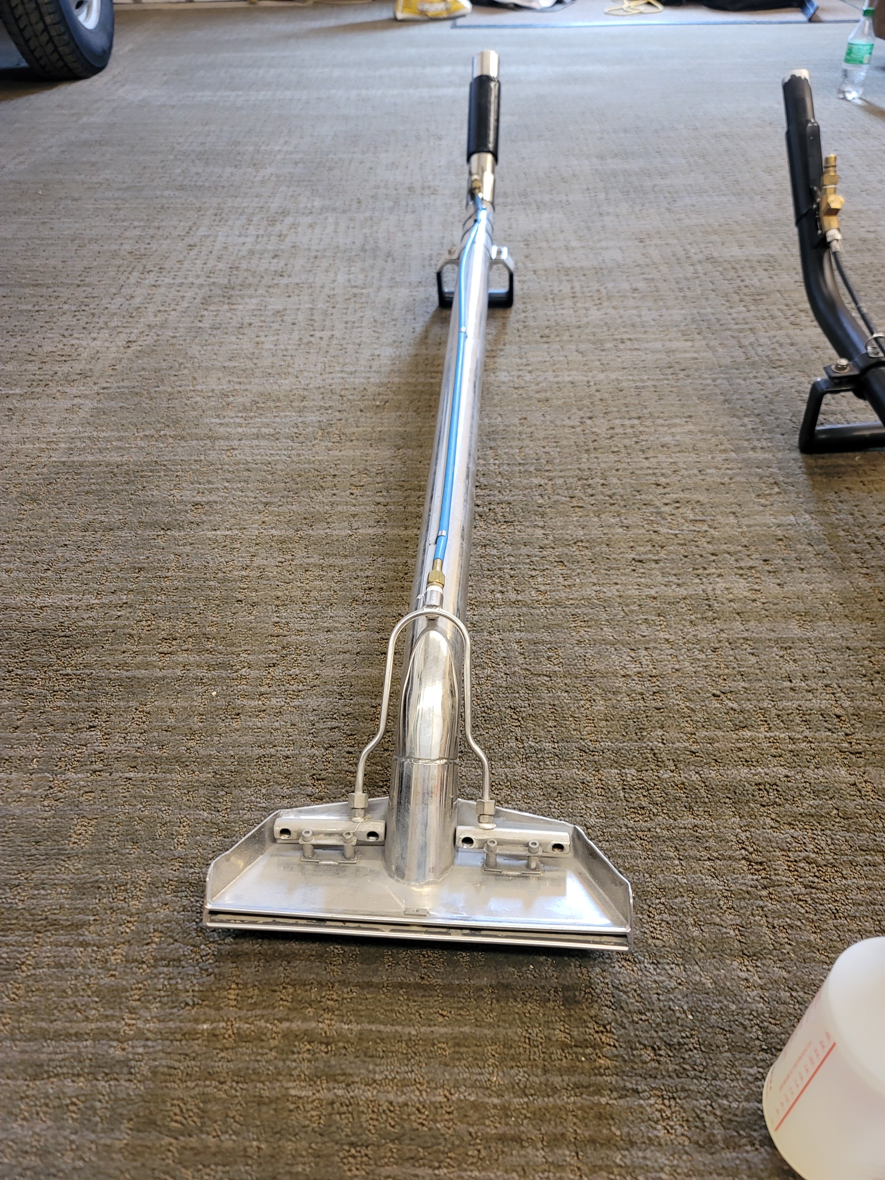

Roger that. And last question. Do you make a Glide for whatever the hell wand this is?
That looks like a Westpak wand. I have one. It was useless without a glide but turned into a wonderful wand with a Greenglide. One of my first glided wands. Why I like it, the tube is 1-7/8 inches flared to 2 inches. Let's you grip it more easily.

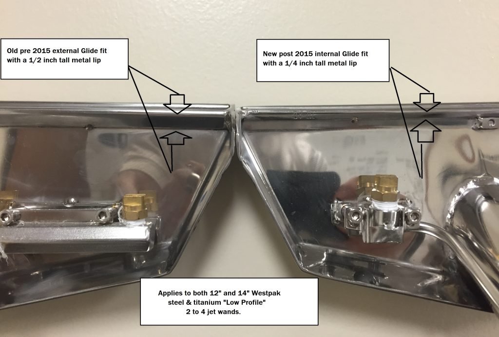

After 2015 we switched to internal fits, which I know you love
