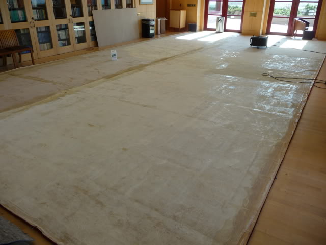

Spent a good part of today applying another coat of latex and getting the new Durabond ready for laying tomorrow.
This thing is as stiff as Cu's next job..

Trowel or scrap of low-nap carpet is the way to go because you need to press the adhesive through the existing scrim and get get it into good contact with the tufts. At the same time, you don't want to put it on too thick, or press it so hard that it seeps through to the face. Good for you for taking this on, they will now consider you their very own expert and work at that facility won't go to the lowest bidder. The rug will also be easier to clean now that it has a little more body.

Snow Job knows I was kidding you even bigger dork.
and yes, rollers would not have gotten the glue in deep enough.
I only hope when the 4 of us go to flip it tomorrow it's not stuck to the floor.
