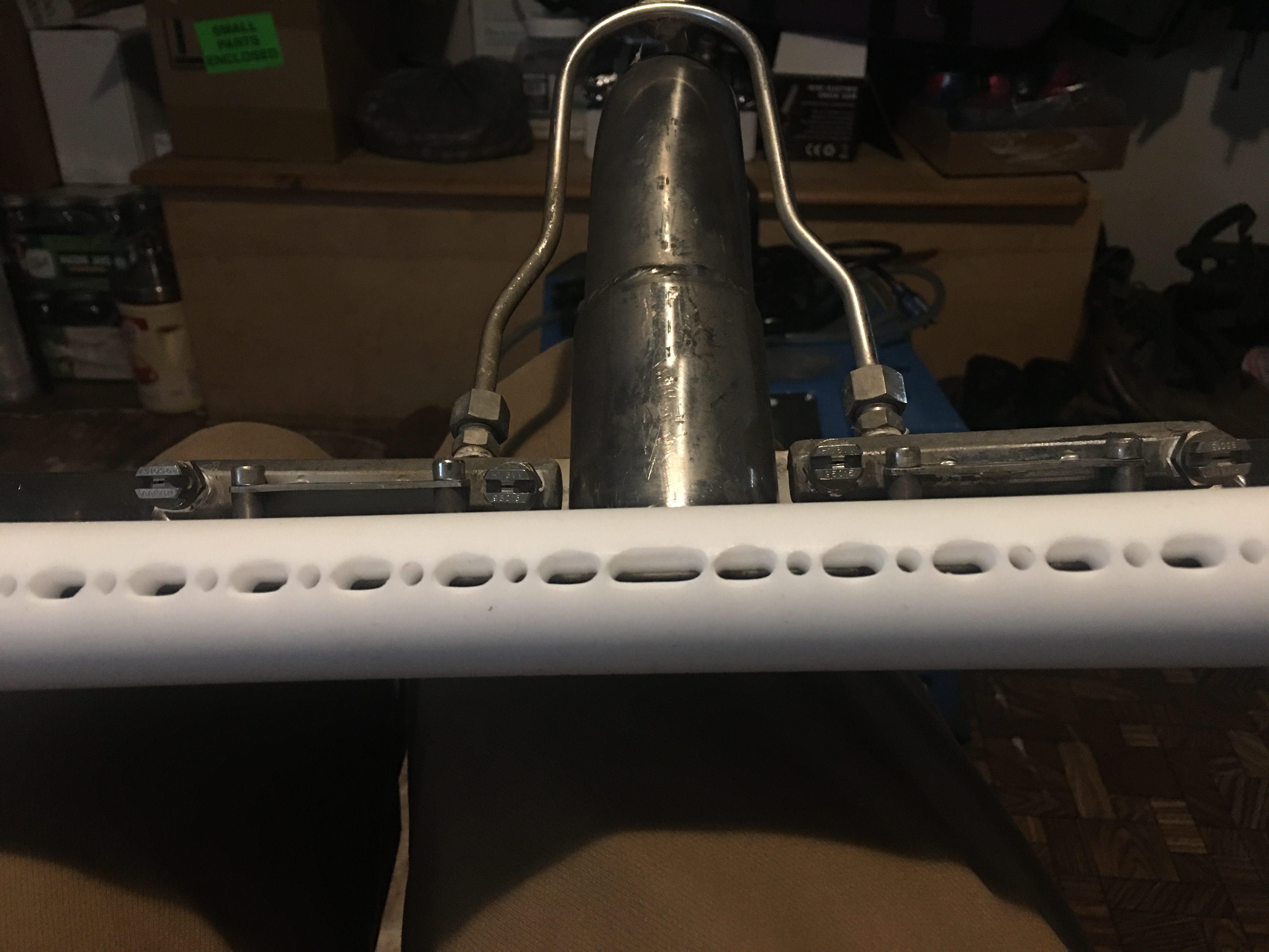

Is westpak the only wand that does this?
14,109
Stagger their jets so we don’t have to angle the spray.
Looks like the “other” wand companies are kinda lazy because my PR TI and other pmf wands never had this
12,576
I believe at one time the original Prochem company did that, though it could have been our original service manager would do it before we installed a machine.
Back in the late 80s Prochem made a single jet wand that would shriek when the vacuum was engaged. We had to “tune” it by taking a screw driver and bending the vac opening a bit to quiet it.

14,109
Butler stagger sthem much more

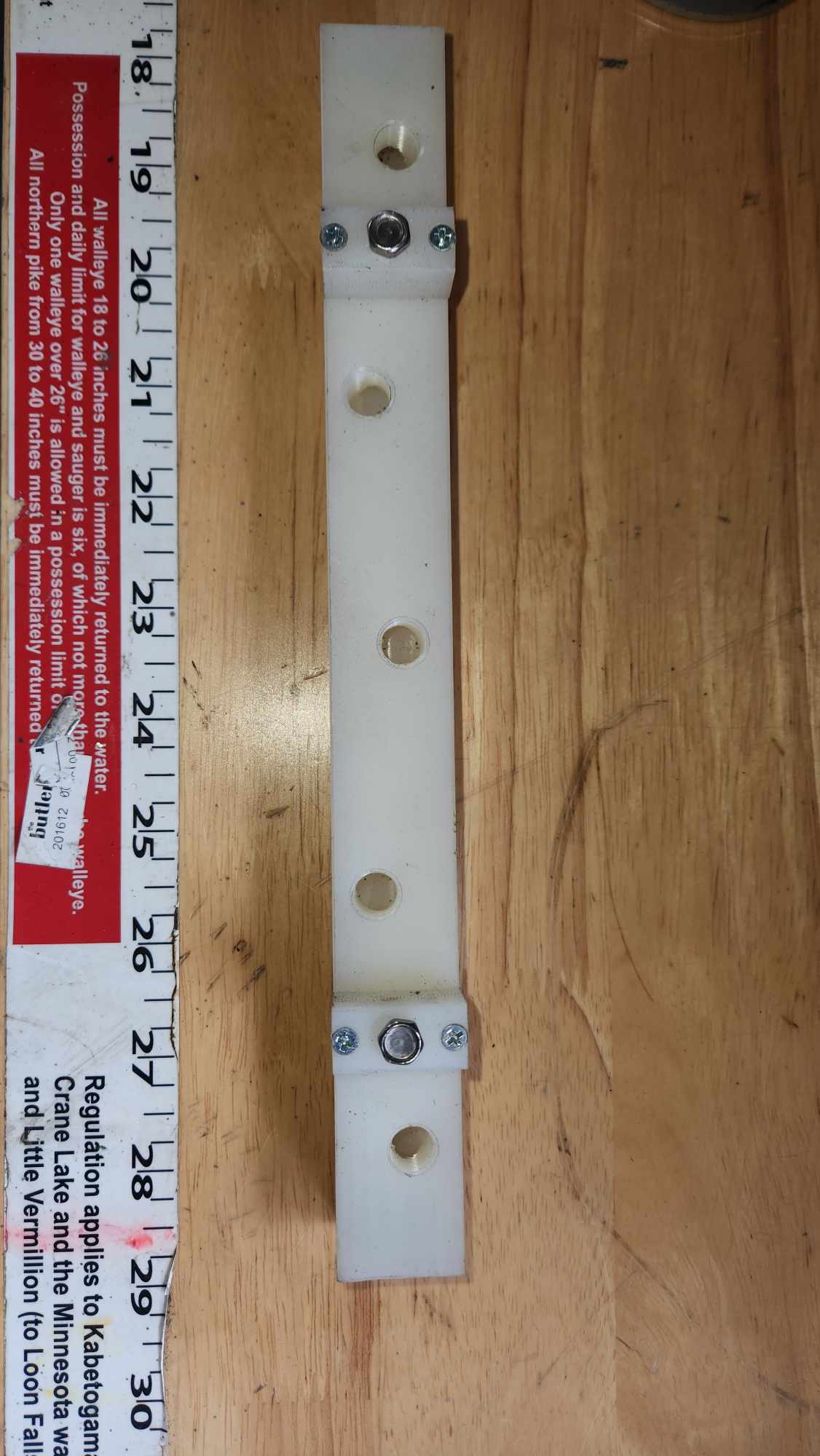

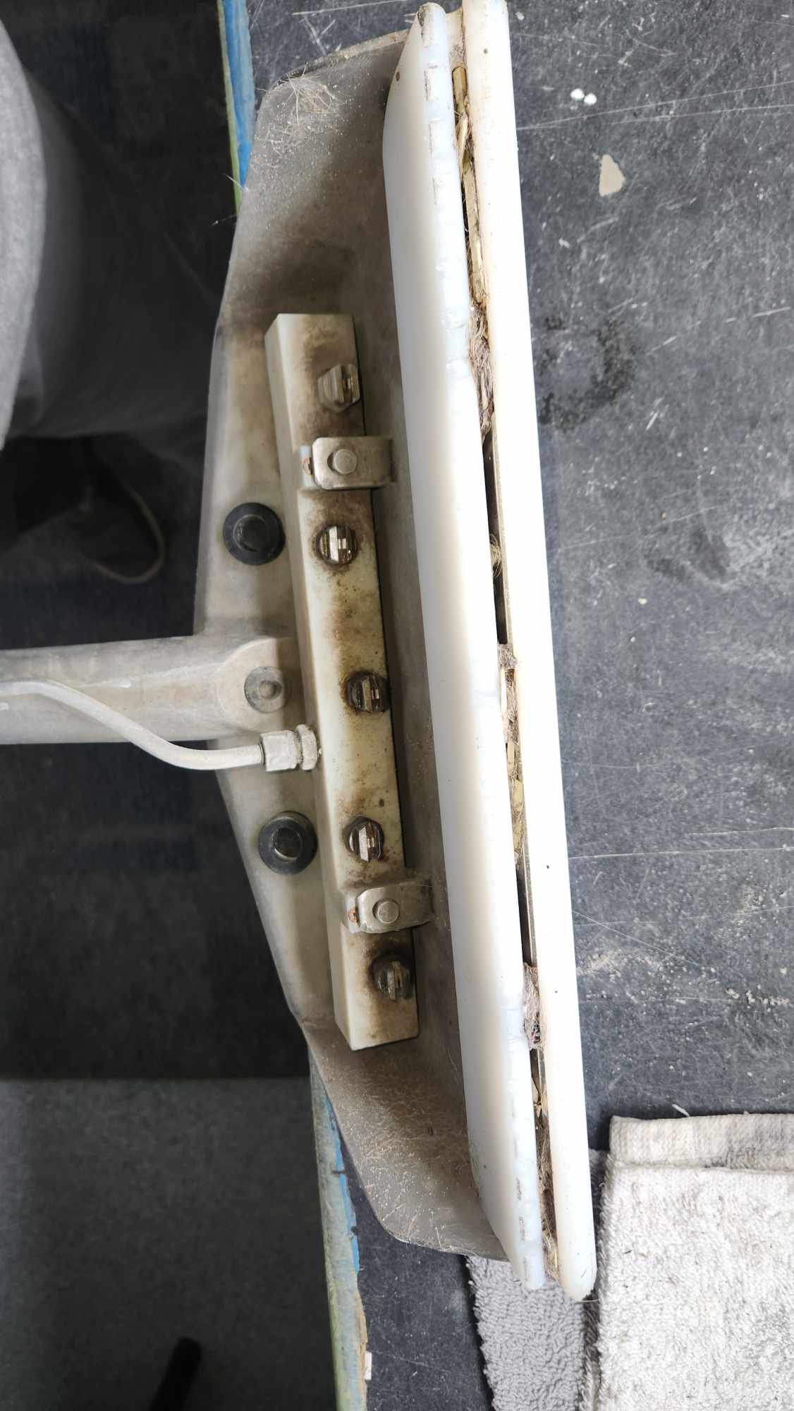

14,109
Yes PMF makes them.
They are not open to feed back, and due to costs and function, for every PMF wand I move, I sell 20+ Westpaks
Do me a favor time yourself cleaning 200 ft of open space with that 4 jet and then do 200 ft with the 530 at the same moving pace and let me know what the difference is time
For these 11’x12’ rooms, there was a 2min loss in time with the 11” vs the 14”
14,109
Any visual or dry time differences of note?
Cleaned at a pressure of 500-550 and never got a difference in dry time. I think the 4jet might’ve cleaned a little better
Both wands are set at 6flow. 1.5 jets on 4 jet and 3flow jets on 2jet
I noticed some dark lines from the 2jet wand but it might’ve been just wet lines
