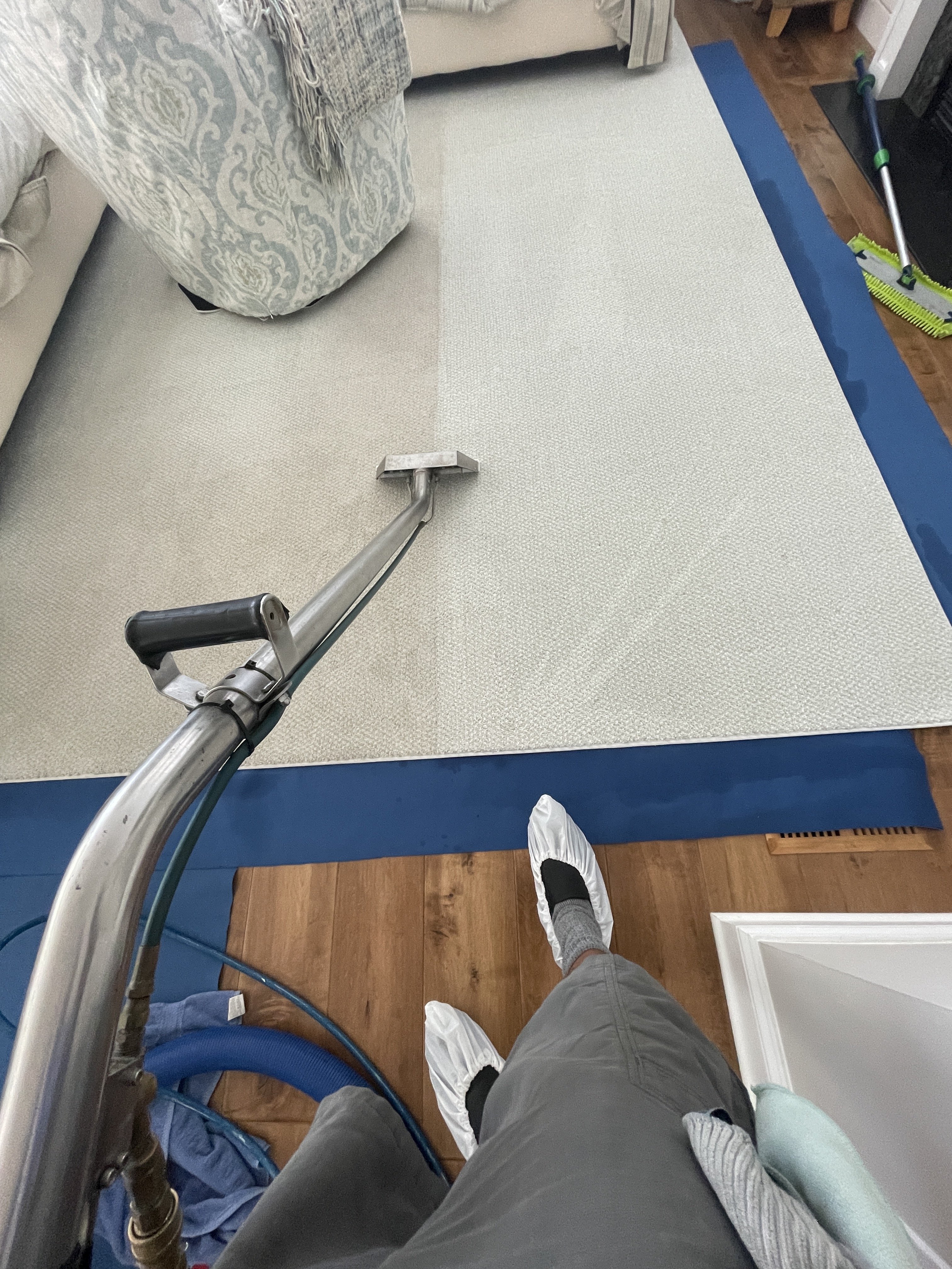

It just does. Remember, 86% of soil is dry particulate removed by vacuuming. Now that vacuuming is super key. Its not a freebee, you need to wash pads, other 14%.
The machine is not a "175" which I never ran anyway, but most uneducated people think it is. The actions of this Trinity Odyssey are spectacular when it comes to agitation, which I dont get when I straight up HWE.
So definatley through agitation gets it clean. And the way I set it up Pre Vac is impressive if I do say so myself. Results speak for themselves.
For the record, I still HWE and always will if im in this business. For jobs like this
I should have post padded with the Odyssey to tell you the truth, but getting 5 other rug add ons and a 15 bench cushion, I tapped out. If it browns, I get to use the Odyssey and it will fix another brown out job. Browning fixer is another miracle worker this bad ass machine is.
