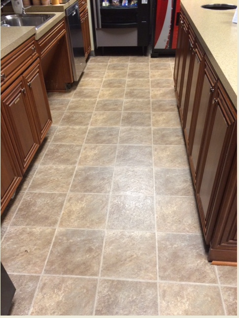

Attached please find a photo of the first floor pantry flooring. XXXX was just looking to have it cleaned and shined. It's very filmy looking.
If someone is in the area and wants to take a look, just let me know. I can do a tour.
Thank you!
Looks like linoleum to me....so maybe we will just clean and then load it up with mop 'n glo.....Just kidding.
115,964
Ya see?
Low rent sheet vinyl.
Mop down some stripper just in case it's been topical'd, scrub with a new red pad and wand rinse.
Do not recoat.
Sell them a gallon of neutral ph, no rinse and a flat mop

John stopped by today. Looks like the haze is a build up of product they are using to clean it. Once we remove that, the floor may have the "finish" he wants. That is how we are moving forward at this time. If it doesn't, then we will present him with options and the cost for us to maintain the floors for him so the shine stays.

customer is always right, if they want a shiny floor, give them a shiny floor. Whatever finish you use on vct, will work on lineoleum. Just means from now on, it will need to be maintained like vct. Strip, seal and wax on a no wax floor.
